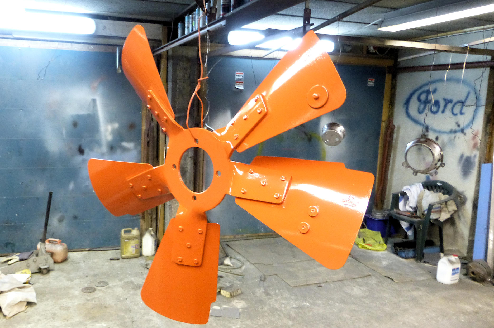

....then some heavy coats with good old fashion acrylic paint. So far I think I have had about 120 different parts painted black, then there are parts painted cast iron gray and then some to be painted other colors like the cooling fan, air cleaner and valve covers.
After a week of painting black parts it is nice to do a different color![Lächeln :)](./images/smilies/icon_e_smile.gif)

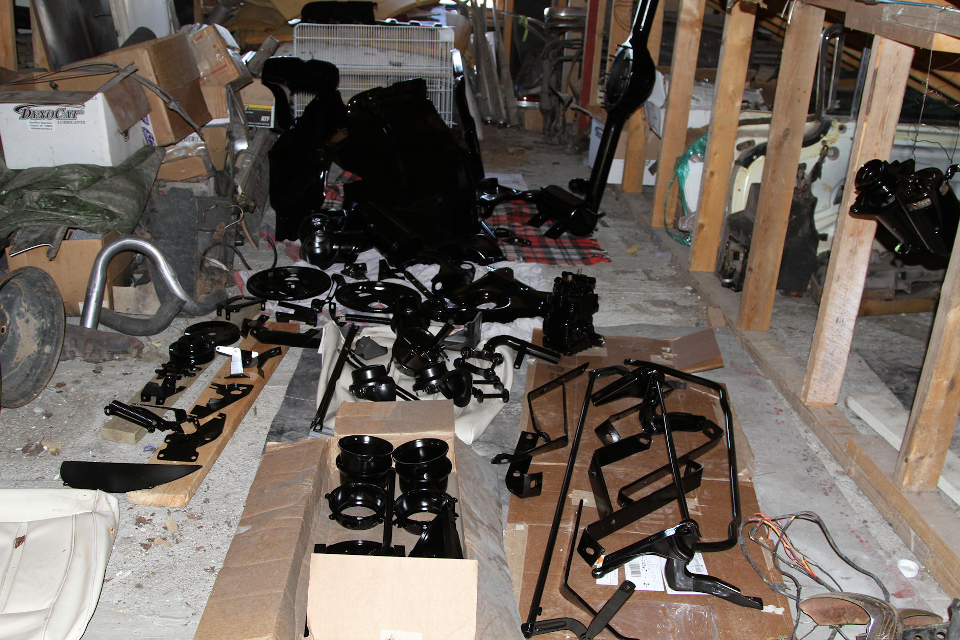

Here are most of the fresh repainted parts up on my garage loft resting and curing while I am working on other things.
