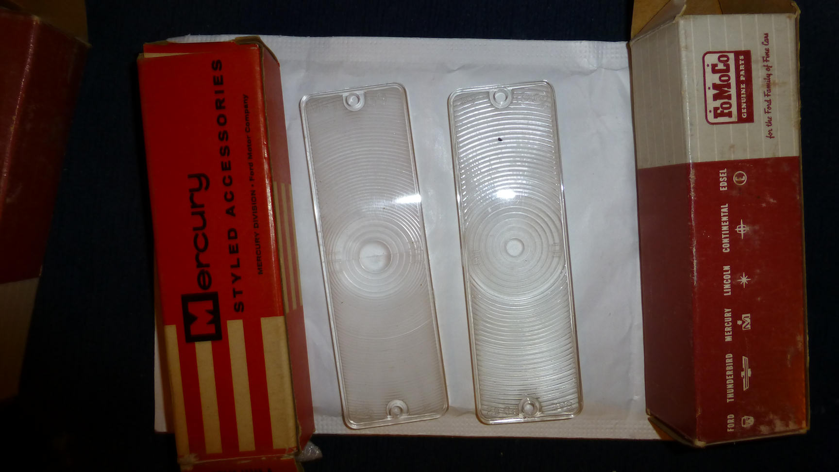

Regarding the parking light lens, are you aware of that there are 2 versions, the one with 59 marking and the later with 62 marking on the lens. Those with 59 on them are getting pretty hard to find, but I might have a set I can let go. (I just need to check that I have a set for my car first) I also have one extra set of the 62 version if you prefer them.
59 lens to the left, 62 lens to the right.

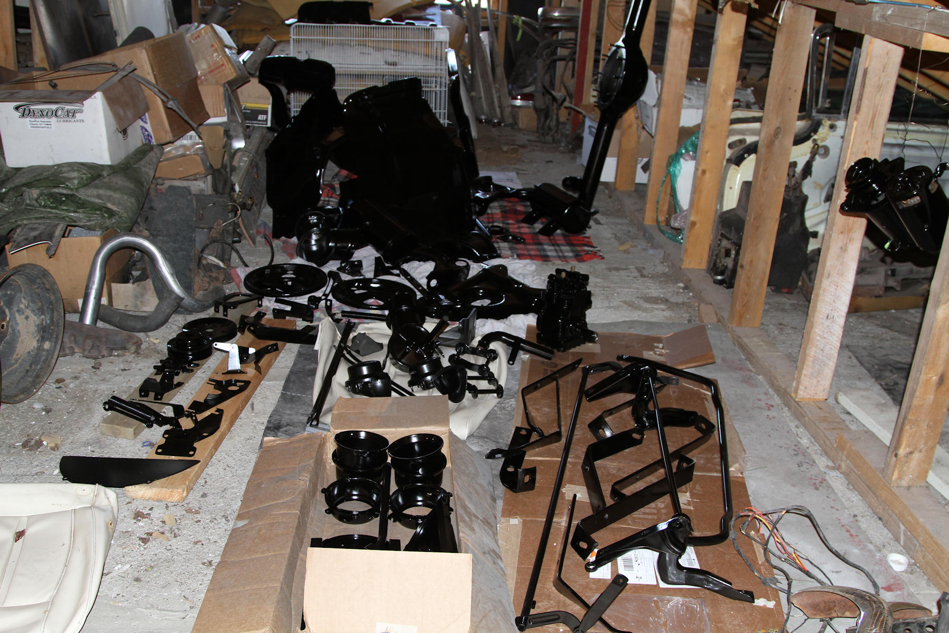

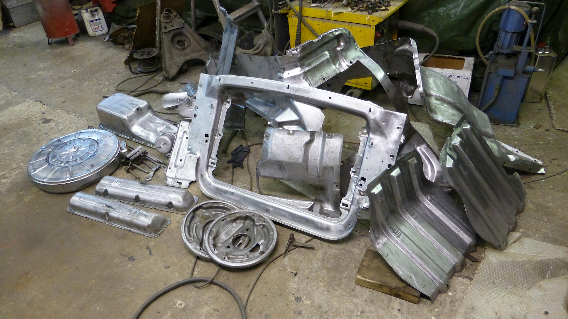

I've been doing a lot of boring dirty work this week, so the pile of parts ready for paint is growing every day. Here are the inner fenders, radiator support, battery tray and a lot of other parts for the front of the car stripped from undercoating, old paint and surface rust.

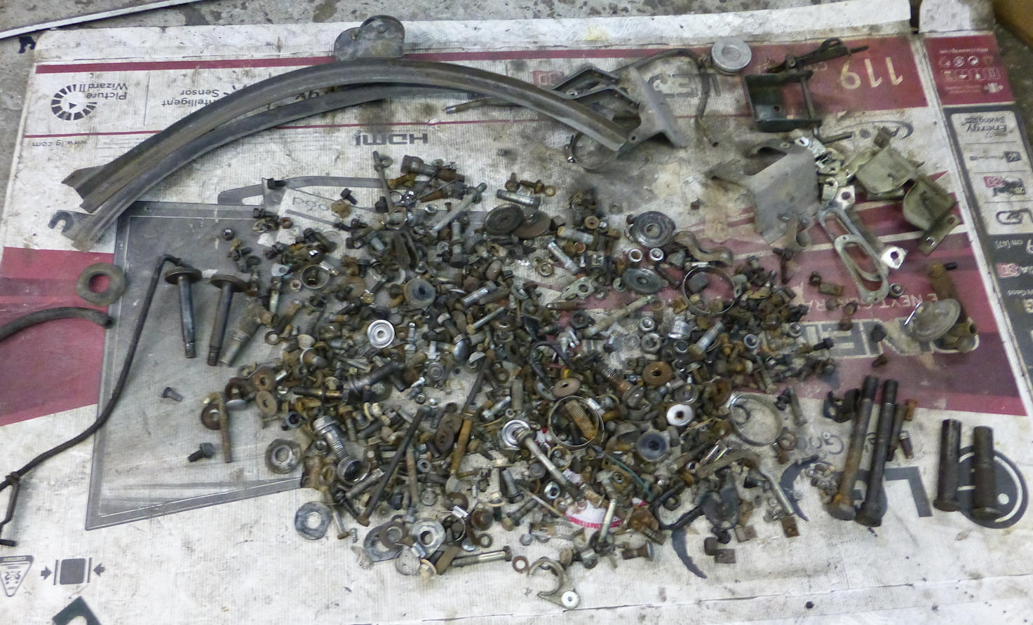

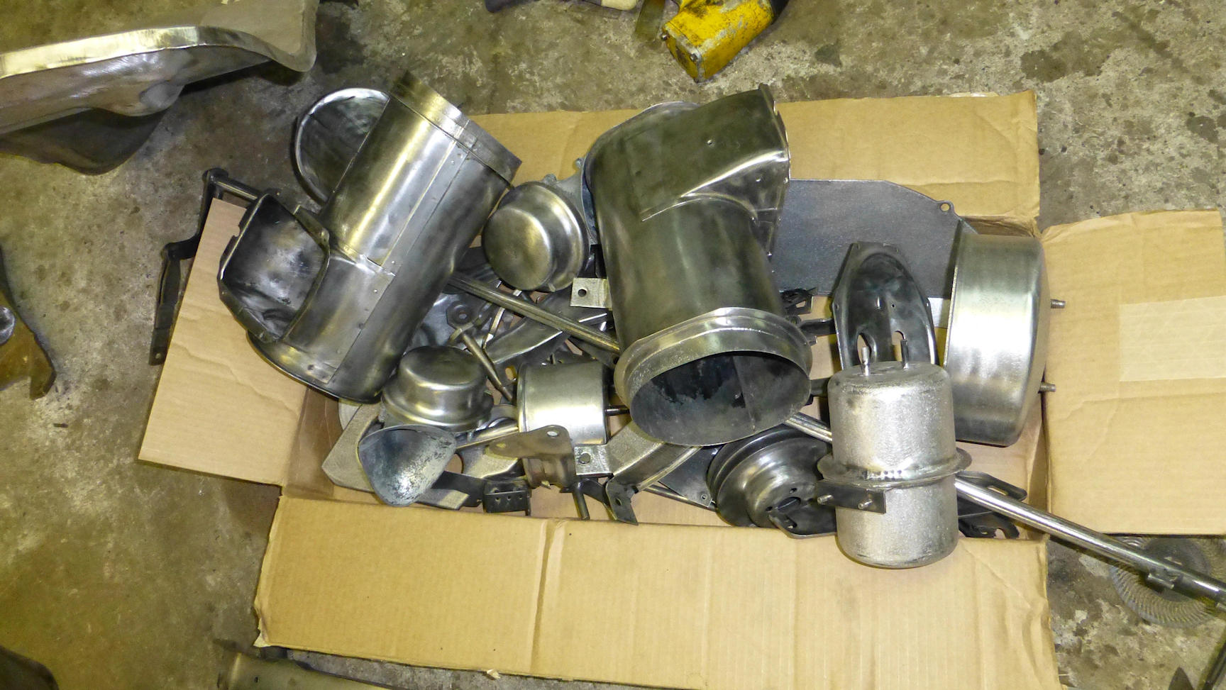

Then I have a ton of old bolts, nuts, clips, brackets and all the other parts from my car that were electro plated originally and that needs to be restored. They were sorted into what used to be silver, gold and black, and on Monday I will ship these to a company that used to plate all the bolts and such for Saab and they will make these look like new.

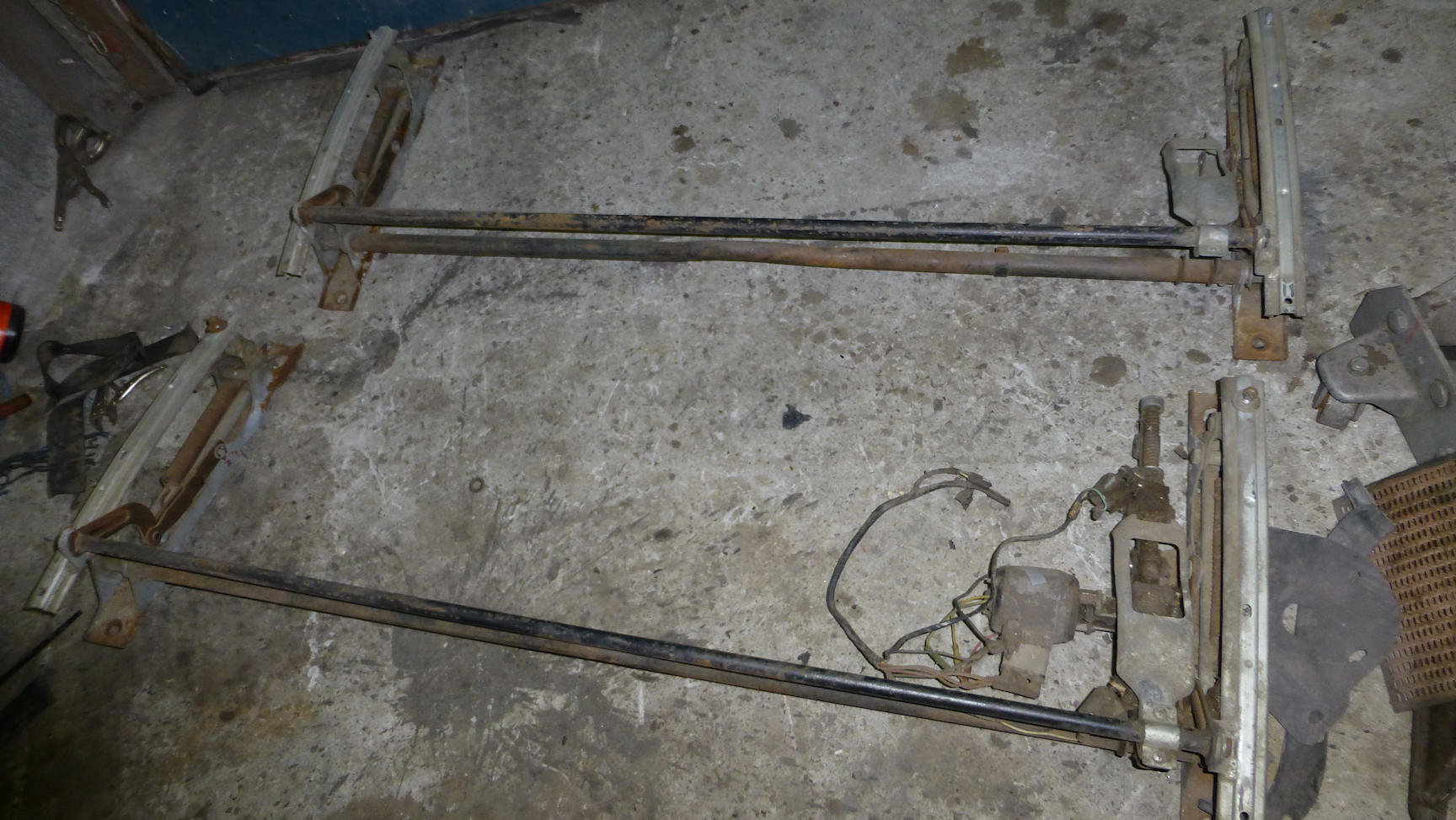

I also had to take apart the power seat mechanism so the seat tracks can be restored at the same time. Originally I planned to use a memory seat from a 59 that I restored a few years ago, but the problem is that the memory seat wasn't on the option list for 60 so there is no matching switch bezel available for the 60 Mercury dash. So I will install a regular 4 way power seat, just like it would have been from the factory.
Yes, there are two power seats in the picture. I decided to take both apart and then pick the best parts to make the best one possible.

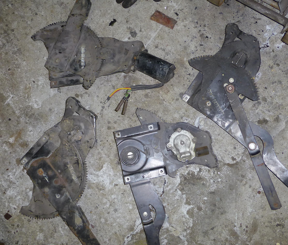

I have also pulled my power window set up down from the garage loft to inspect what I have and to take off the plated parts that needs to be restored. Otherwise these seems to be in really good condition and they should be easy to restore back to new condition.

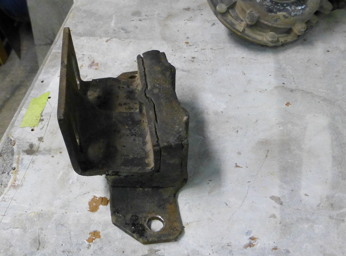

Finally I have one part that bothers me and that is the old transmission mount. I have not been able to locate a NOS one, and there is no reproduction on the market. I guess I need to find someone who can restore it, but so far I have not found someone here that can do it. Any advice is welcome.
On the transmission mount, I would check with Dale in Oregon. He has been rebuilding harmonic balancers for 35 years, including other rubber and silicone castings. I have used him many times and trust his work which is backed up by a lifetime warranty. He should be able to tell you who can rebuild the transmission mount if he cannot do it himself.

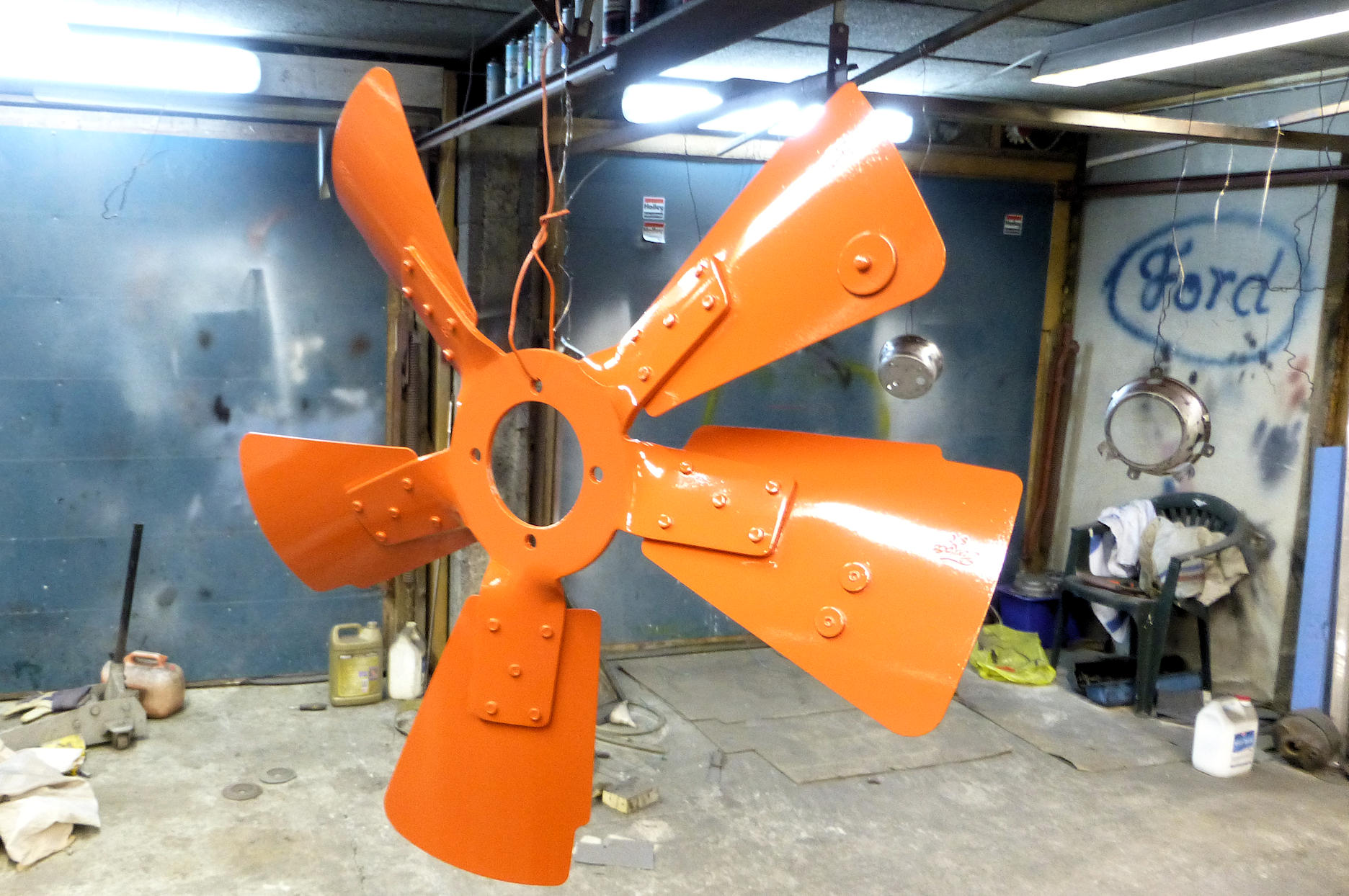

I guess it's time for some updates on the progress now. I have spent a lot of time cleaning all the parts that needed to be painted semi gloss black.
Then I have painted all the parts, first a layer of epoxy primer....
....then some heavy coats with good old fashion acrylic paint. So far I think I have had about 120 different parts painted black, then there are parts painted cast iron gray and then some to be painted other colors like the cooling fan, air cleaner and valve covers.
After a week of painting black parts it is nice to do a different color

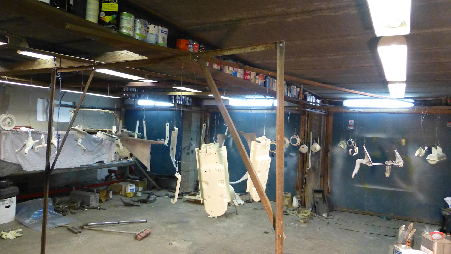

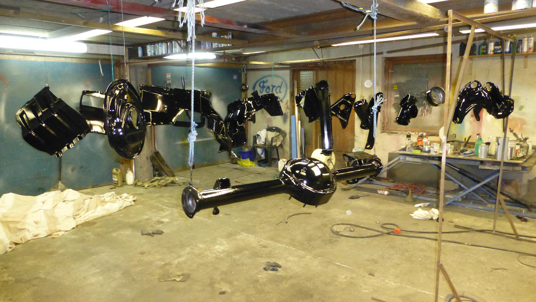

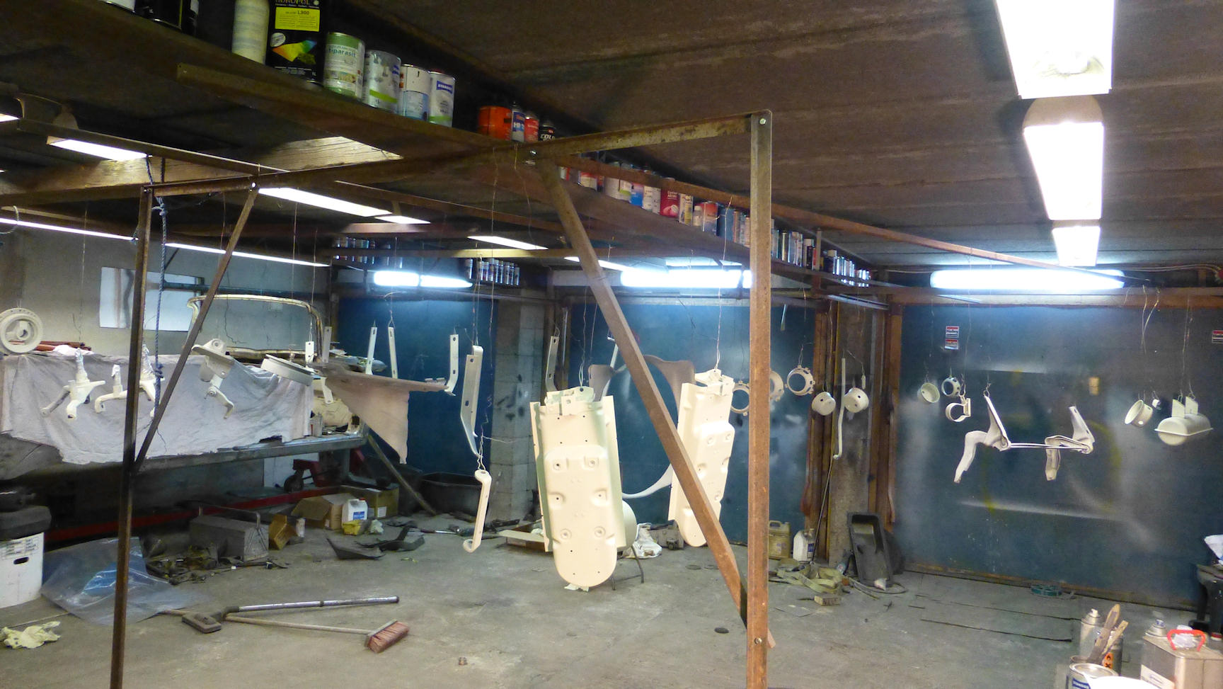

Here are most of the fresh repainted parts up on my garage loft resting and curing while I am working on other things.

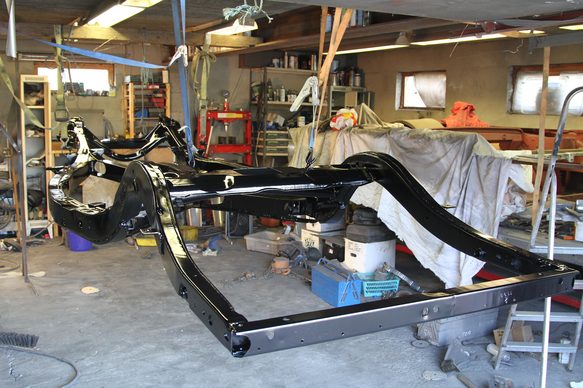

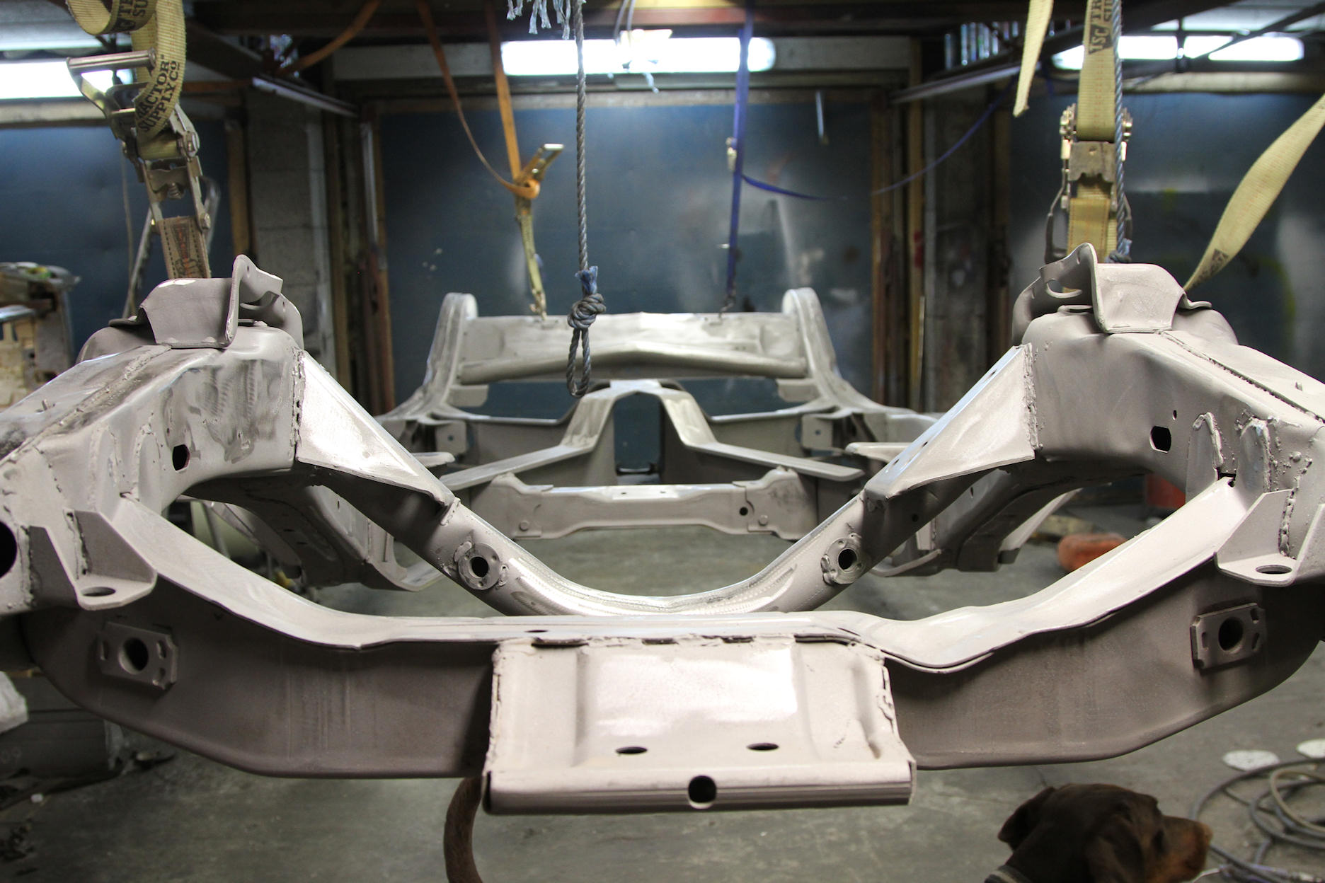

1960 Mercury Park Lane convertible frame

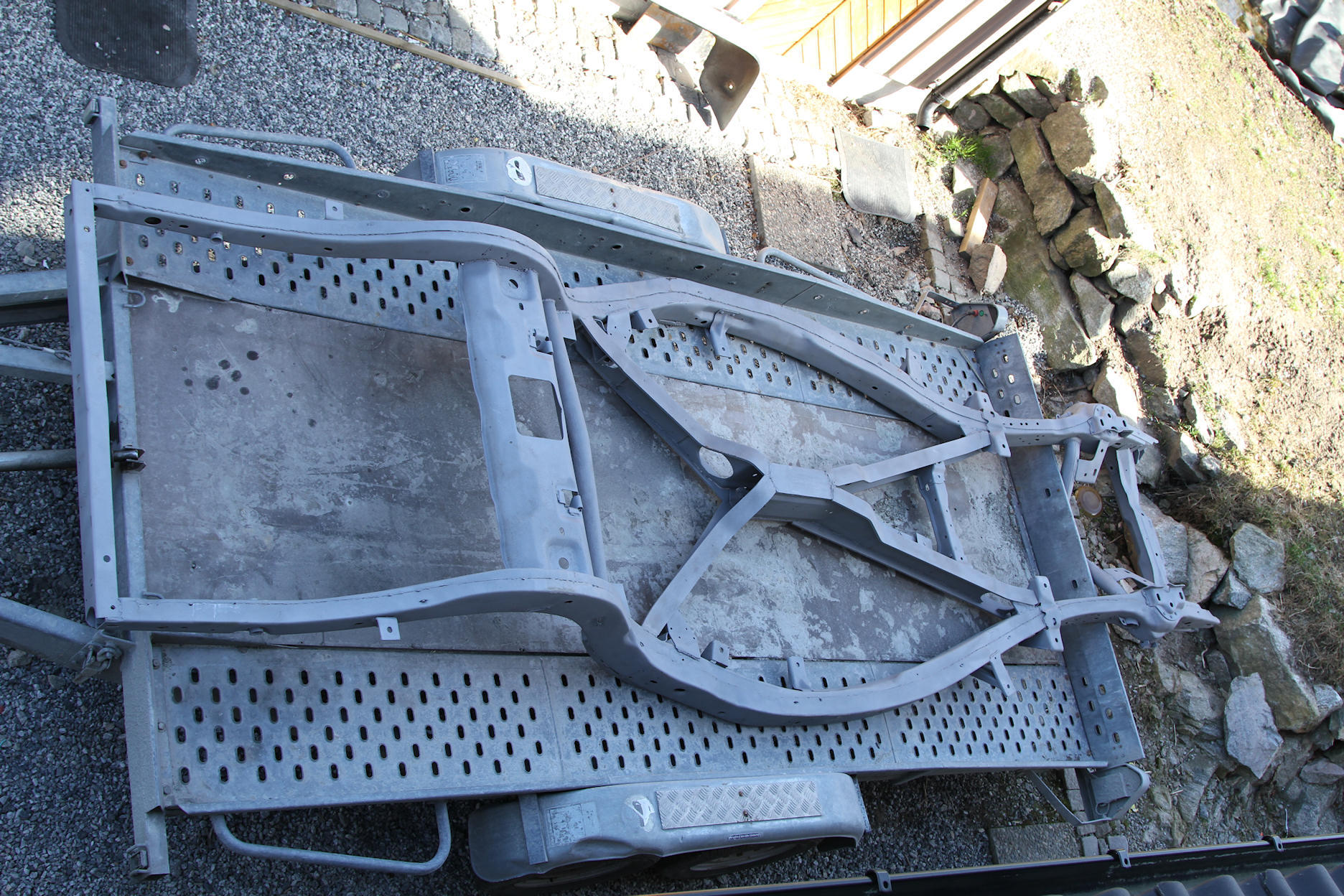

It sure took a long time to get the frame back from the sand blaster guy, but in a way it was good to not have it here for a while as my space is very limited. Anyway, this is how it looked when I got it back home.

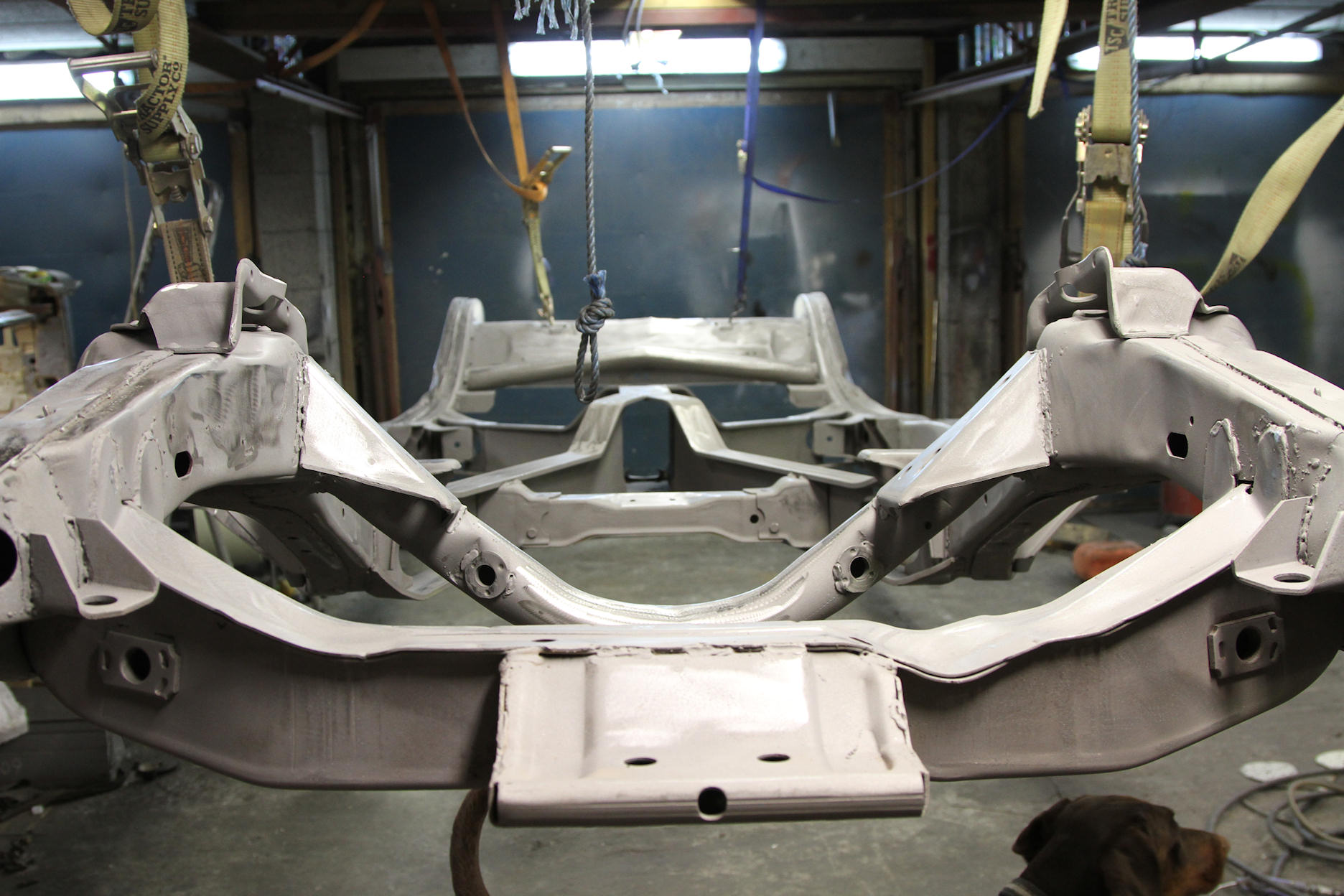

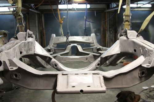

So I hung it up in my garage and started the paint prep work. The whole frame needed to be sanded to make the surface smooth and nice and I also used a little bondo here and there to remove signs of previous surface rust.
Then again, Epoxy primer on everything to prevent future rust.

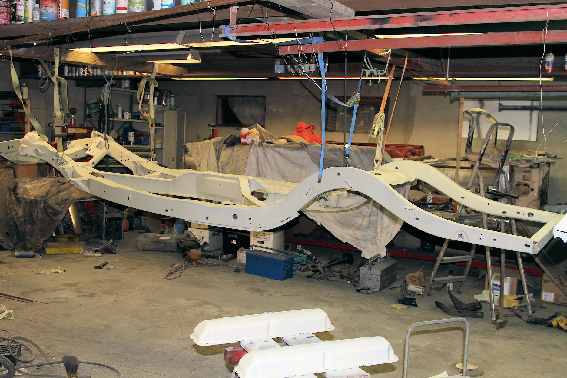

And here it is done It sure looks nice now or what?
It looks like new! I absolutely love the attention to every detail.
