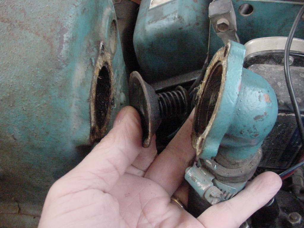

Here's one of those pesky pressure regulator valves.
Here is the thread with lots of photos http://www.network54.com/Forum/424840/message/1164411296/
Here is another photo of a pressure regulator valve, just to show the kind of crud that can collect on one of these all brass devices. Same thing can happen to the t-stat, and since they slide in a housing that is more controlled than this, it's quite possible it could be stuck or clogged somehow with debris. One way to tell, pop it off and take a look! (A lot easier said than done)
