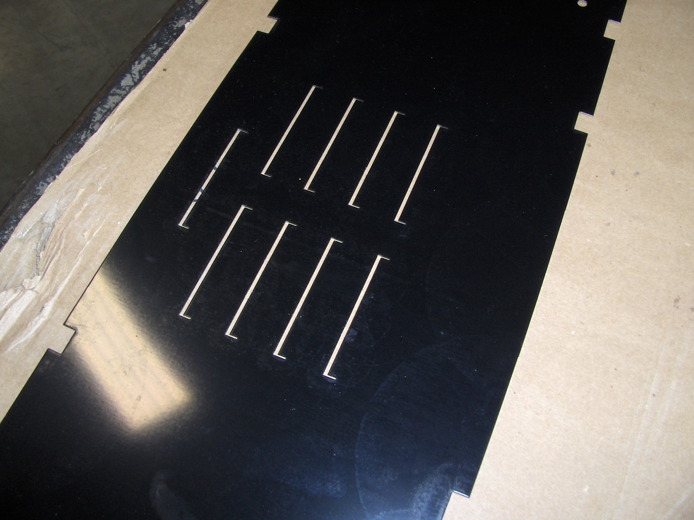

OK this is the final design on the flat......
...............with louvers punched.
