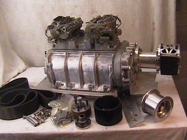

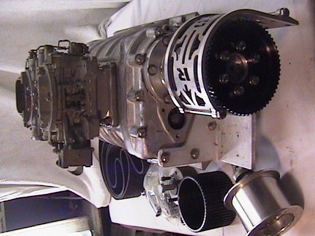

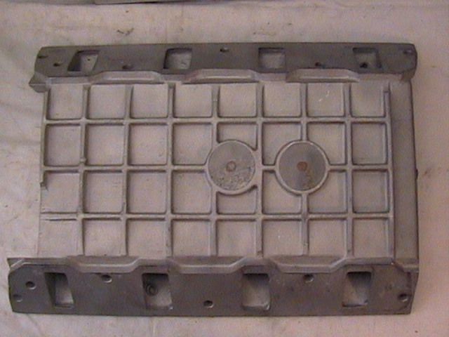

Here is a blower set up for an MEL from a listing on ebay..
Blower assembly MEL
blower intake
blower underside MEL
Posts: 238
Location: Ontario Canada
Re: Supercharger setups

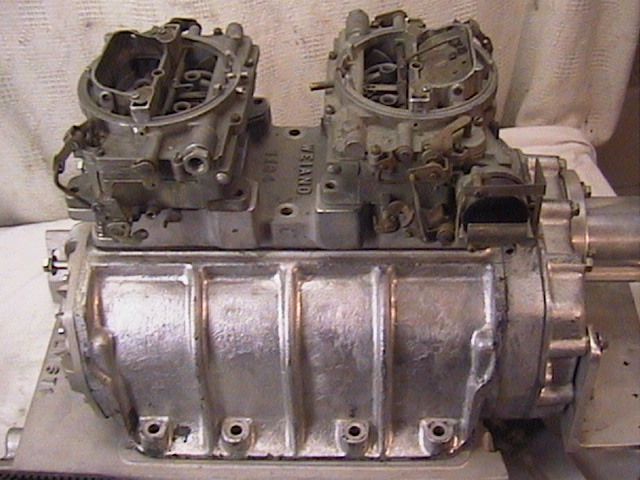

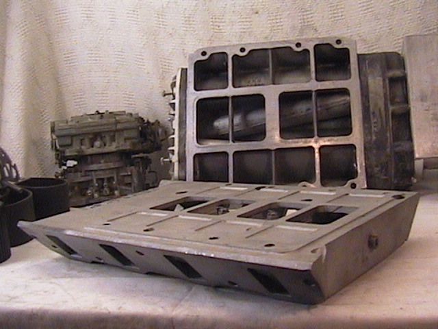

Post by Chris Craft crazy » Mon 26. Dec 2011, 13:15
The buy it now on this set up was 2000 dollars... it needed some work, but a reasonable price for a rare item
MEL Weiand blower
MEL weiand blower
Posts: 238
Post by Chris Craft crazy » Mon 26. Dec 2011, 13:18
MEL Weiand blower
Edited to add: This setup is the only one I have seen, and it sold within one day at the buy it now price of $2000.00
The Intake is the rarity of course.

Ahhhhhhh, now that's what dreams are made of...as far as MEL speed parts go $2000 is a pretty awesome deal for everything you'd be getting. If I had that money lying around when that listing popped up I would have pounced myself.
On a side note, I've never seen a setup w/o the aircleaner on it and it's interesting to see the carbs reversed. Makes a little sense now that I see it

The fun thing with those manifolds is the distribtor is covered by the intake.
Have to run a dummy for oil pump function and a belt or cam driven unit for ignition.

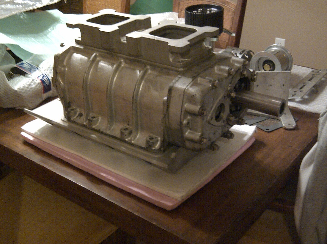

Post by 64Sedan » Sun 25. Mar 2012, 20:00
Chris Craft crazy wrote:
The attachment blower2.jpg is no longer available
That looks very familar.. 8-)
