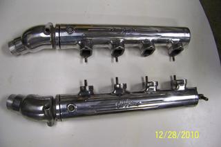

Post by Chris Craft crazy » Fri 31. Dec 2010, 11:44
A picture of my edelbrock manifolds with the first polish on them. These now have Glenwood marine elbows on the ends, note the cooling water exhaust ports.
Re: Chris Craft 430ies
Post by Theo » Fri 31. Dec 2010, 11:52
