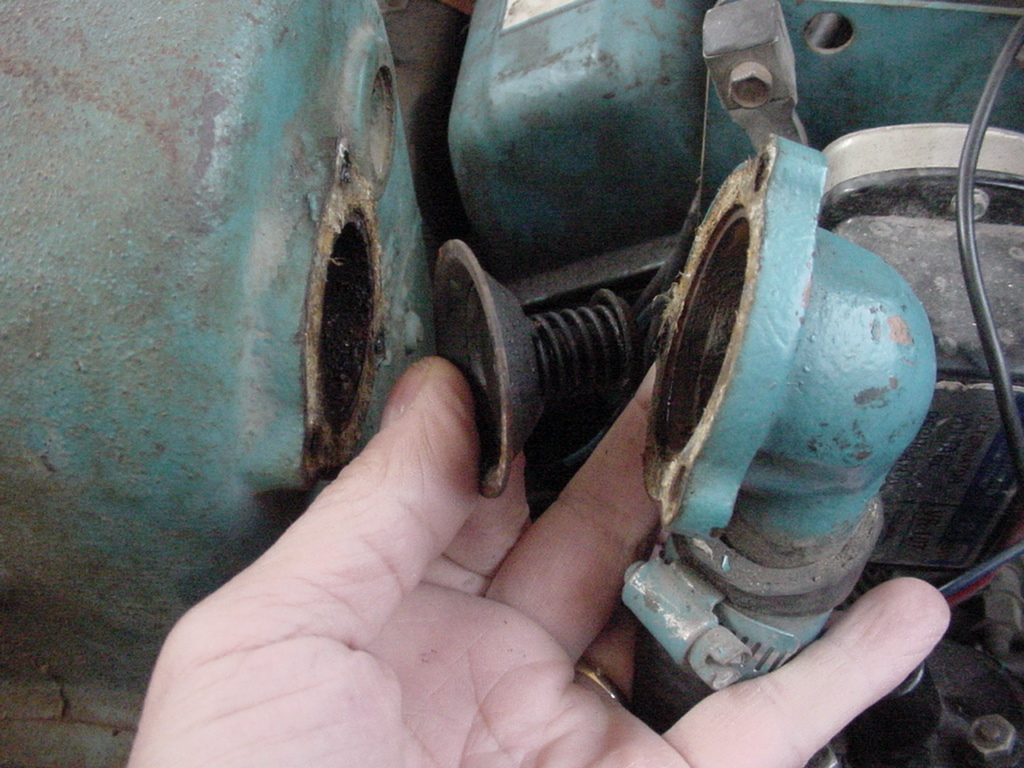

Here is another photo of a pressure regulator valve, just to show the kind of crud that can collect on one of these all brass devices. Same thing can happen to the t-stat, and since they slide in a housing that is more controlled than this, it's quite possible it could be stuck or clogged somehow with debris. One way to tell, pop it off and take a look! (A lot easier said than done)

Corrosion likely to be found on an old t-stat.
The 427 t stats are a part of the circulating pump housing, and they are set into a seal assembly. The seal assembly is not unlike a main seal on a crankshaft, and it's sort of strange to see how these are used in a water based cooling system. The thermostat pulls directly out, leaving the seal, which is replacable.
If you're careful, you can pull the t-stat out and reuse the seal. If you mess up the seal, then you'll have to get a new one from a hydraulic equipment supplier, power transmission vendor, or bearing and seal sales dealership such as Allied Bearing. I believe the correct number is 16020 as manufactured by SKF. I'll try to verify that one.
