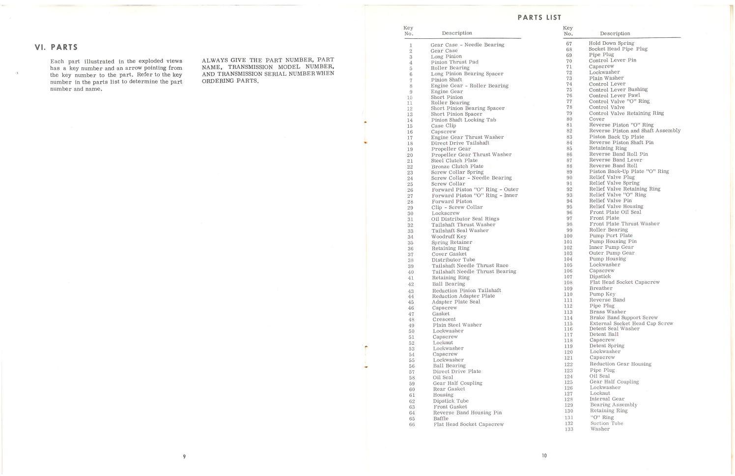

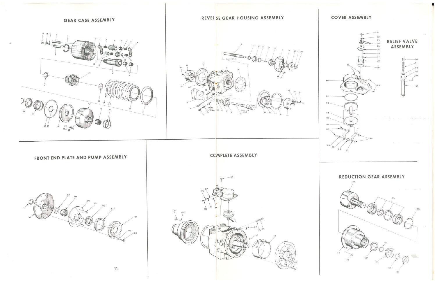

Paragon Hydraulic Transmissions, P 200, P 300, P 400 ( Operator Manual Scans )
June 15 2007 at 1:47 PM
Paul  (no login)
continued on the following page....
Paul
(no login)
Re: Paragon Hydraulic Transmissions, P 200, P 300, P 400 ......... PART - II
June 15 2007, 1:49 PM

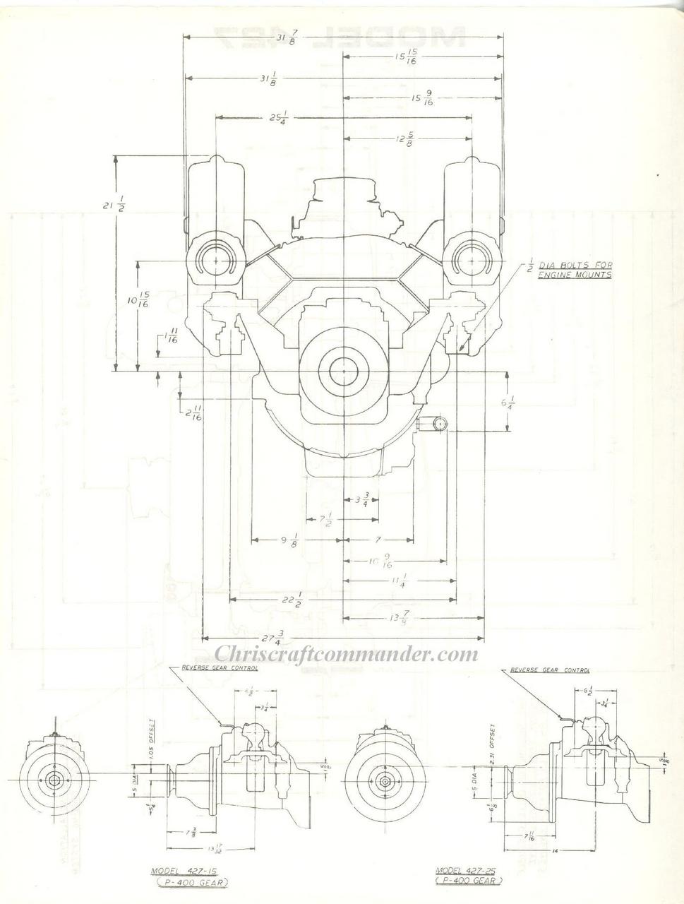

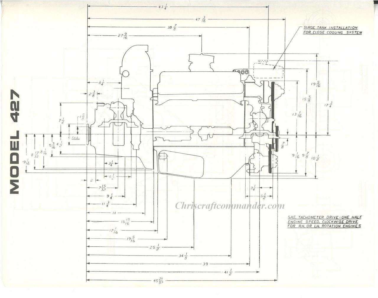

Many different Paragon models were used on the 427 ( see dimensions in scan )
September 10 2007, 5:47 AM
I received an email regarding dimensional deviation between paragon models used on the 427 models. The following scans may be able to clear up some of this, however, since the 427 was used on a variety of boats from Sea Skiff Corinthians, 31' Sports Express, and 47' Cruisers, there are undoubtedly a lot of different gear assemblies out there, not to mention the V-drive used on the 23' Commander.
Hope this helps a bit. We'll add more info as it becomes available here onto this Paragon thread.
This first image shows the profile of the HJ-7
This second image shows the P-400 profile.
The HJ-7 Paragon was used on all 427 engines before (engine) serial number 402936 except for 402969 and 402998. It would be interesting to know about those last two serial numbers, eh? They were offered in 1.5:1, 2.0:1, and 2.5:1 gear reductions in a LH and RH configuration.
The P-400 Paragon was used after engine serial number 402936 except for 402969 and 402998. These were offered in the same gear ratios as noted above, but with the addition of a 3.0:1, which was undboutedly added to propell larger craft more efficiently.

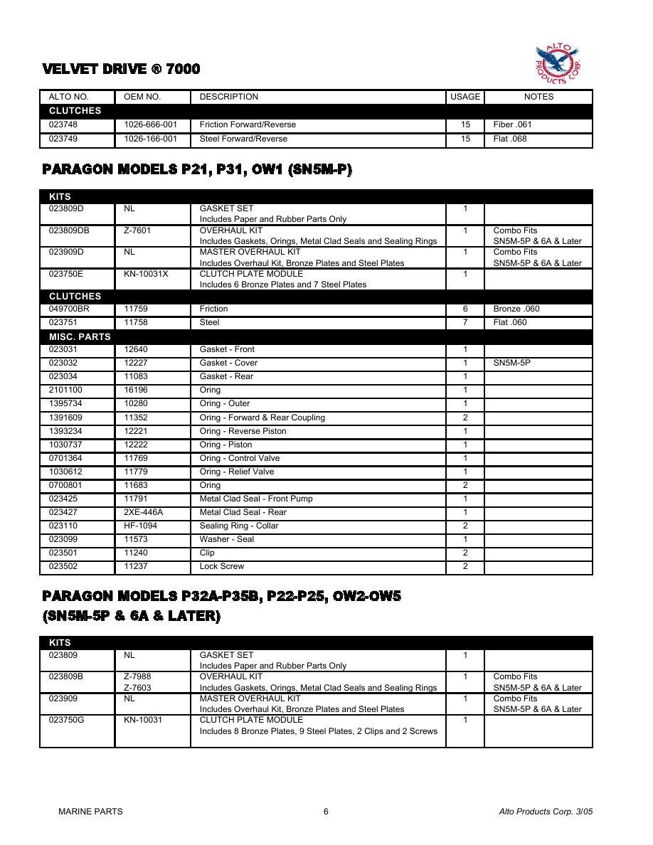

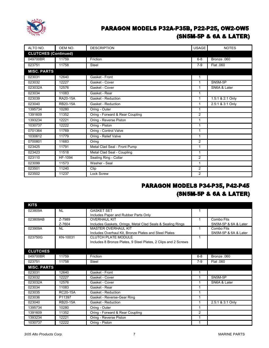

Paragon rebuilding (Parts list from Alto Products Corp)
March 27 2008, 4:38 AM
They don't make em like they used to! The industrial grade paragons have enough iron to make two new transmissions these days. They can be rebuilt and last another umpteen years. The price seems to be pretty much in line, as the smaller units are known for running $750 to rebuild. It depends on what all is being replaced, and with the the big tranny, if you are replacing internal plates, then that's not an unusual price. I'm sure it can be done for less, in shops that do this frequently as a routine, but we all have to remember, these things are heavy, it takes work, and the labor alone that it takes to handle them into the shop, rebuild them, handle them again for shipping (and of course, the rebuild parts) make up the total charges for working on this iron.
Paul
The following info is from Alto Products Corp, offered here as helpful info for the classic Commander enthusiast. We encourage you to contact this company directly for more info, availability, suitability, prices, etc.
http://www.altousa.com/products.htm
This message has been edited by FEfinaticP on Dec 26, 2008 2:10 AM

HJ-7 vs P-44 OAL
March 28 2008, 9:37 AM
Hi Paul,
I think you have it backwards the P400 has a OAL greater than 17.250" and the HJ7 has a OAL of 11.750". Unless I am reading the prints wrong, and that has been known to happen
Paul
Paul
(Premier Login FEfinaticP)
Forum Owner
You are absolutely right
March 28 2008, 10:45 AM
Paul, thanks a bunch for noting the error, I changed it in the writeup so as to NOT pass on bad info to our readership. It's my mistake, I knew the P-44 was longer, but somehow when it was typed it didn't read that way, perhaps the phone rang who knows. Maybe it's a sign of getting old, yikes !
In any case, the diagrams look like the HJ-7 references to the joint between the bell housing and the transmission at the 11-3/4" mark, as noted. The P-44 doesn't reference to this same point, but that tranny is CLEARLY several inches longer.
Thank you kindly, for catching this one!
