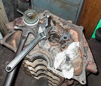

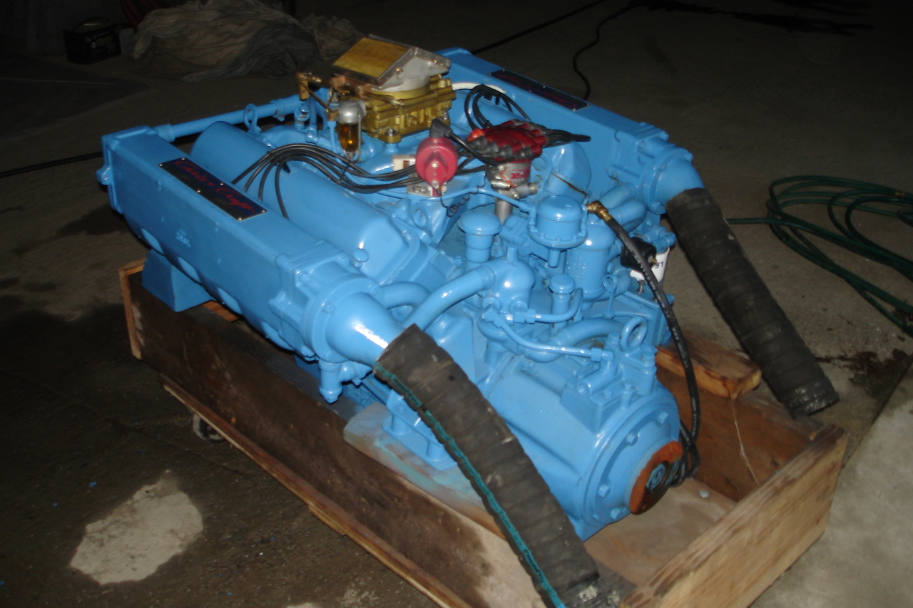

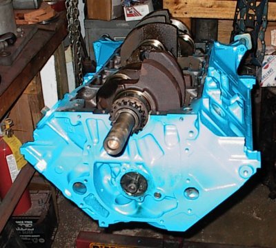

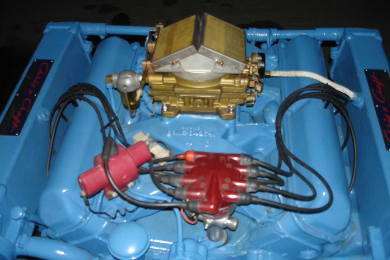

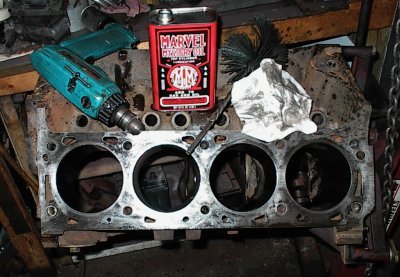

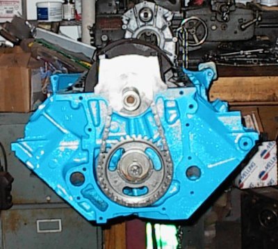

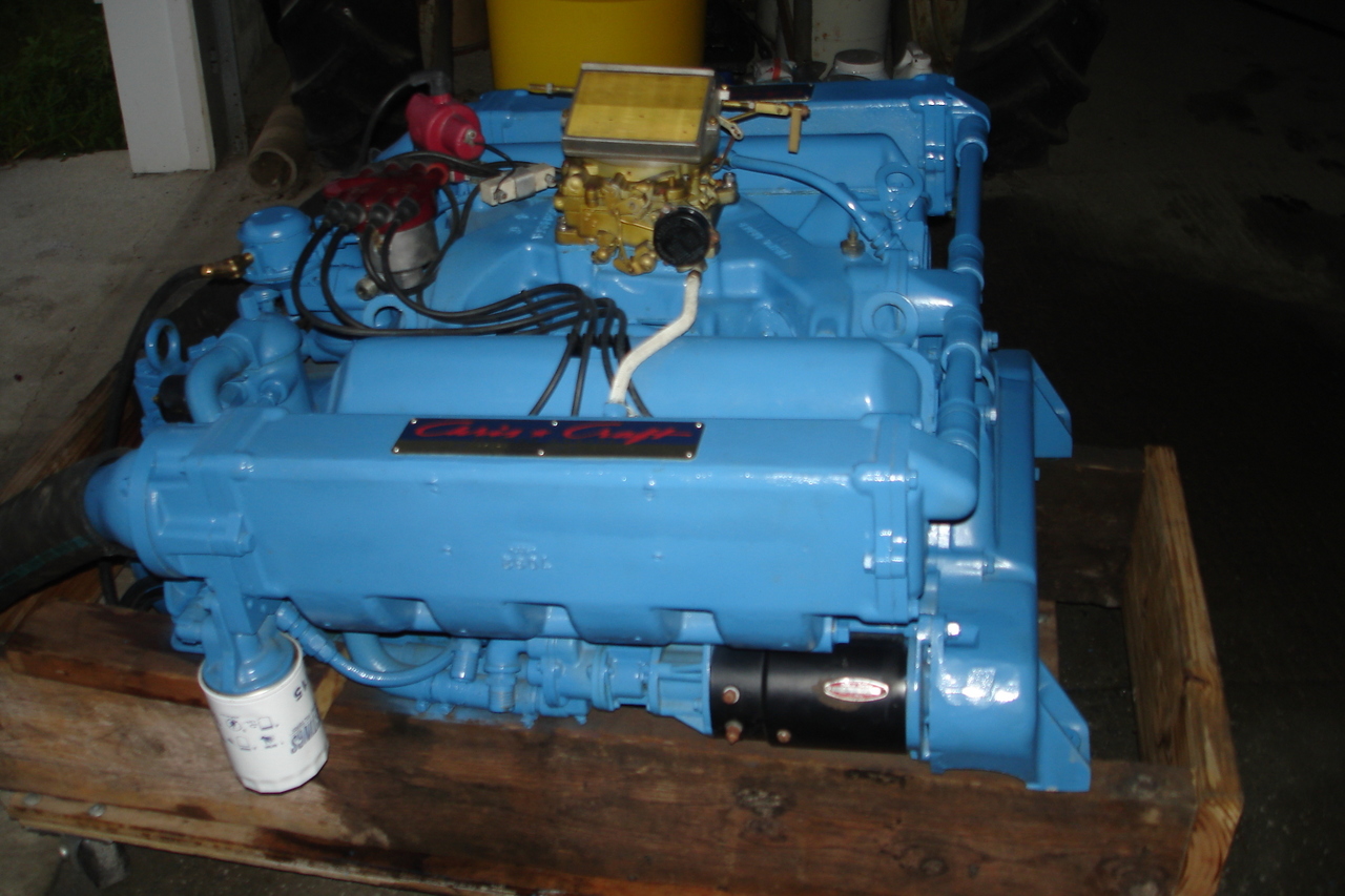

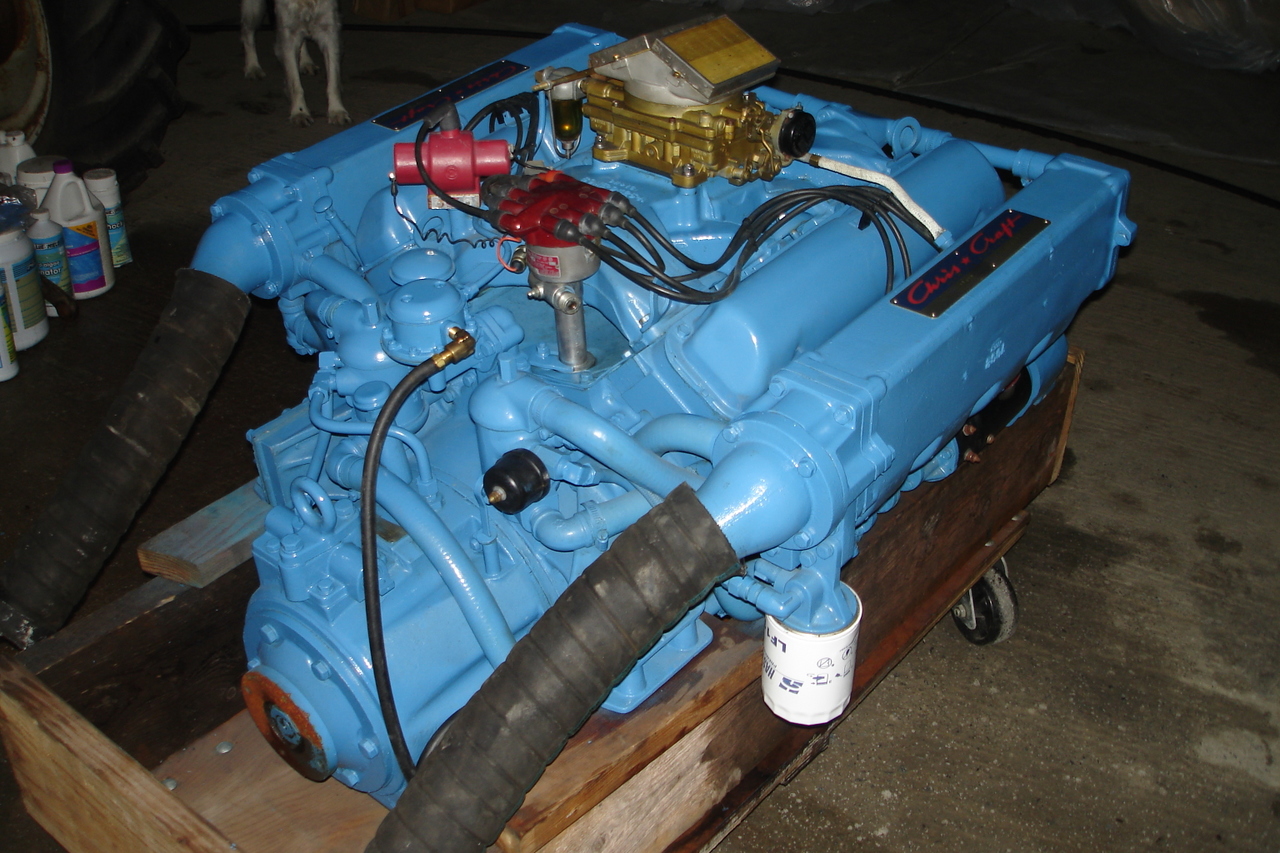

Here’s what Theo started with. It’s enough to make a frightened Chris Craft owner call Crusader, but is it really necessary?
The MEL block (Mercury, Edsel, Lincoln) is heavy, reinforced, and strong enough to last several lifetimes. It has enough meat to withstand many rebuilds.
The bottom end is more “truck like” than race-car. Everything is very heavy and built to last. This same design was used in the biggest gas Ford engine of the era, the 534 truck motor.
Theo thinks the cylinder heads use the same rockers that the FE series uses, and if so, it’s one of very few parts that are able to be interchanged with that series.
Like everything else about the premium Lincoln motor, no iron was spared on any part, including the cylinder heads.
Some people may have heard me refer to the MEL cylinder head as a “plank head” design. Here’s why. Notice the absence of a combustion chamber. The top of the MEL cylinder bore is cut off at an angle, and combustion therefore occurs in the top of the cylinder bore, rather than the cylinder head.
Even in Germany, far away from American suppliers and machine shops, the MEL is a known entity, and takes it’s place next to other exotic machinery. My comparison, this motor is more “tractor like” than high performance European. It is not a complicated device, and it was built for massive torque, something the Europeans never seemed to be able to justify on their continent.
In many cases, old iron simply doesn’t know it’s old. These blocks are so heavy, corrosion is not normally an issue.
Thanks Theo for sharing the photos, there are still many big MEL Chris Crafts out there. People have the option, by doing a simple rebuild like this, they will be able to reuse all of their ancillary equipment, transmissions, etc., potentially saving more money on a repower than I actually paid for my 38 Commander.

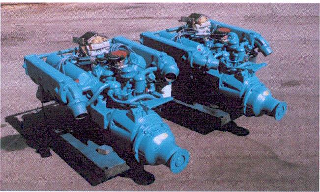

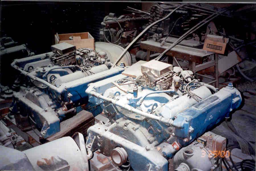

Here’s a dusty photo showing the big block Lincoln motors as installed in a cruiser (sitting on pallets). The MEL was the first big block V8 offered in the Commander series, and it was a premium motor of the day.
The MEL was NOT a cheap motor to manufacture. At one time they ran each motor for 10 hours on a test stand to assure quality control. The initial run of 1958 motors apparently had “first year flaws” which were very quickly fixed by Ford. The engine went on to haul heavy loads quietly and reliably, and some even ended up in Chris Craft boats. When I interviewed a Chris Craft insider a few years ago, he said the 430 “was as good as any other motor Chris Craft used” speaking about reliability and call backs. I thought he would say some negative things about it, but all he had was praise. All motors wear out and eventually need rebuilding, but it’s often the small ancillary issues like alternators and water pumps, points, condensers, coils, and carbs, that make a motor appear to be unreliable run poorly.
At the time this ad was released, they were billing the 430 as “Americas largest V8” (they later increased the displacement to 462 cubic inches to maintain the claim).

LOOK at this angle with muscles ( FOR SALE )
October 2 2007, 10:27 AM
As I've contended many times in the past, with a little cash and the willingness to do it right, old iron like the Lincoln 430 and 431 can be rebuilt many times and perform "as new".
We featured one such rebuild from my buddy in Germany, but here is a beautiful rebuilt in show condition inside and out. If you think the rebuild is too much to pay for, you can buy this one complete with all marine hardware and transmission for $7500. Therefore, if you already have one needing attention, the cost would naturally be far less than this to freshen one or a pair of them up. The Lincolns, by the way, are heavy iron, and able to be bored out with less concern than the thin-wall 427s.
More photos and data in the next post...............
Paul
Paul
(no login)
More photos !!!!!!!!!!!!!!!
October 2 2007, 10:32 AM
Rebuilt and blueprinted by David Van Ness of Van Ness Engineering in New Jersey. Zero time since completion, never installed. All correct components, restored to show condition. Please call 212.724.2566 for more info. or pictures.
Condition : 10/10
Location: United States NY 10023
Price: $ 7500 USD
Beautiful job, David. Anyone with a pair of Lincolns would do well to give you a call.

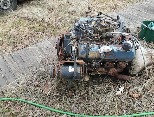

Now THIS is a serious Lincoln REBUILD PROJECT !!
October 2 2007, 2:23 PM
In all reality, a chunk of iron found out in a pasture that says "Lincoln" on it, is still probably able to be rebuilt if it has not frozen.
Yes, there are guys out there who will junk the finest running engine of the era because they still have an original frayed spark plug wire, if the paint doesn't look new, or if they have some ancillary equipment needing to be replaced. Some of these guys will turn right around and spend tens of thousands of dollars repowering (and the rest of their lives telling everyone how great the new engines are, or rationalizing their actions), lol . We all probably know someone like this, either now or in our past.
Some of the motors have actually been destructed, scored cylinder walls, broken rods sticking through blocks, whatever. Most of them are still able to run almost forever, given a little cash, desire, and an owner with a little nerve.
In all reality -->reality check please<-- many of these old engines are ridiculous NOT to rebuild, in the era of the "new recycle sensitivity". Why discard something that is still able to run for half a century more?
Here's a rebuilt Lincoln. Nice, huh? Yes, and it will probably run for another 40 years before it needs another coat of paint, rings, or bearings.

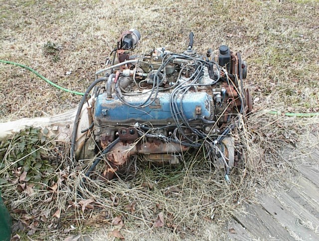

Now here's one that was literally, found in a cow pasture. Would you rebuild this one? Most of us would say no. Many of us would be reluctant to rebuild one in MUCH better shape that was in a boat. However, this is an example of what can be done, with a little desire.
It looks pretty bad in these photos. What lots of people don't seem to ralize, most of the value is still there. The Lincoln has so much iron, it can be rebored for new pistons if it needs it. If the crankshaft isn't scored, all it needs is a light polishing and it can be put back in service with new bearings, etc. Parts are available. The trick is finding someone like David Van Ness of Van Ness Engineering in New Jersey, who knows what he is doing. David did the engine rebuild at the top of the page, I guess he knows what he is doing!
More photos in next posting........................

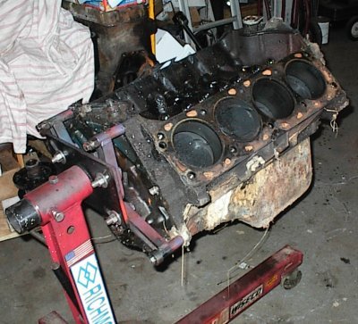

Lincoln REBUILD -------------- PHASE - I
October 2 2007, 2:29 PM
Rusty, dirty? Yes.
Worn out, not able to be rebuilt? Nope, just because it has dirt on it, doesn't mean it can't be rebuilt. Since most of our marine engines are in much better shape that this one, and many are still even running when they are hauled out, it really makes a lot of sense to recycle them with new pistons, rings, and bearings. Add a cam, timing chain, and cylinder head job, in essence you have a new motor. Oh yes, don't forget the paint !!
More photos in next post...............................

Lincoln REBUILD ------------------- PHASE - II
October 2 2007, 2:32 PM
More progress photos, showing the MEL block with cam and crank being installed.
more photos in next post................................

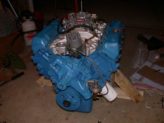

Lincoln REBUILD ------------------------ PHASE - III
October 2 2007, 2:38 PM

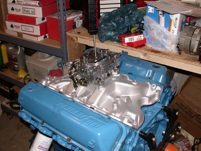

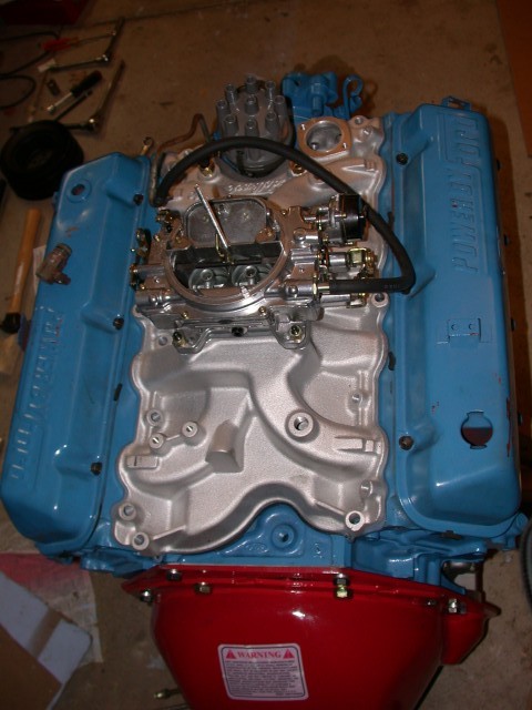

A new performance intake manifold !! It may not be well known, but these engines were able to deliver 400-hp in stock tune, before Lincoln decided to detune them (because all the torque was causing the frame to flex, and the doors wouldn't shut, ha ha)
The photos below show the motor in it's final stages, actually having been test run.
The purpose of this post isn't to make fun of anyone who repowered their boat. The purpose it to stress the fact that some motor types are very rebuildable, and just because they're burning oil, look dirty, making noise, etc., does not mean they can't be made to perform beautifully again.
End of story !

THats NOT a Lincoln block!
December 21 2008, 6:44 PM
thats no lincoln block... its not y block which extends down past crank center line...
those are not lincoln valve covers
I think mabey lincoln motor better than most of us realize......
Tom Slayton
(no login)
Could be a 1957 Lincoln Block
December 21 2008, 11:01 PM
this one bears some looking, that motor could well be an earllier version of the Lincoln, but the valve covers do indicate "power by Ford".
Tom
Bill
(Login billinstuart)
EGR?
December 22 2008, 4:32 AM
So I'm reading this, and look at the pictures. First, the engine pictured has a PCV valve..that showed up in the '60's. Also has a GM style power steering pump. Again, '60's. The Tell is the EGR valve. That's '70's stuff. I'm not a big block ford expert, but that sure looks like a regular 460 Ford to me. Finally, that is Ford corporate blue paint, which is a Newer color.
From memory, the 430 Lincoln engine in my dads '58 Continental was alot different than that engine.
Thoughts??
(Login cadunkle)
That is a 460, NOT a MEL engine..
December 22 2008, 9:07 AM
That engine is the rebuild photos is a 385 series motor (429/460). It was originally from a Lincoln. You can tell by looking at the C6 it was mated to. Those tall ribs on top are only on Lincoln C6's, and if you could see the trans mount it would not be a standard flat mount, but an odd V shaped mount used only on Lincolns. Also if you could read the head casting numbers I can almost be certain they would read D3VE (1973 Lincoln Engine), though all 385 series head were marked xxVE (xx being the year of casting design, V being Lincoln, E being Engine).
These engines are cheap power, much cheaper than FE based power (though the more modern design lacks the nostalgia and racing history of the FE). Also 385 based engines can be cheaply and easily stroked to 545 cubic inches, making some serious power and torque.
Paul
(no login)
The mystery is solved !
December 22 2008, 3:55 PM
Thanks for the confirmation Cory, good stuff.
