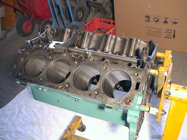

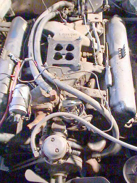

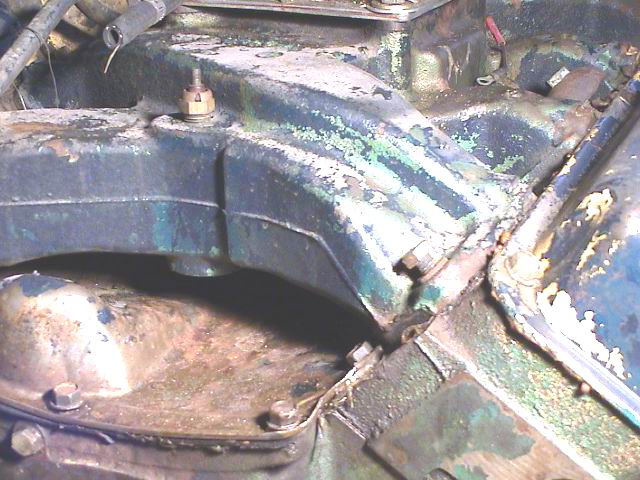

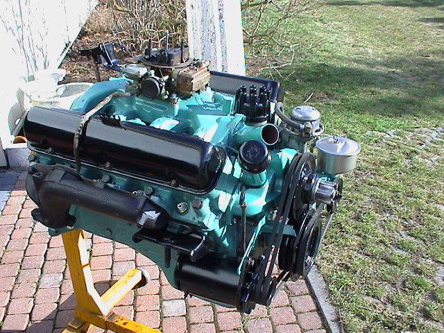

      Here’s what Theo started with. It’s enough to make a frightened Chris Craft owner call Crusader, but is it really necessary?

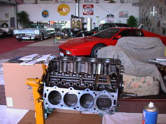

      The MEL block (Mercury, Edsel, Lincoln) is heavy, reinforced, and strong enough to last several lifetimes. It has enough meat to withstand many rebuilds.
      The bottom end is more “truck like” than race-car. Everything is very heavy and built to last. This same design was used in the biggest gas Ford engine of the era, the 534 truck motor.

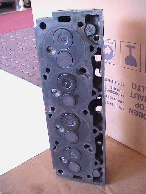

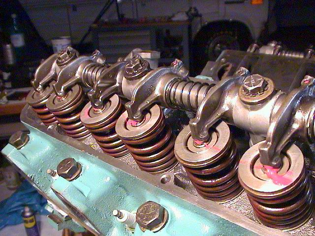

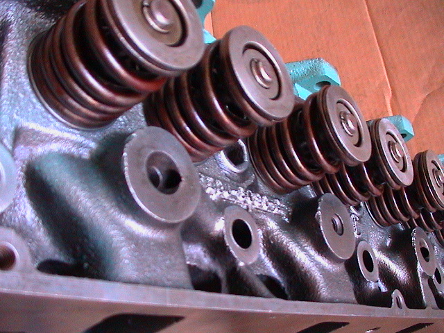

      Theo thinks the cylinder heads use the same rockers that the FE series uses, and if so, it’s one of very few parts that are able to be interchanged with that series.

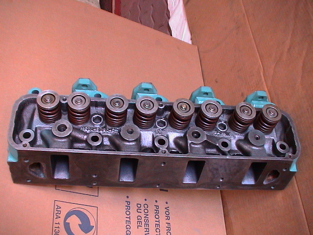

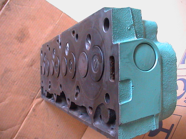

      Like everything else about the premium Lincoln motor, no iron was spared on any part, including the cylinder heads.

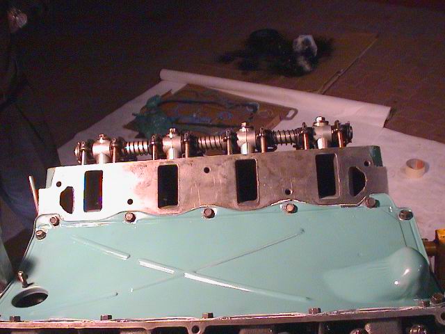

      Some people may have heard me refer to the MEL cylinder head as a “plank head” design. Here’s why. Notice the absence of a combustion chamber. The top of the MEL cylinder bore is cut off at an angle, and combustion therefore occurs in the top of the cylinder bore, rather than the cylinder head.

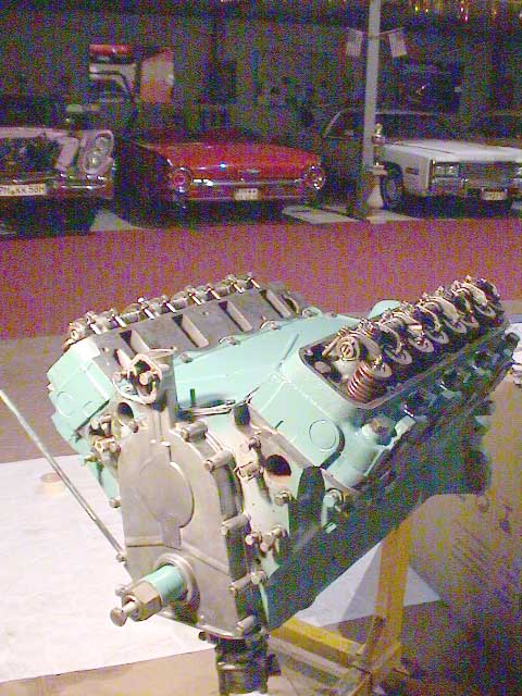

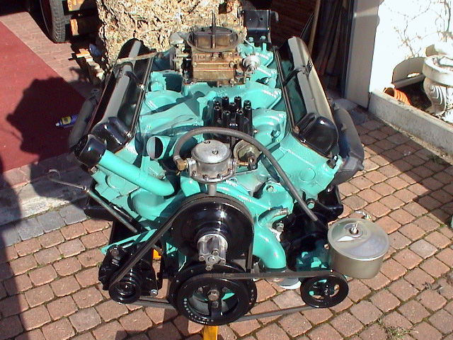

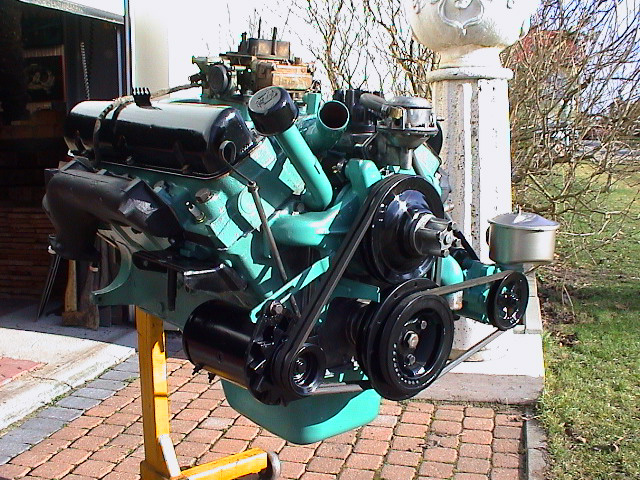

      Even in Germany, far away from American suppliers and machine shops, the MEL is a known entity, and takes it’s place next to other exotic machinery. My comparison, this motor is more “tractor like” than high performance European. It is not a complicated device, and it was built for massive torque, something the Europeans never seemed to be able to justify on their continent.
      In many cases, old iron simply doesn’t know it’s old. These blocks are so heavy, corrosion is not normally an issue.
      Thanks Theo for sharing the photos, there are still many big MEL Chris Crafts out there. People have the option, by doing a simple rebuild like this, they will be able to reuse all of their ancillary equipment, transmissions, etc., potentially saving more money on a repower than I actually paid for my 38 Commander.
