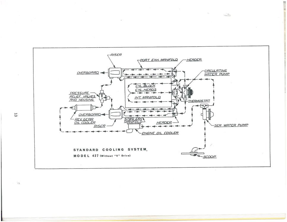

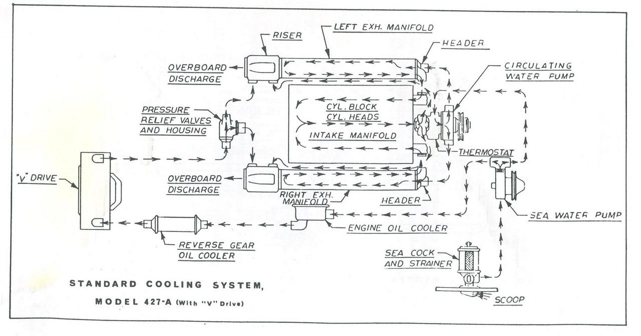

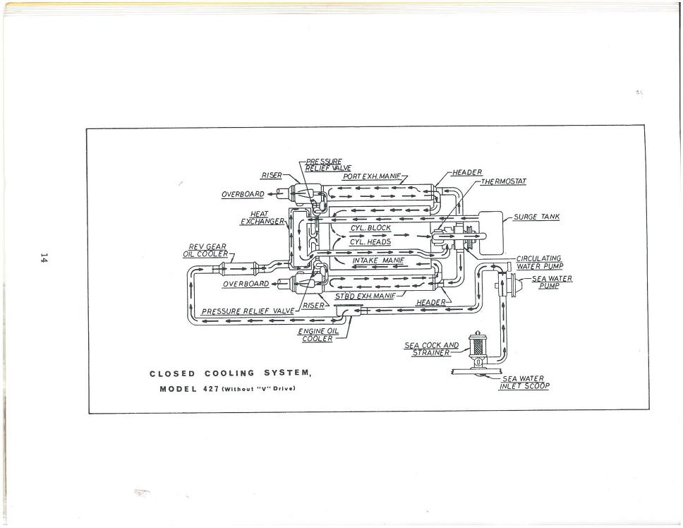

There can also be a clogged oil cooler, which on some motors (closed versus standard cooling) will make more of an impact than others, take a look at the diagrams here and you can see why. The pressure regulator valves are well documented here on The Forum too, and they help assure you get FULL WATER to the standard cooled motor when your boat is running at idle speed, and they help bleed off excess pressure at high rpm. If the PRV is stuck open on the stancard cooling system, then you'll overheat at low rpm. On the closed cooling system (see diagram) the PRV system seems to only function as an emergency pressure relief device, and the closed system, you'll note the clogged oil cooler can affect the entire cooling flow to the heat exchanger. Exhaust lines and exhaust manifold internal passages can become clogged, causing a short circuit in the system, which can lead to overheating.
