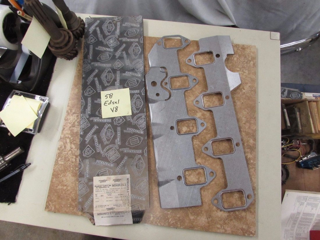

The factory Exhaust Manifold Gaskets on a 430 were made of thin steel.
Here is a set of Fitzgerald Factory design Gaskets. There are several things to note. Most important is the sealing channel embossed around each port. Second is the material that seals the choke stove plate.

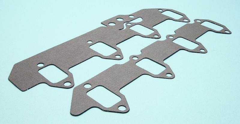

Fel-Pro MS9454B Exhaust Manifold Gasket Set - 1959-1967 Lincoln 430, 462 V8
BEST gasket does not sell retail, only to established distributors.
Lincoln,Merc,Edsel V8 383-430-462 1958-68
QTY PART NO CONTENTS
1 18025 Exhaust Manifold Right
1 18026 Exhaust Manifold Left

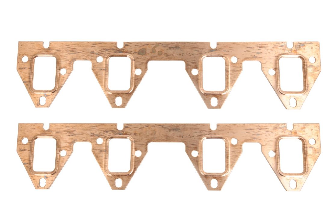

Summit Racing SUM-111434 - Summit Racing® Copper Exhaust Gaskets
Engine Family: Ford big block FE
Thickness (in.): 0.042 in.

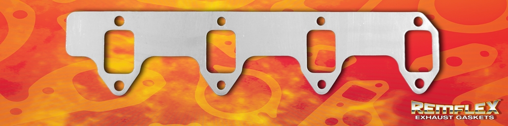

Remflex 3038-2
Remflex is a quality gasket however there is no provision for the choke stove gasket.
1-7/16" x 2-1/16" Square Port
Edsel 410 / 6.7L (1958)
Edsel 430 / 7.0L (1958 - 1965)
Lincoln 462 / 7.6L (1966 - 1968)
Mercury 383 / 6.3L (1958 - 1960)
2/set
Suggested Torque: 20 Ft Lbs
1.) DO NOT BEND! Remflex gaskets are designed to withstand clamping force and incredible heat, but not bending. If you bend them, they will break!
2.) Do not over tighten. When properly installed the flange should be tightened evenly - See the suggested torque range.
3.) Longer bolts aren't necessary. Though Remflex are thicker than other gaskets, standard length bolts will work fine.
4.) Do not use sealers. Silicone and other sealers cannot withstand the same temperature as Remflex gaskets, and can actually cause leaks.
