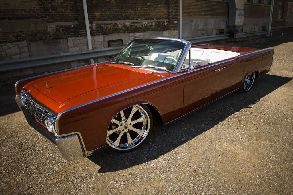

Buddy do you have contact information for the linkage? I posted photos of my car on the Lincoln Forum. Any comments would be greatly appreciated.

Those rims are not my thing, but the rest looks great. Looks almost identically to my T-Bird's maroon paint. Very nice.

This info is from the Ford 6V carburetion site. The Lincoln looks great. Big wheels are nice when they are simple and classy like the car itself. I do not like the bling bling flashy rims so good job! The more smooth chrome surfaces the marrier! Good luck
Did you buy the finned valve covers? That would be a nice touch!

Thanks for the comments and information. I went with Super Marauder valve covers, I almost order the Moon covers just because. I am going to have the inside of the fins painted the same colour as the car. Now to get the intake done, shipped back to me and see if it will actually fit, I don't have the heart to modify the hood. Fingers crossed.
