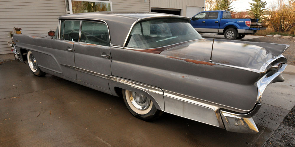

I was at a yard sale two months ago that had advertised "1959 Lincoln Town Car." I inquired about it and was led to where it had been parked for twelve years, since the previous (and second) owner's death. I fell in love with the car and could see that it was basically straight, rust-free (this is a very dry desert climate), original and mostly complete. It was a glorious land yacht begging for restoration, so I bought it from the widow and had it towed two miles to my place.
The car as found:
