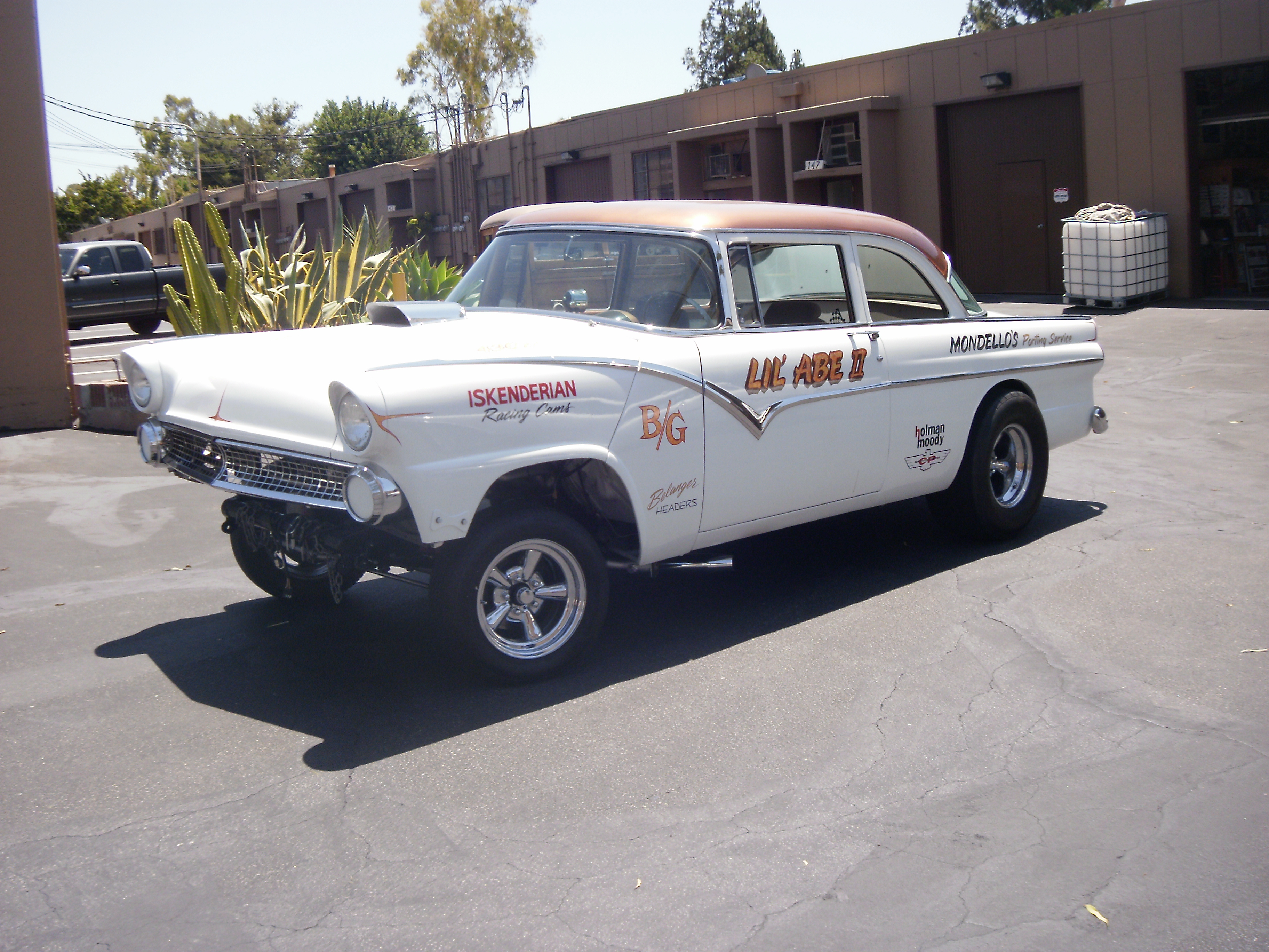

55 ford gasser
55 ford gasser
lil abe 2 mild 430 set back about 7 inches 3x2 reground solid lifter cam C-4 4:11 locker
Re: 55 ford gasser

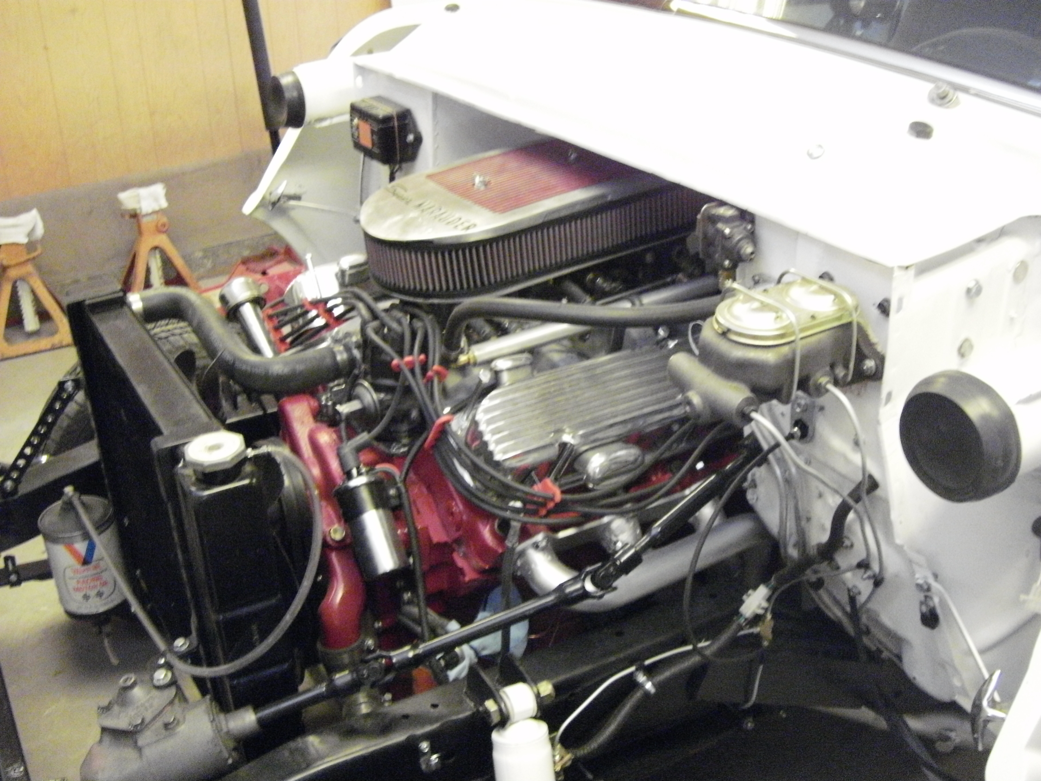

Looks really nice John. How about some motor photos.
vanscooter
- Posts: 55
Re: 55 ford gasser
Just a perfect car. Right look, right stance, right body/motor !!!! Any specs ? What about times and speed ? vanscooter

hers a motor pict 58 430 060 over 9.5 comp reground solid lifter cam int 15-47 ex 55 - 7 @050 516 lift pocket ported heads tri Y headers.58 merc intake 400 cfm ceneter and 500 cfm end holleys carbs this is my street "back-up motor" building a hotter 59 430 will post picts and info under motor section only have about 100 miles on rebuild so haven't really stood on it yet or raced it so no times or speed
Re: 55 ford gasser
Wow John, that is quite the set up there.
Did you have the Air / Valve covers modified?
Re: 55 ford gasser
unknow v/c a/c is fact 58 merc maurader cut down
