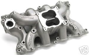

I would like to know how water/coolant flow was modified. A 460 intake has no rear coolant passover. Coolant flow is completely different.
Runner style used-
EDELBROCK AIR-GAP (HOT STREET)
EDELBROCK 460 AIR-GAP_2.jpg (10.97 KiB) Viewed 60125 times
