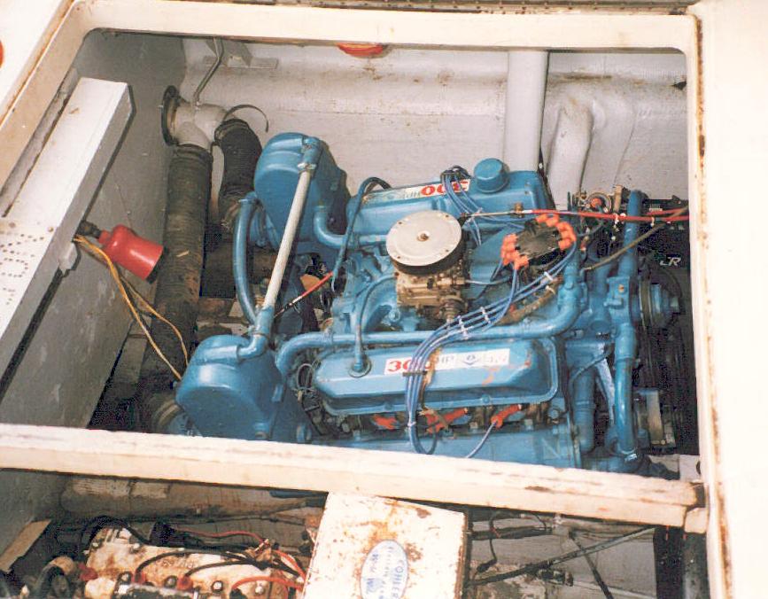

I have to agree with Reece to an extent, to be sure the mechanicals are really needing replacement prior to jumping into a repower. Ive seen people do this in the past, spend $40,000 in a heartbeat, end up with a good end result, but do so needlessly. One guy in particular, would be out there this next season without a care in the world except for a tiny bit of fuel consumption concern and the fact that he has old motors, but he would have $25,000 hard cold cash in the bank now if he had rebuilt a pair of perfectly good big blocks with plenty of iron left in them.
I realize there are two other factors here; one is the fact that motors DO wear out and they sometimes need to be replaced; two being the fact that sometimes because I want to is a perfectly acceptable reaction especially when one has a bad case of boatitis. I used to tell my Grandmother, that at her age because I want to was a perfectly good reason to do anything. With the amount of actual running time most of us do, "because I want to" does factor into things, and as I said, it happens a lot in boating especially when the captain has an advanced case of boatitis. So if you have the cash
Here is what my motors looked like when I bought the boat. I thought "oh heck, these will need to go", however, here I am now 15 years later and they ran just great last week end when I met FANDANGO on the water in the rain.
Here they are after a tune up and a little TLC
Here they were the day John Clemans photographed the boat, one photo just appeared last month in Motor Boating again (motor shot, oil article)
Photo below taken in March of 2006 by John Clemans, senior editor of Motor Boating Magazine, aboard a Hatteras photo boat.
Photo below taken November 30, 2008 by Reece Ewton, aboard FANDANGO.
So what LOOKED like a basket case, actually turned out to be a pair of motors that had a lot of life still in them. With the amount of real-time boating I actually can squeeze out of a 365-day year, these darn things will outlast me! happy.gif
