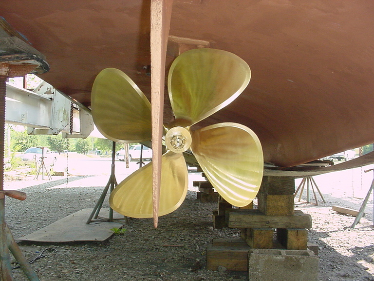

Here is one of the beautiful 4-blade props I put on TRADITION, original props were 23x25 for the 38 Express, and I installed 23x24 4-blades. As a result the boat will still fly, but I am not getting the full benefit of the nearly $1000 cost for each of these props because I'm over propped at the time, and I can not reach full RPM with the engines and therefore have concluded these should have really been 23x23. Next time the boat is out, I will reinstall the newly balanced 23x25 3-blades and send these off to be repitched to 23x23.
The only real way to tell for sure is to do what CC did with each of their new boats, and that is to try it. If you have a 22x22 4 blade on the boat, and want to go to a 3, I would think a 22x24 would make an interesting swap, might even get a tiny bit of additional speed, but might lose something in the middle range. As the Brayer boys have advised on numerous times, "it's not an exact science", and their brand of "black magic" along with a good understanding of engineering principles and great driving skills is what won all those APBA races for Curt.
