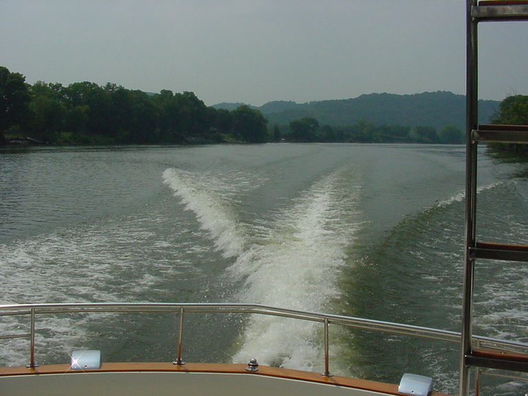

Here's what my high speed wake looks like. Its still fast, but I can pick up a little more speed with the repitch some day. Ah well, I'm not losing any sleep over it. With the massive low end torque of a 427, the big dogs are still happy. Based on your motors, I think the 23x23 would still be a good option for you. They're tough to find in a 1-3/8" shaft size, mine were custom, but that just means they were not an on the shelf item. They had to be specially bored for the 1-3/8" shaft, and that took them about 2-1/2 minutes extra time and no additional cash.
