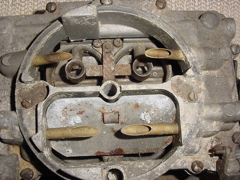

A new Edelbrock marine carb (or a pair of them) can make a boat run like new. If you have rebuilt your old carbs numerous times and they just don’t seem to be getting the job done, or perhaps they look like the one below, then a new Edelbrock 600 may be the ticket.
The carb above had just sat around way too long to mess with. It fell into the “life is too short” category. I’m sure there are experts out there who can rebuild these, carbguy in Sweden being an example, but I just didn’t want to pay the labor and still end up with an old carb this time.
