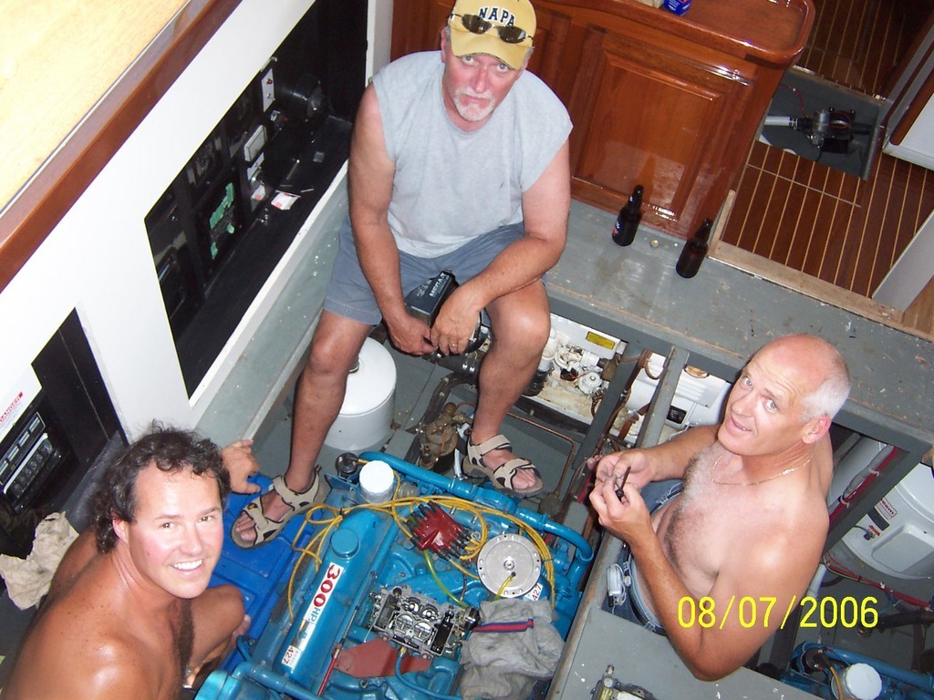

      ABOVE: Dean Beliveau, of Ontario, shown (left) working on a 427 carb with two buddies. Good help like this is hard to find!

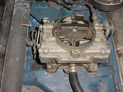

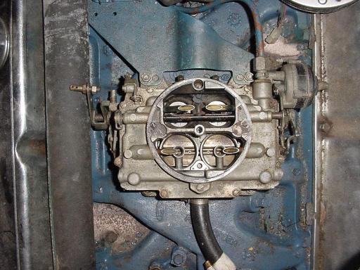

      Looking down the top (front of the motor is toward the bottom of the photo).

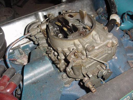

      View from the port side, you’ll note Ford installed the distributor in the proper location at the front of the motor.

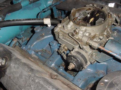

      Rear view of the Carter AFB as installed on a marine 427
      Starboard view of the AFB. They obviously were run hard and long.

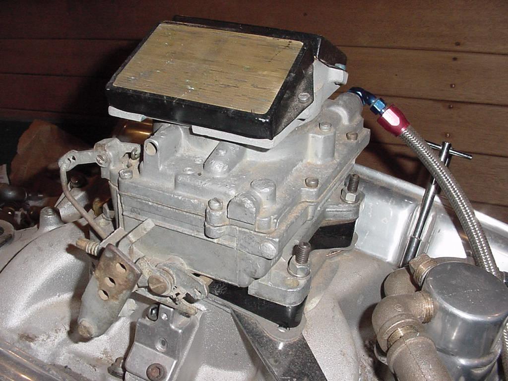

      Here’s a photo of my speedboat setup, photo taken several years ago. I’m not real sure what size this carb is, but I rebuilt it, I never really determined all of the jet settings, size, etc. The boat runs very strong.
      Another view. Sorry for the dust, this was during an era when finish sanding was under way, and the motor was just lifted into the boat for final fitment to the stringers.

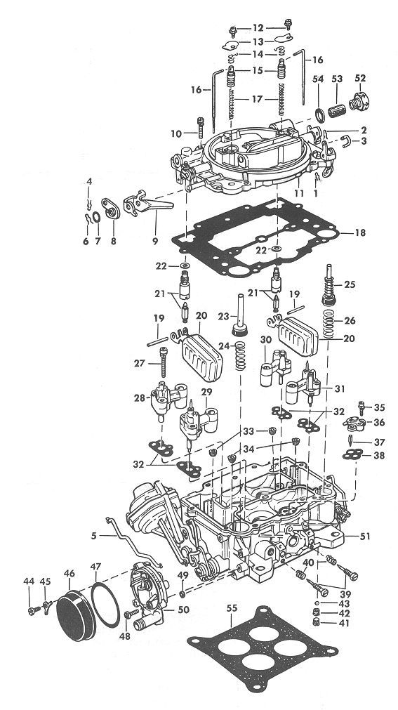

      Here is a writeup I found that pretty well lists the basic concepts of a Carter AFB.
      Aluminum Four-Barrel (AFB) carb was there, and it's never gone away. The AFB design still enjoys a loyal following, and for good reason. It's a simple carb to tune and rebuild, and it makes great power. Today, the basic design of the AFB has been adopted by Edelbrock as the basis of its Performer series of carburetors.
      Performers, like all AFBs, use metering rods attached to spring-loaded step-up pistons to provide fuel enrichment as the engine transitions from light-load, low-fuel-demand situations like cruising and light acceleration to high-load, high-fuel-demand situations like wide-open throttle acceleration. Metering rods can be swapped in minutes without disassembling the carb and allow you to richen or lean the mixture by up to about 8 percent in either direction without changing jets.

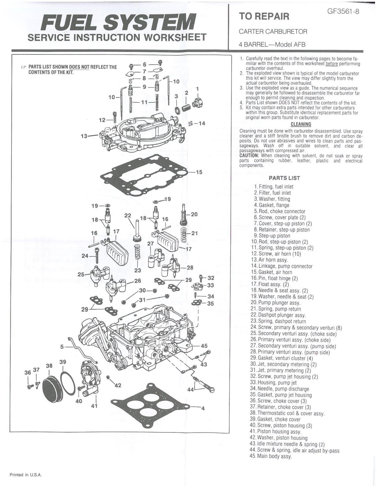

      Here is a complete rebuild and tuning guide for the Carter clone now being built by Weber/Edelbrock
