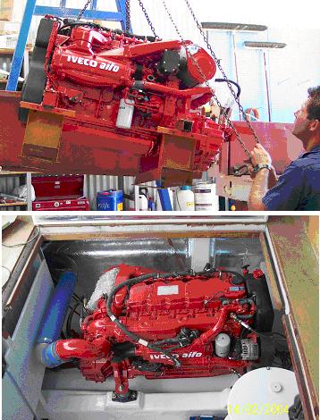

If you really want to go overboard, install a pair of these turbocharged IVECOs like Warren did! They pushed his 38 along very nicely.
