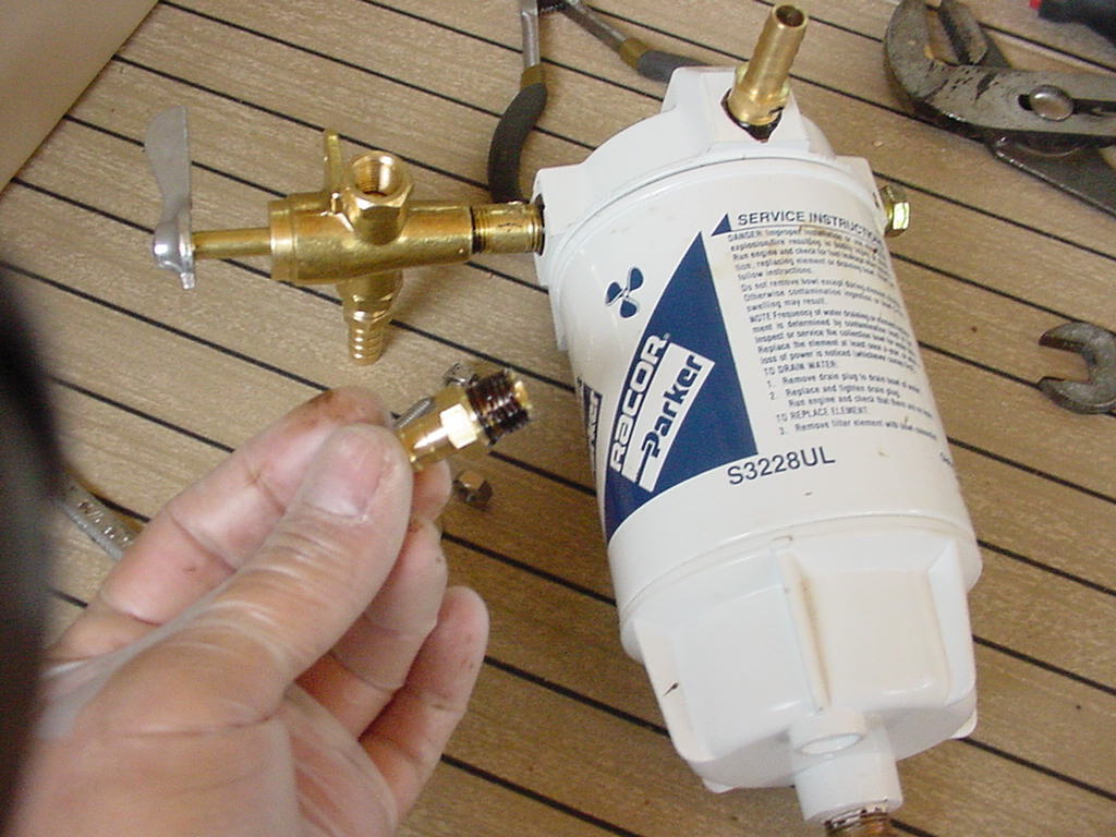

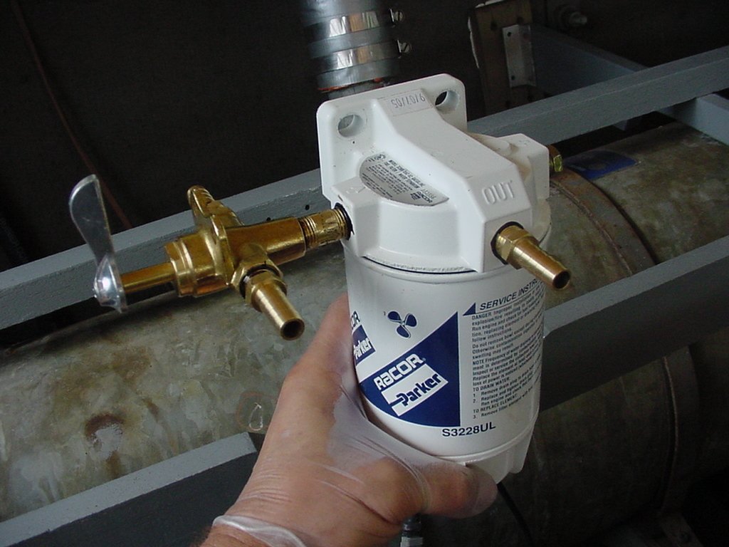

Here is the big Racor I installed as protection to debris in the old tank. I drained everything out and didn't see much crap, but I feel better knowing all the fuel is going through this big guy first. I have it set up so I can switch into a carry on tank too, in the event we do some long distance cruising.
