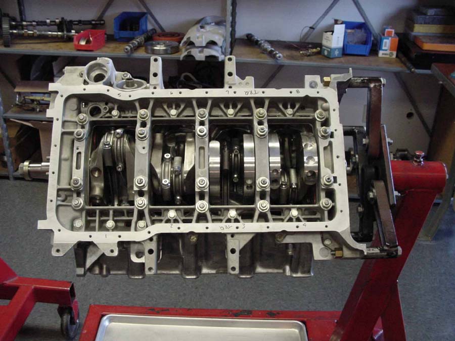

This is a thing of beauty. It's the bottom end of the 928 V8 motor, and you can see how the full length girdle holds all the bearings and the crankshaft in place. When people wonder what makes a Porsche cost more money, it's machine and casting work, and the labor to get pieces to fit up within tolerances, like this. The 928 was not a cheap mass-produced motor, and neither is the 944. The 928 bottom end remained the same, for all engines produced from 1977 to 1995, ranging from 219-hp to 350+, and it is adequate for race prepared engines producing 400 and 500+ horsepower.
Here is another view of the girdle concept used on the 928 and it's 944 variants. This is a race prepared 944, and you can see some superb workmanship on those "knife edge" crankshaft counterweights. Photo below is the same motor. Pretty awesome piece of work, even in dead stock form. The 944 block has been able to withstand 600-hp in full race turbocharged form, from houses like Kelly Moss.
Here is the 4-cylinder version of the girdle, as used on the 944. Even though the 944 was considered an "entry level" Porsche, you can see Porsche spared no expense when it came to their engine designs. This is a case where engineering dictated to the marketing department what to say, and not vice versa.

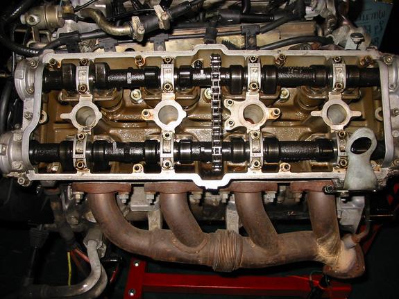

ABOVE: View of the 3.0 litre 4-valve 4-cylinder DOHC hemi used in the S2 944.
