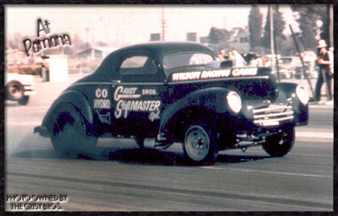

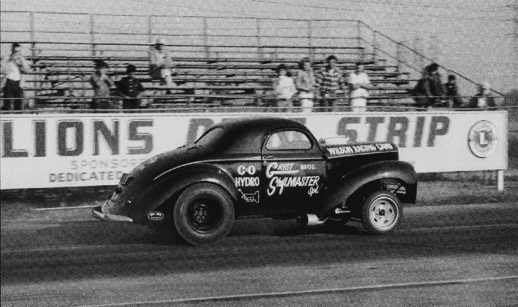

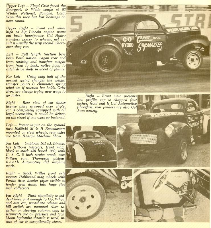

My grandfather and great uncle, Floyd and Ralph Grist, formed the Grist Bros and raced in the A/Gas Unblown class of the early 60's at dragstrips across SoCal. They set several ET and MPH records at nearly every track.
They used a 430 MEL that had been bored .060" and stroked using a C.S.C. half inch stroke crank making it around 500 ci. It used Dempsey Wilson Racing Cams camshaft, and Mickey Thompson pistons. The machine work was done by Reath Automotive. The induction used Hilborn injection and the magneto was by Hunt.

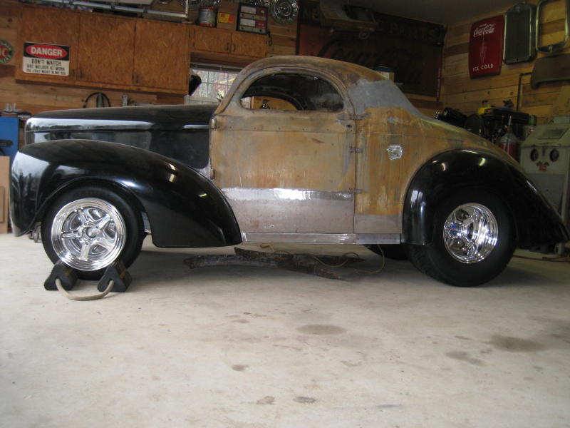

This is how the car sits as of today.

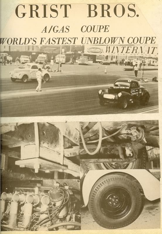

"They purchased a 430 cubic inch Lincoln engine and started building on it. They bored and stroked it to 501 cubic inches. They ran a stock “nodular” crankshaft. In the early days Joe Mailliard helped with the machine work. After Joe Mailliard passed away, Joe Reath started helping with machine work and parts … like a set of Hilborn mechanical fuel injectors. Dempsey Wilson ground all of the camshafts with his "special" grind and Mickey Thompson helped with some aluminum pistons and rods (the compression ratio was around 13 or 14 to 1). A Joe Hunt magneto provided the spark. A guy named Dale Klienhand arranged to have some Headman Headers custom built. The local Autolite and Valvoline distributorships supplied weekly doses of plugs, oil and filters delivered straight to the house.
It wasn’t known exactly how many horses were under the hood, but it more than a handful and the track records were dropping most every week. And, Dad and Ralph were right in the middle of it. I’ve still got some of the NHRA certificates of some of their record-breaking runs.
At first they had a lot of trouble with spinning bearings. Dad and Ralph learned from Ted Cyr and Leland Colb about drilling the main oil galleys and drilled them out with a special long drill."

I noticed the Hilborn injector pics posted by Chris Craft Crazy on the aftermarket induction thread are the same as were used on the Grist Bros MEL (pic above). I imagine a set of those would be a rare find indeed. I'm new to the forum/thread and am enjoying the posts.
