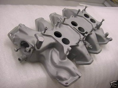

I drove to Detroit and back today... 13.5 hours round trip, and I bought this....

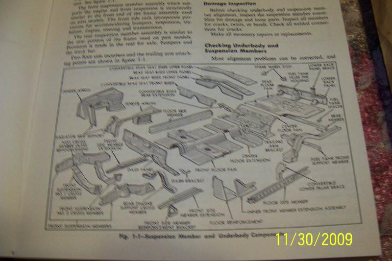

and look what's in it. this is the mechanics maintenance manual..!
I just about crapped when I saw it sitting there.. :mrgreen: Each section of the car has a complete maintenance, schematic and tool listing. Maybe these are common, but I didn't think so. All the torque specs, everything

Post by reijerlincoln » Sat 5. Dec 2009, 15:03
Nice intake! Does it need custom heads?
Posts: 238
Location: Ontario Canada
Re: LOOK WHAT I FOUND
Post by Chris Craft crazy » Sat 5. Dec 2009, 20:23
That is an original Ford motor company super marauder intake.... so just a bolt on.
Now I need carbs...

Post by Ted » Sun 6. Dec 2009, 07:29
The Mopar six pack carbs are a bolt on. I have the 440 carbs on mine and simply bored the throttle holes in the intake to match the carb bore sizes on the end carbs. The center pivot carb bowls on the Mopar carbs just clear the distributor without having to change over to the side pivot flat faced bowls.

Post by Chris Craft crazy » Mon 7. Dec 2009, 17:08
I am going to chicken out, and send the manifold to Joe Bunetic, who I have spoken to a couple of times on the phone. I need mechanical linkage, and marine returns on the tubes..
