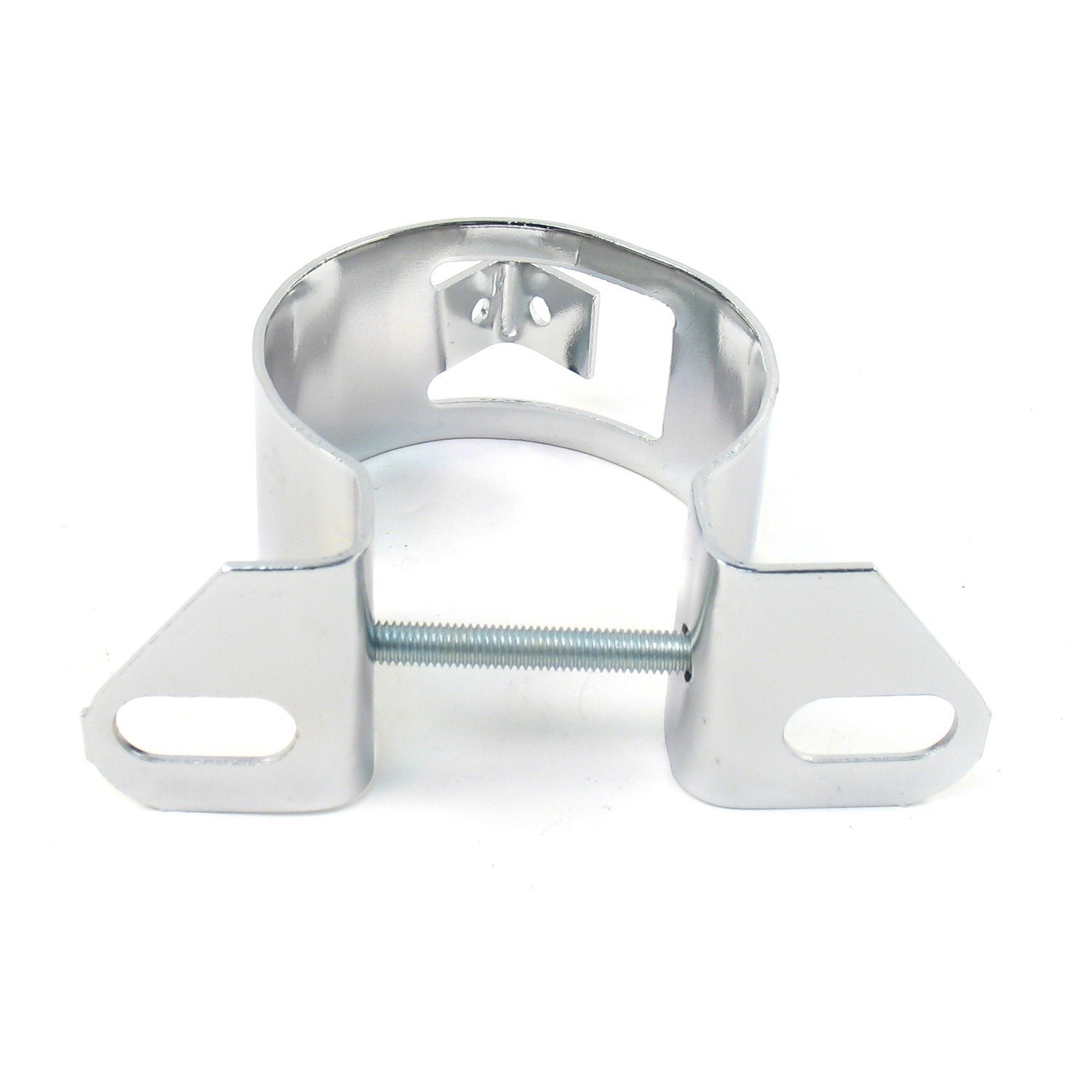

10001 Coil Bracket (optional not required)
