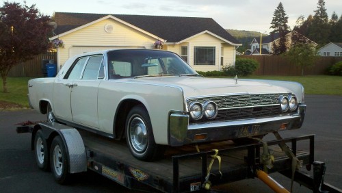

Well, it looks like diagnosing and fixing the carburetor and choke fixed the problem. Just put a brand new battery in her today, and she fires up right away, idles a little high, and sounds great pumping her up a little. Drove her back up to the main parking lot to wait for my dad and the trailer. Even got to drive her about a half mile to the store and around to drive her up the trailer.
Now that the carb and motor are running strong, we'll be power washing under the hood, replacing all the hoses, and finishing the brakes. Here she is after getting her onto the trailer, and on her way out to my folks place. All is lookin good here. Just need a good detail, pound out dents, new wheels and tires, fix the vacuum powered door locks, and a new paint job, and she'll be clean enough for summer.
Damn, I can't wait! Here are some quick pics of the trip out to my folks house...
After getting her up on the trailer...
Dad driving away...
Finally at the folks place for the good stuff...

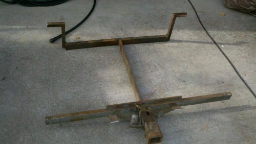

I may not have mentioned before that when I bought the car, we discovered a pretty hefty trailor hitch welded onto the frame, along with a pretty advanced looking tow system that I recently discovered is hydraulically connected to the master cylinder. We've since removed the trailer hitch, but will still need to remove the control under the dash along with the wiring and brass hose connected through the firewall to the brake system. Here's some video of the tow hitch removal, interior after cleaning, and wiring of the electronic fuel pump...
Cutting up the tumor after removing it from the frame. I'm sure she's happy to have it gone, and starting to feel like her old self...
Post surgery report... Here she is after removal of the trailer hitch. We tore the frame a bit knocking of the brackets that were welded on, but shouldn't be too hard to fix...

The tumor...
