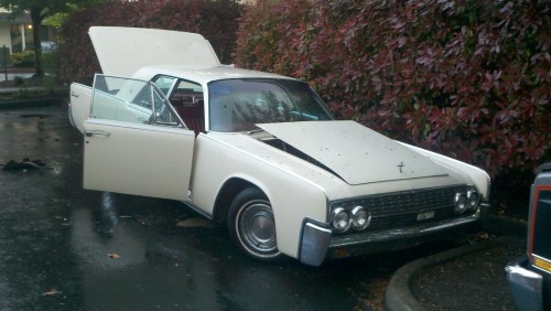

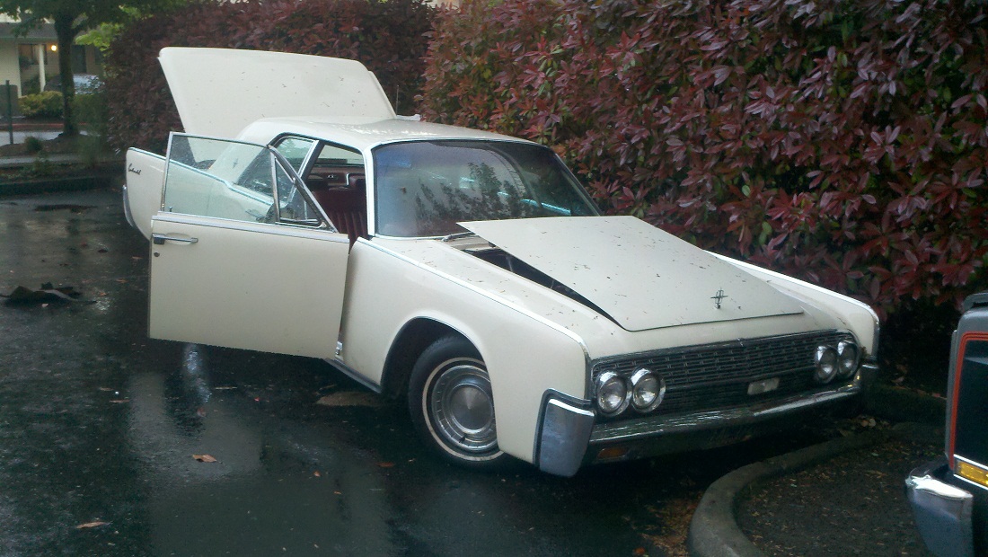

Here's a pic I snapped while attempting to bleed the brakes, although I've since taken off that goofy lookin' light on the grille.
Cheers...
