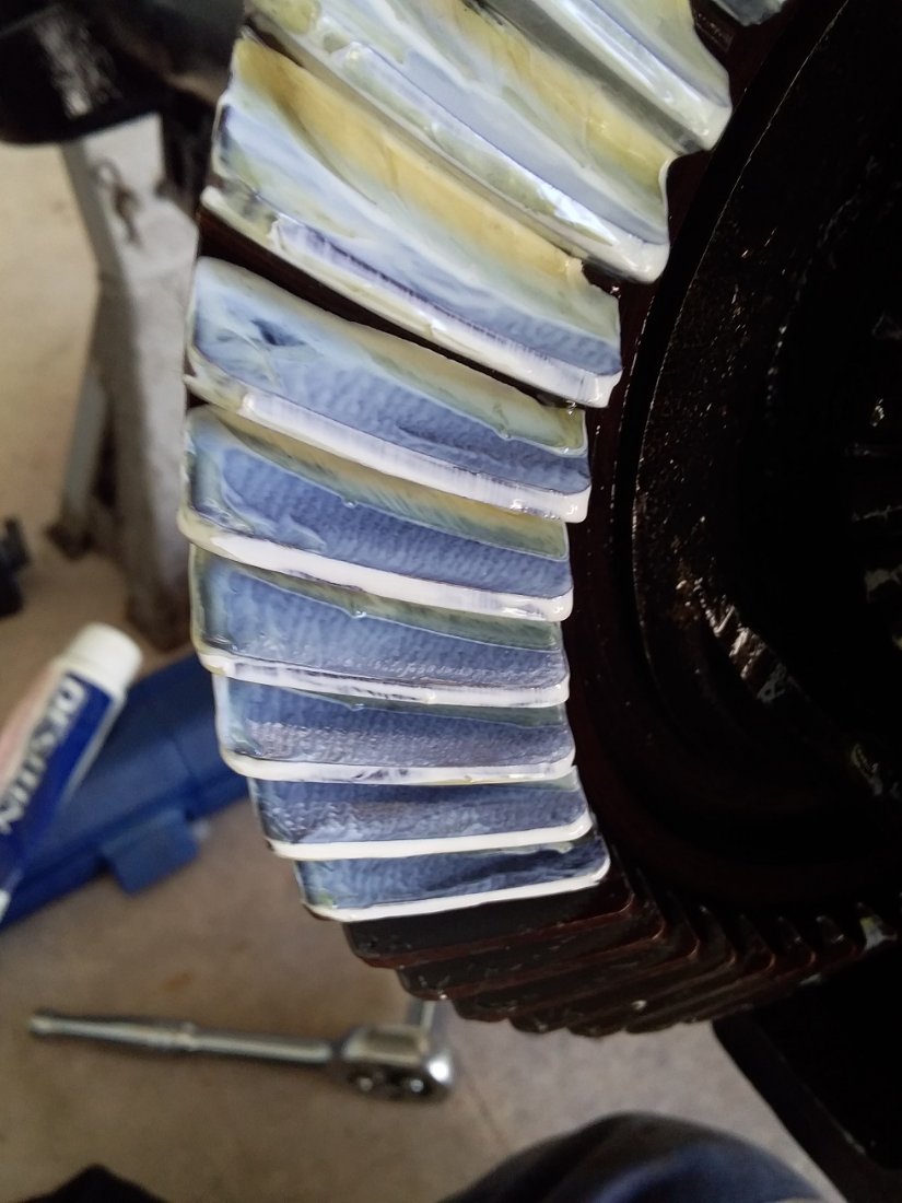

Post by novetti » Tue 10. Aug 2021, 05:04
Rear Differential Rebuild.
Gears were OK
Main Bearings OK
Replaced Axle Bearings and All Seals

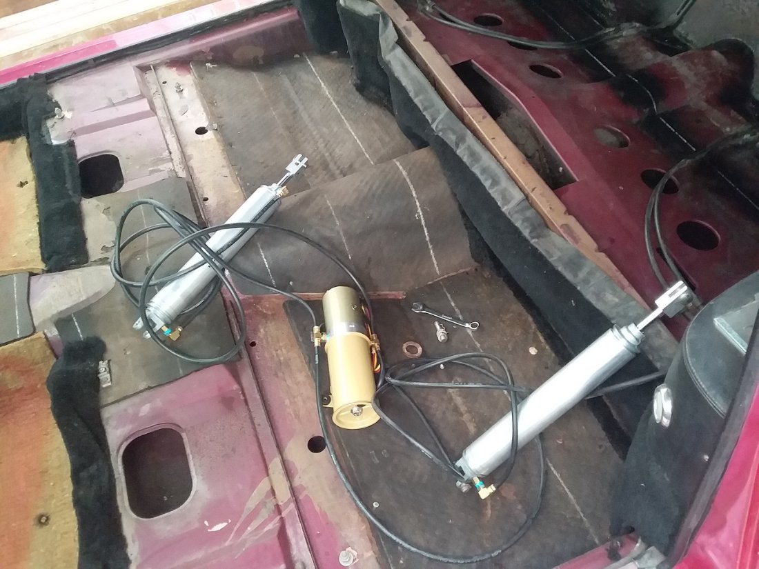

Post by novetti » Tue 10. Aug 2021, 05:09
Top had faulty switches
Rebuilt switches with JB weld - Bakelite was broken in a few places
Sewing 4 point logo to new top material (logo scavenged from the original top).

Post by novetti » Tue 10. Aug 2021, 05:11
Miscelaneous photos
New muffler system quieted the beast very well
Vehicle is on the ground on its wheels, need to bleed brakes
Waiting on new bling (Replaced bumpers) coming from the USA
Stay tuned for more. Sorry for the long delay posting updates.
