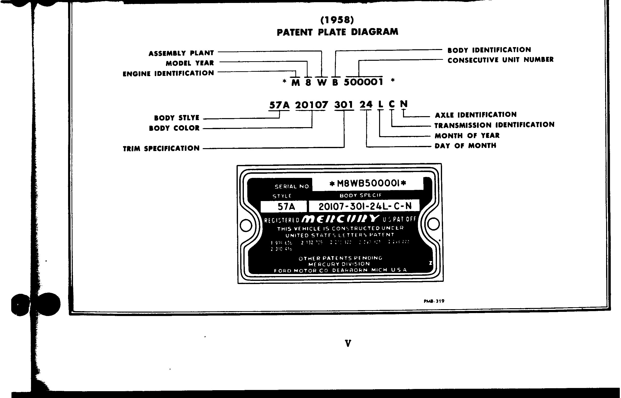

Hi, I'm hoping I could get a little help decoding my VIN off the title. I can't find any info online to explain it. I Should have the 430 ci engine with 4 barrel carb. iF it was a tripower super marauder it woud be a J code. Ok, What code should it be with the 4 barrel? may VIN is k8wg525984 Ive got body, trim color figured out but I'm guessing K is the code for the engine. Can't seem to find any info to verify. I have other numbers off vin plate and engine if it helps. Thanks
Re: 1958 Park Lane Phaeton, ID, Parts and Interchange
K=430 cu in.
8=Model Year
W= Assembly Plant (Wayne)
G=Body Type (Parklane Coupe/Sedan)
525984= consecutive unit number
If you have the other numbers for the plate I'll be happy to decode it for you.

Thanks for the rapid response. Ive been on the net for weeks trying to find that info. My next search will be to find out how early in the year the engine was built. Theres some good info on the forum so I'm hoping I'm not going to have as much trouble.

I did find some info on my codes but if its not to much trouble i can double stitch my findings.
body 63c color 7 45 07 trim dso date b13 tr-fn engine says 8 1 w: 1 and 5751091 manifold 81j head 018
IT looks like there may be R2-LF included in trim package thanks again. Bill
Hello Bill,
I'm sorry but could you please take a photo of the Patent plate. The numbers / letters do not sound correct. Just want to do my best to get you the correct info.
63C = Parklane Phaeton Coupe (1958 only)
74507 = Two Tone Upper and Lower Body Area Marble White, paint code 07 , while the roof and projectile areas are in contrast, Flamingo Red paint code 45. The prefix number 7 denotes that the projectile area is in contrast to the surrounding body color.
Trim = ?
Trim = ?
