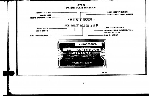

Hi, I'm hoping I could get a little help decoding my VIN off the title. I can't find any info online to explain it. I Should have the 430 ci engine with 4 barrel carb. iF it was a tripower super marauder it woud be a J code. Ok, What code should it be with the 4 barrel? may VIN is k8wg525984 Ive got body, trim color figured out but I'm guessing K is the code for the engine. Can't seem to find any info to verify. I have other numbers off vin plate and engine if it helps. Thanks

Post by Shelby#18 » Mon 22. Oct 2012, 13:45
K=430 cu in.
8=Model Year
W= Assembly Plant (Wayne)
G=Body Type (Parklane Coupe/Sedan)
525984= consecutive unit number
If you have the other numbers for the plate I'll be happy to decode it for you.

I did find some info on my codes but if its not to much trouble i can double stitch my findings.
body 63c color 7 45 07 trim dso date b13 tr-fn engine says 8 1 w: 1 and 5751091 manifold 81j head 018
IT looks like there may be R2-LF included in trim package thanks again. Bill

Post by Shelby#18 » Wed 24. Oct 2012, 14:38
Hello Bill,
I'm sorry but could you please take a photo of the Patent plate. The numbers / letters do not sound correct. Just want to do my best to get you the correct info.
63C = Parklane Phaeton Coupe (1958 only)
74507 = Two Tone Upper and Lower Body Area Marble White, paint code 07 , while the roof and projectile areas are in contrast, Flamingo Red paint code 45. The prefix number 7 denotes that the projectile area is in contrast to the surrounding body color.
Trim = ?
