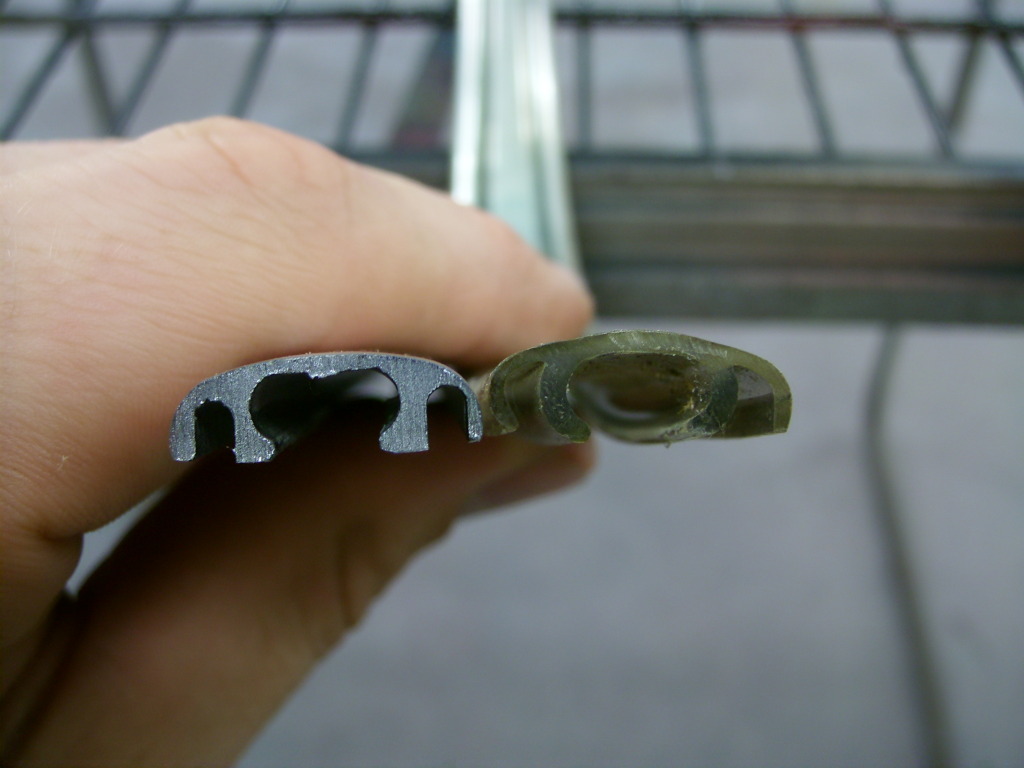

As you know some parts on these older cars are just about impossible to find. So what does a guy do but have new ones made. I am particularly excited about having the headliner bows remade. They were originally acrylic and just crumbled when taking them out. Only one bow came out of the car in one piece, and trying to find one anymore in one piece is near impossible. We know because we tried. ;) Gotta thank my restorers again for going the extra mile!
Here's some of the recent results.....By the way if you know of someone who needs bows, guess who had extras made... :mrgreen:
Headliner Bows (The test strips. Because of the lighting the colors don't look as close as they really are.) We'll have better photo's when the final version is completed.
Door Latch Springs
Again extras made, but I have another car going in after this one and I will need some.
