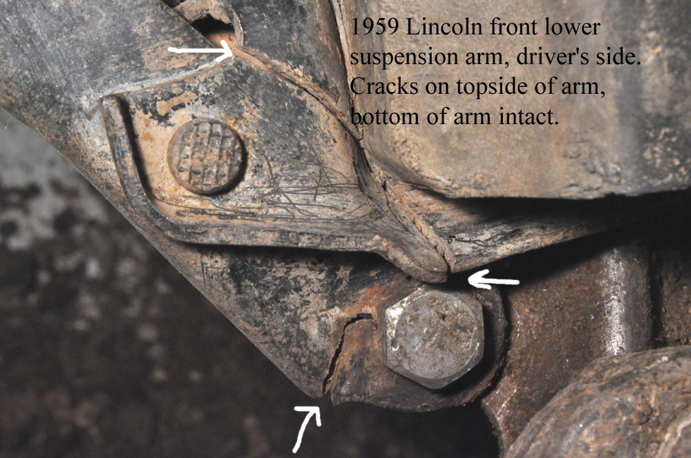

It didn't take much to get it running, but it ran poorly due to carburetor problems and vacuum leaks. I was able to drive it into the shop building for further work. I'm about to pull the engine and trans. At the minimum, it needs a valve job, new timing chain and gears, coolant diverters etc... I'll have the machine shop look further to see if a full rebuild is called for. I also found cracks on the front lower suspension arms, so I'll get those repaired and reinforced. I'll rebuild the front suspension while I'm at it. I have a fabricator building a custom stainless steel fuel tank for the car. Also planning on an Edelbrock 1406 to replace the tired Carter AFB.

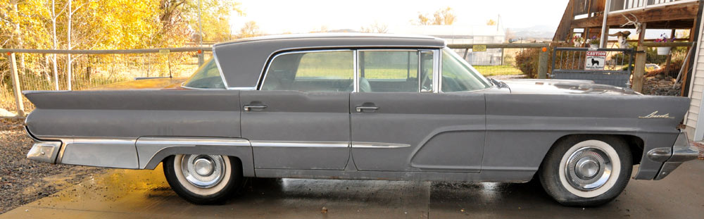

The body is basically straight and rust-free. A bad dent on the front bumper. The paint is original Warwick Gray and it polished up nicely although it's worn down to primer in spots. At a distance, it looks pretty good. :)

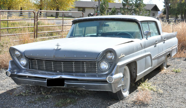

The car as found, sitting outdoors for 12 years
A little polishing compound and elbow grease brought some luster back to the paint
The front suspension will be totally rebuilt, addressing cracks in the lower control arms

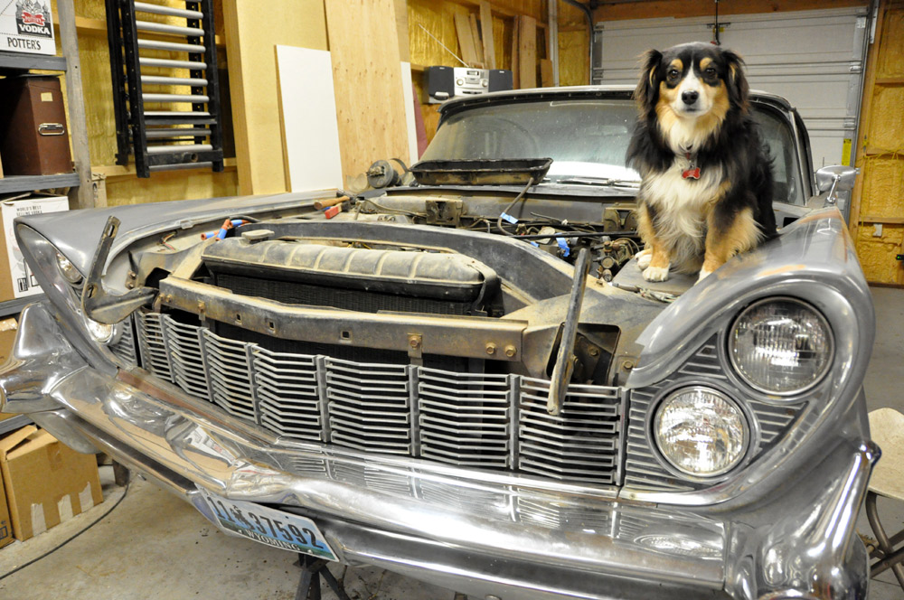

One of my three little helpers, Amiga.

Post by Theo » Wed 16. Aug 2017, 11:57
Love the dog ;)
