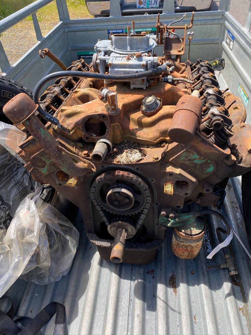

Ended up with a '67 462 and trans that was running and driving with a failing water pump.  The plan is to dress it like a '58 Edsel and use in a period 1964 Era Gasser.  On here to learn as much as possible about these cool engines!

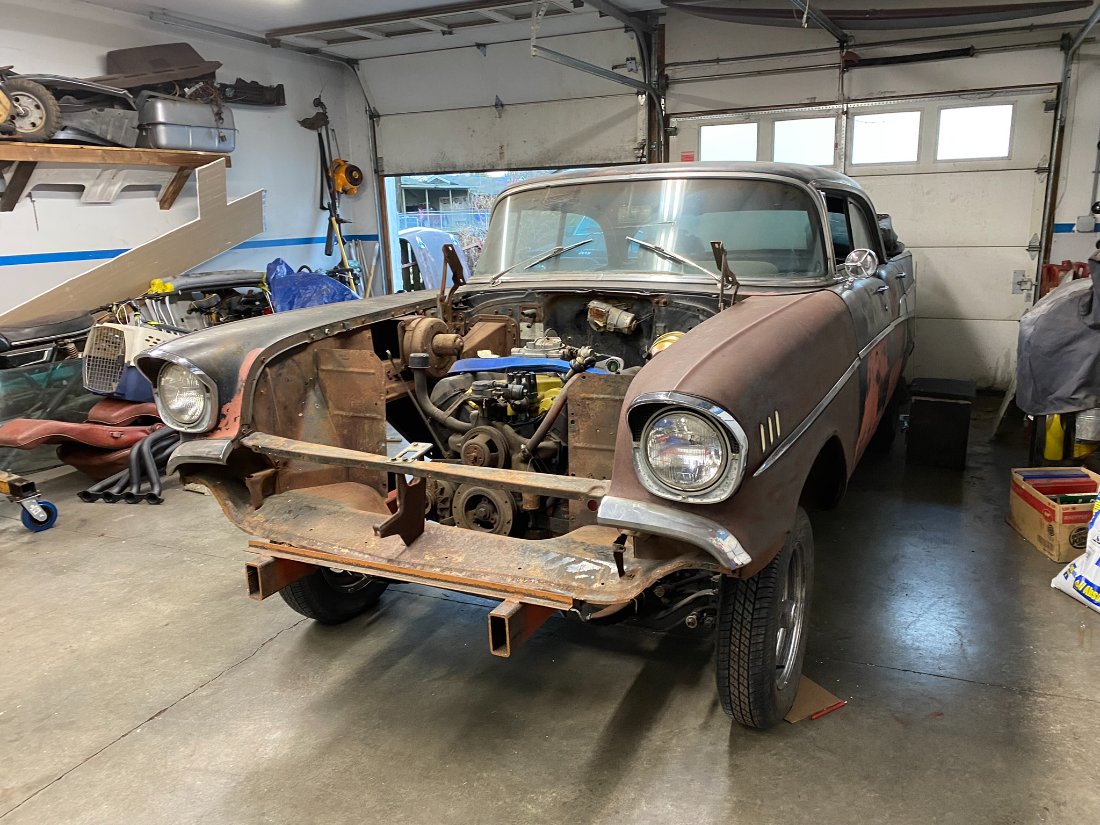

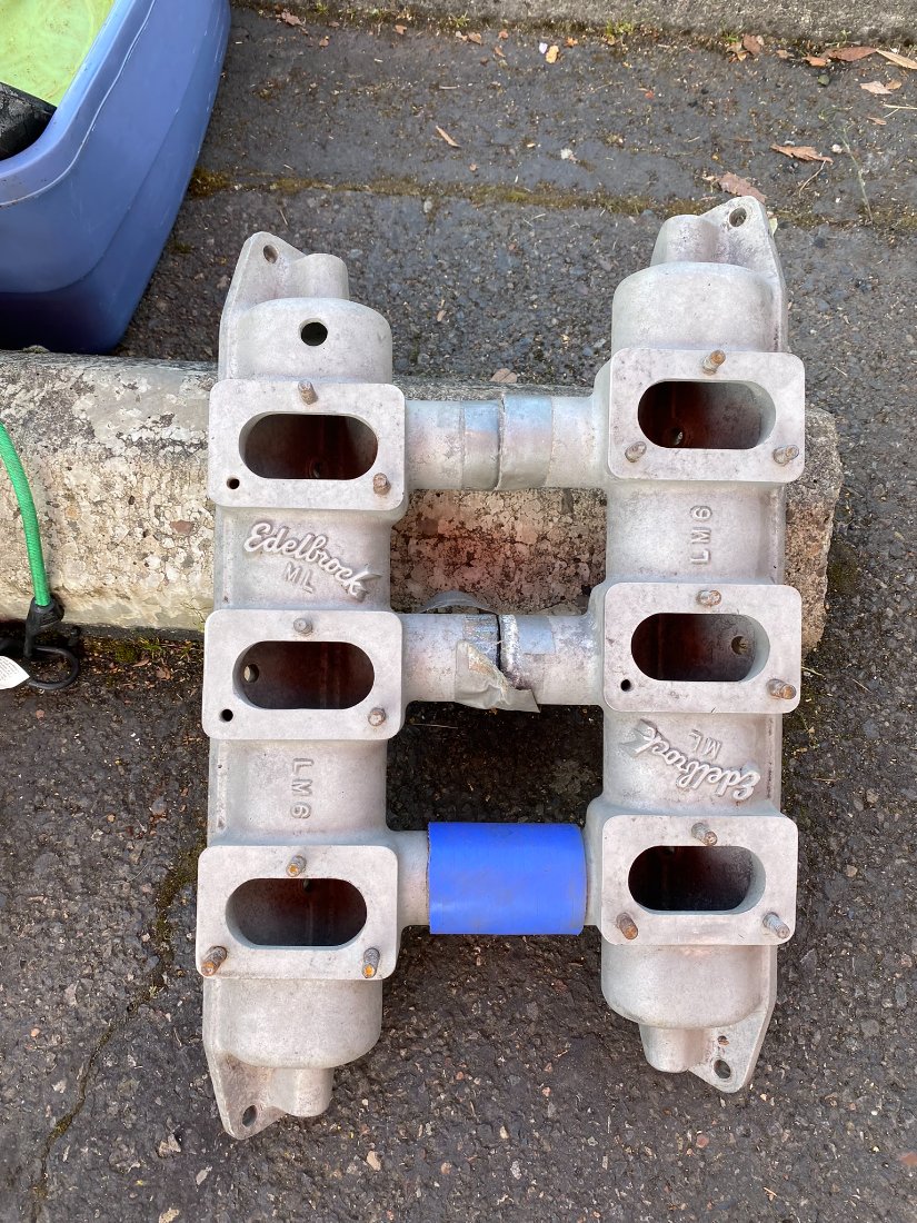

A little update since I have made some actual progress on the project.  Turns out the 462 I was sold is actually a C4VE that I believe to be a 1962 ish 430 Lincoln.  I have also a 1958 Edsel 410 that unfortunately the wrecking yard likely dropped after it was pulled and broke three of the ears on a head where the exhaust[img] bolts which really is unfortunate.  Then through looking for more parts I end up with a NOS C2VE Short Block with a FoMoCo tag.  Finally a bare block, extra crank, pistons and rods for a 1959-60 430.  Two Edsel tall four barrel intakes and one Lincoln low slung intakes.  Four bare heads, one Edsel head and the set on the hopefully runner engine.  One stripped distributor and one stuck in the block of the runner.  Hopefully I can figure out how to extricate that one at some point.  I have a new in box rebuilt water pump and two crunchy ones.  Three timing covers and two oil pans.  I am hoping enough parts to get one engine going and then start building a more powerful version for the future.  Slover machining in CA may be sending me adapter plates to run a BBF intake to adapt a super charger similar to David Frieburgers Tunnel Cram

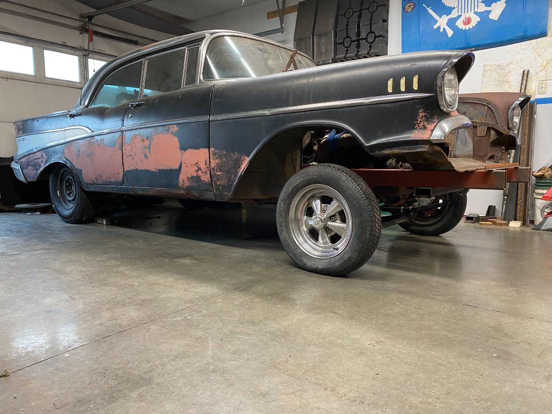

So the car this is going in is a 1957 Chevy that will be called "MEL-icious Intent"

All Ford company running gear with the only thing being GM will be the body and a portion of the frame.  Even early Mustang seats, ford steering box, radiator, 9", etc.
Waiting on header flanges from Headers by Ed out of MN. A scratch and dent PowerGen alternator is on its way as well. Pertronix will be going in the distributor. I have a rebuilt Holley 4 barrel for now until I can step up to more carburation.
