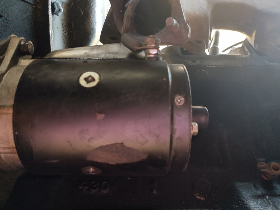

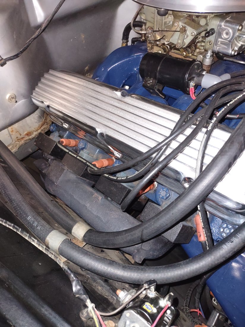

I have run both actually. I was using a 70's Motorcraft starter but found a good deal on a Powermaster unit and switched to that. Unfortunately, the Powermaster doesn't have any better clearance in this application than the OEM starter did. It just created it's own set of clearance issues and I'm still running the passenger side exhaust manifold spacers to clear the starter mounting position on the FE bellhousing.
The only way I see the mini-starter having a possible advantage is by using a center dump Mercury ramhorn style manifold and those are hard to come by in my experience. Going out on a limb, I think the FT bellhousing may have the starter in the same position as the MEL bellhousings since I've read about people swapping MELs into super duty trucks, but I could be mistaken.

I have the C2 castings as well but the passenger side has spacers between the manifold and head to clear the starter.
I can't imagine how it would work with the FE bellhousing otherwise.

I dug out some old parts and figured out why your starter side exhaust has a spacer. The B9 exhaust manifold I had dumped exactly like the C2 manifold. The difference is the 58-60 used the old style starter without the abendex. The old starter continued until 63 or so till the abendex hump appeard. With the starter already tucked closer to the block the newer style starter clears the 61-68 MEL engines. The motors are the same diameter.srm351 wrote: ↑Tue 30. Nov 2021, 12:50I have run both actually. I was using a 70's Motorcraft starter but found a good deal on a Powermaster unit and switched to that. Unfortunately, the Powermaster doesn't have any better clearance in this application than the OEM starter did. It just created it's own set of clearance issues and I'm still running the passenger side exhaust manifold spacers to clear the starter mounting position on the FE bellhousing.
