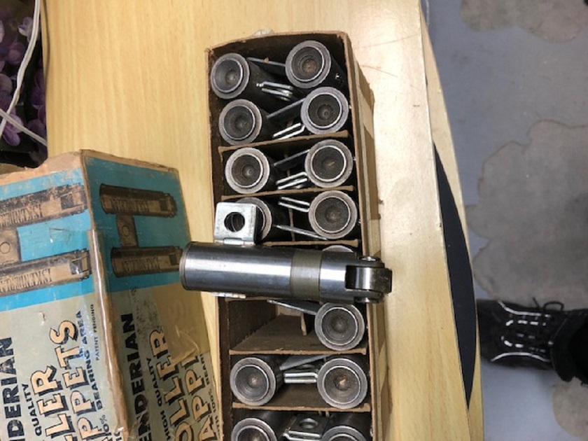

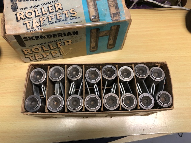

Thank you. Have Roller rockers and hardened shafts. Can't find any of the old Isky roller lifters, and I am waffling back and forth about running a roller cam. Might just get a solid lifter cam ground. Any info on roller lifters would be great. FE roller lifters do not work. They are not wide enough. TJR

Have a set of Isky Roller Lifters Solid , I was going to use them but not suitable for street use. Looking for hydraulic roller lifters. Also have a old Isky Roller Cam but lift and duration is too high. Trying to find the right specs to have it reground for street use.

If you wish to sell the roller lifters, I am interested. I am in California 209 609 9730. Tim reinarts
