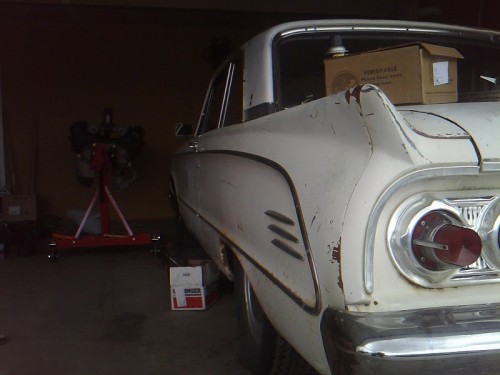

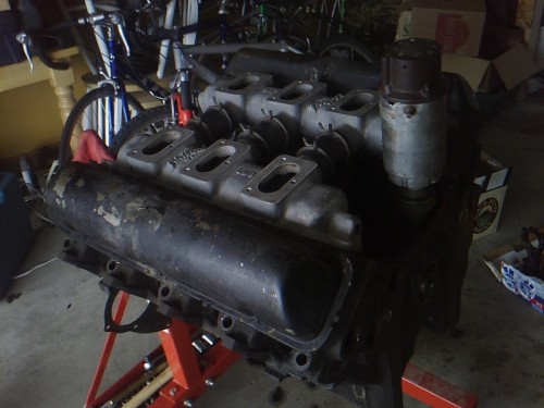

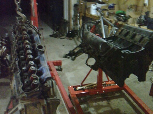

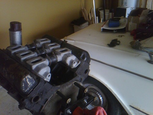

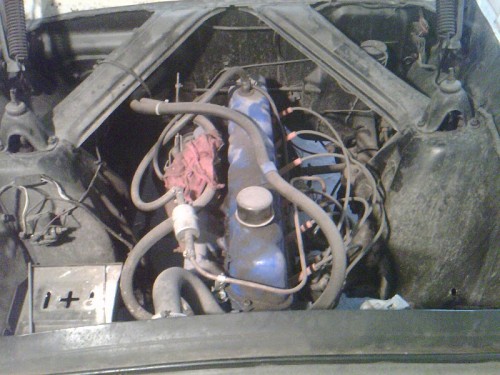

Sorry about the delay, been working on getting my '63 Galaxie on the road again for the trip down to Bonneville this year. Brakes and distibutor/carb tuning mostly...been lucky I guess.
As promised, I've found a few pics I've taken in the last few months so you guys can see just how big the hole I've dug for myself is!
- My grungy 430 'sorta' mocked up
- Next to the Comet
- The old 170ci inline 6
- Here they are, next to one another
- And, from behind
I've got the Econoline axle apart and ready to be shortened, with everything I need to rebuild it. Got my hands on a set of drag slicks, too. The Comet is gonna get it's sub-frame later this summer after I track down a rear end.
