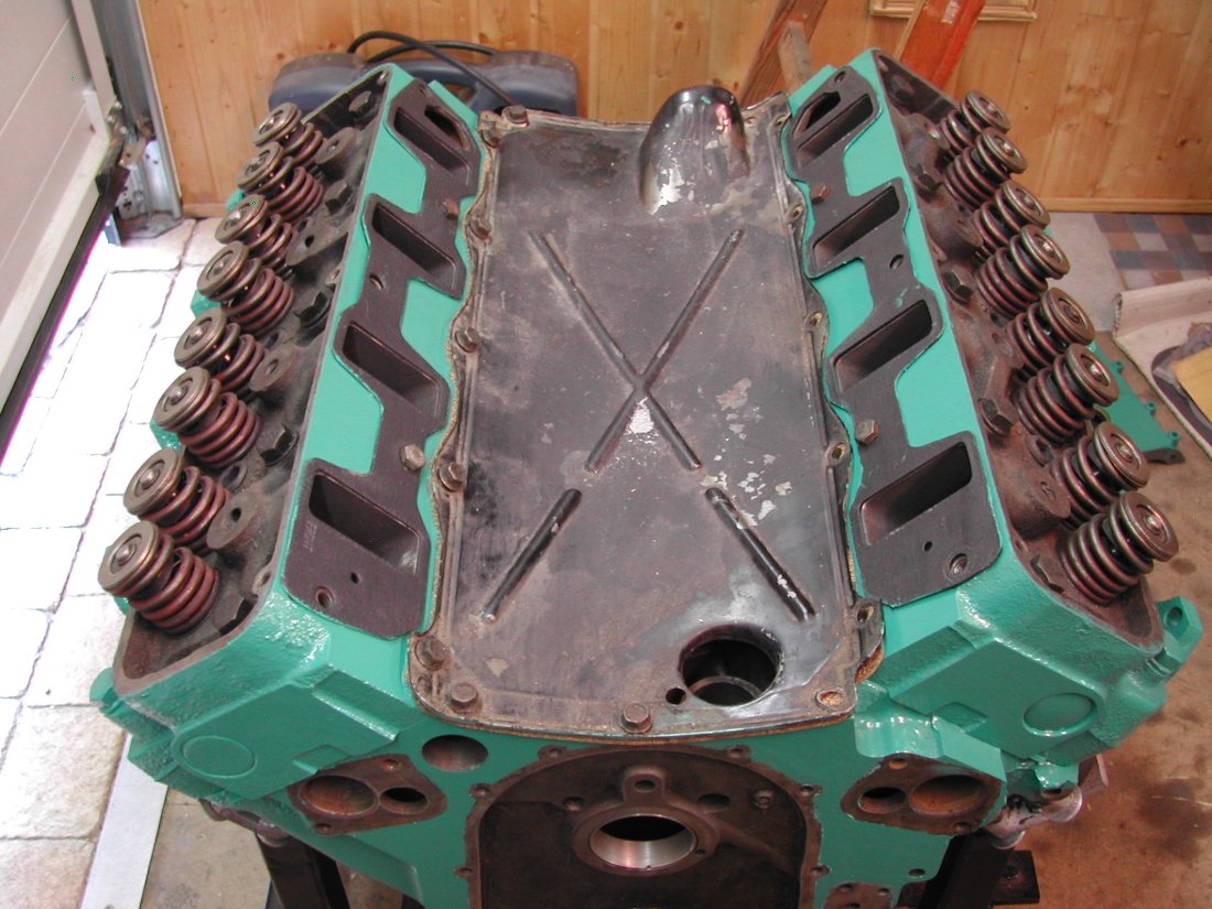

I´ve finally started to rebuild my early 1958 430 MEL engine. Its out of a 58 model Lincoln buildt in October 1957. Since I dont need it quickly done because I only have the engine (I dont have the Lincoln, or any car for this engine), and its the first time I try to rebuild an engine, its probably gonna take a while until its running again. I plan to restore it to stock specs, with 2 exceptions. Firstly I upgraded the stock distributor with a Pertronix transistor, and secondly the stock 4-barrell intake and carb will be replaced by a correct reproduction of the factory 1958 Super Marauder Tri Power system. I´ve already modified the distributor and bought the tri power system, and yes, it was expensive
Here are some pics of it during disassembly.
The early 1958 blocks, like mine, have a slightly lower deck height than the later 1958 to 1960 blocks (10.462" vs 10.482") and thus, the early engines have a higher compression ratio (10.5 : 1 vs 10.0 : 1).
The early 1958 heads are also slightly different than the later 1958 to 1960 heads. The early ones have very large 2.80" x 1.30" intake ports and 2.15" intake valves, the later ones have still large 2.70" x 1.30" intake ports and 2.09" intake valves. But there are no differences on the exhaust side, as the port size stayed at 1,90" x 1,23" and the valve size stayed at 1,78".
I´ll update this post with more photos as the work continues.
