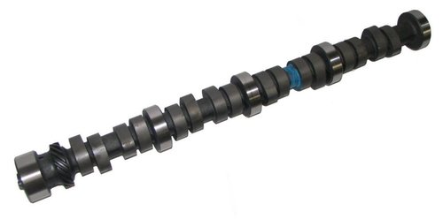

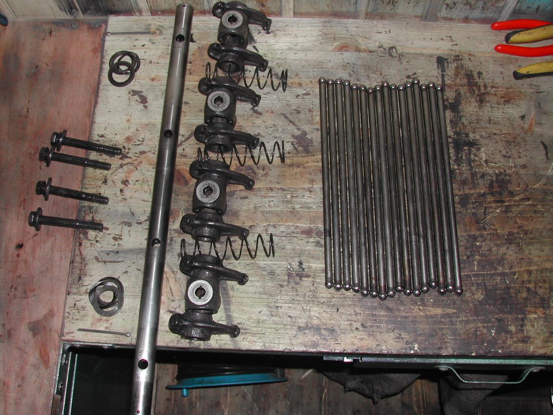

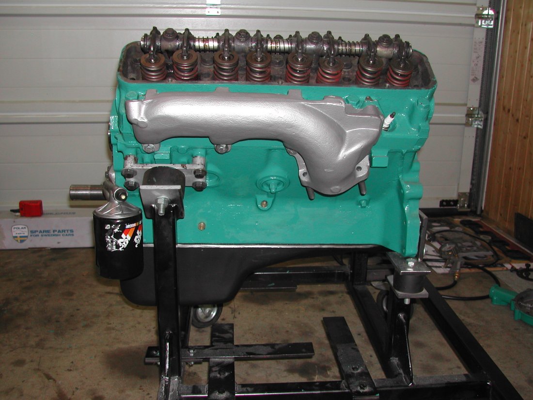

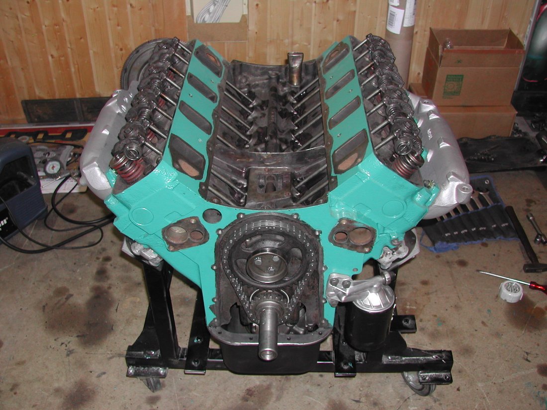

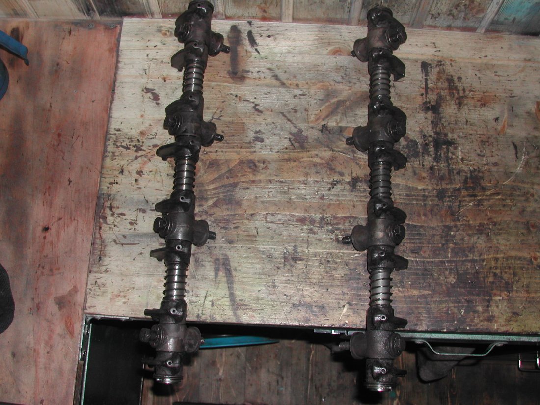

After searching for a good camshaft for a long time, i´ve finally found a good one!
The cam is Falcon Performance #CM-184, a new reproduction of a stock cam, at least they say so. I couldn´t measure its duration, but i measured the valve lift at about 0.440", so its probably a reproduction of the early style stock cam i was looking for.

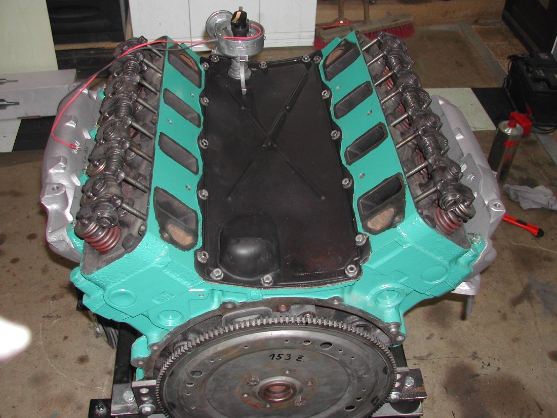

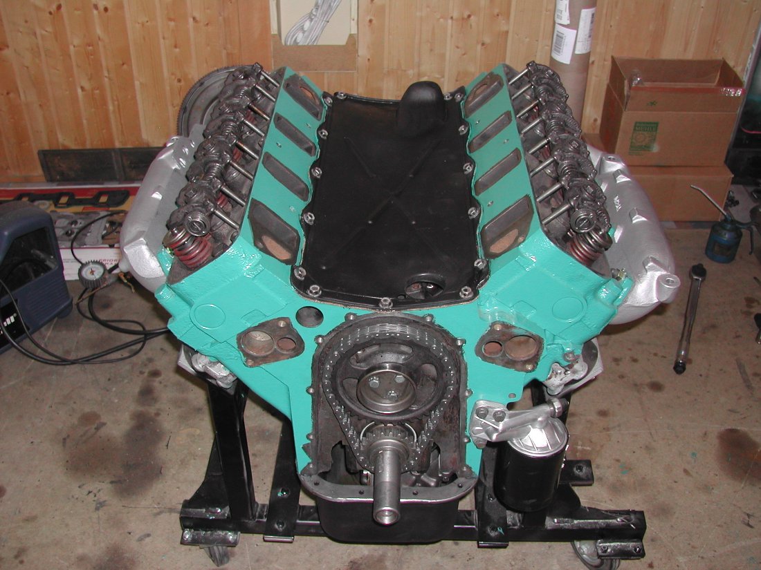

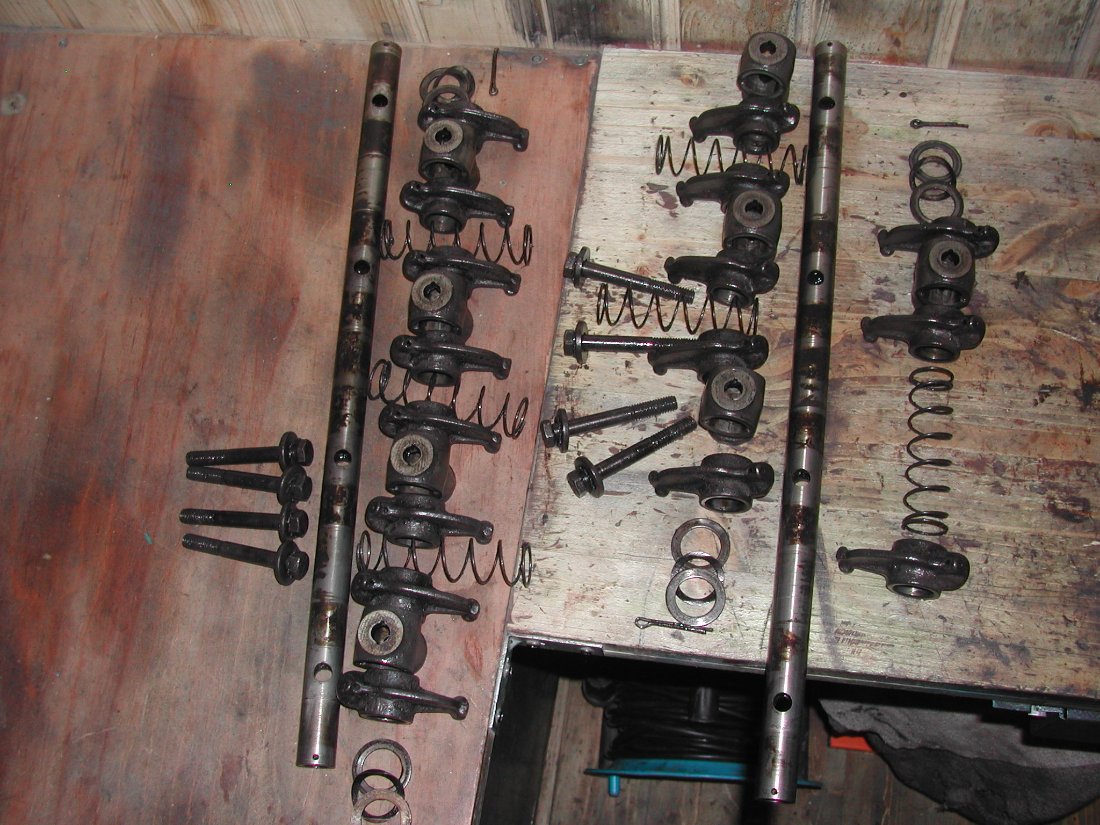

After I installed the new cam, valve lifters and timing chain, I disassembled both rocker shafts. I guess they´ve never been serviced and the dirty, muddy scab on them was 60 years old.
I cleaned and inspected them, wich was a good thing, because some oil passages were almost full of crap. I also cleaned all 16 pushrods.

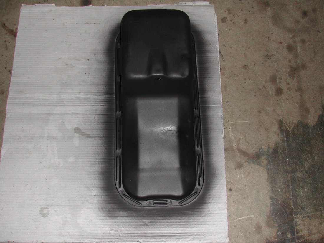

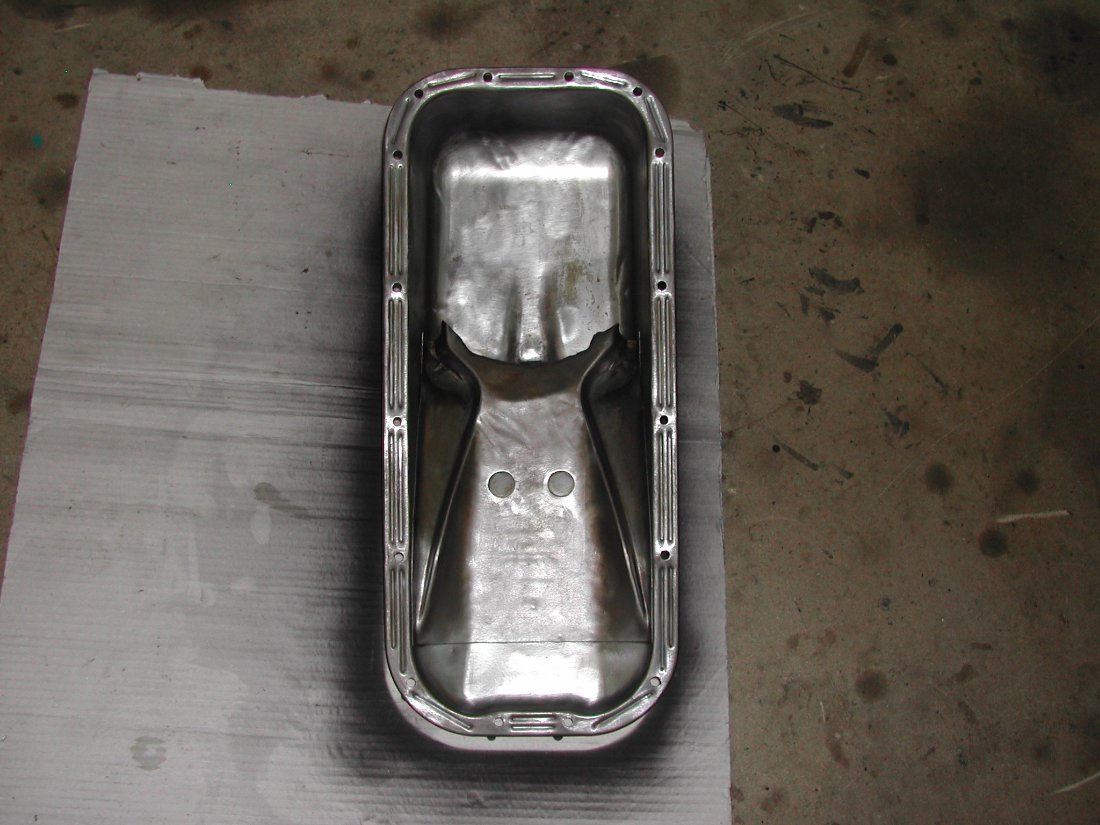

I also cleaned and painted the oil pan and refurbished the oil pump with a rebuild kit.
The valve train and oiling system are complete again.

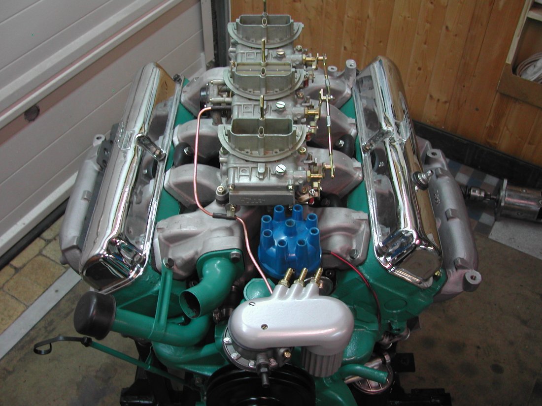

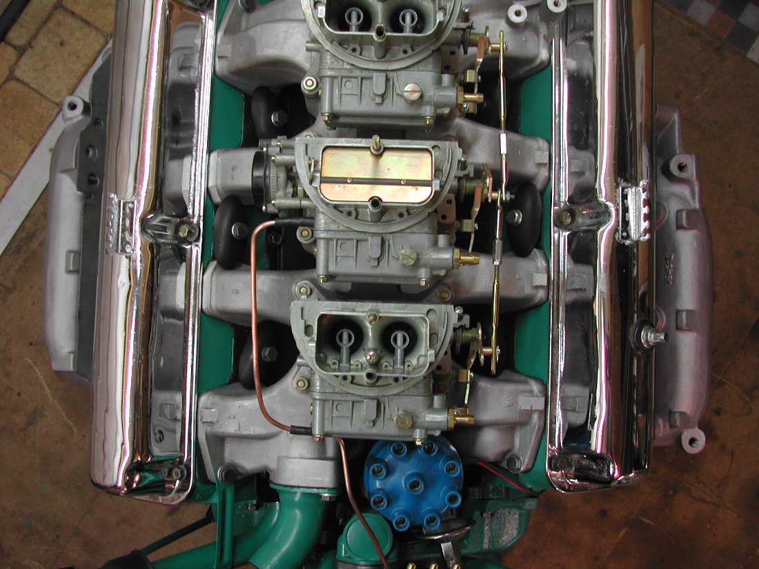

Post by RocketdyneF1 » Fri 23. Mar 2018, 14:02

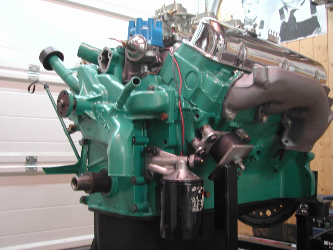

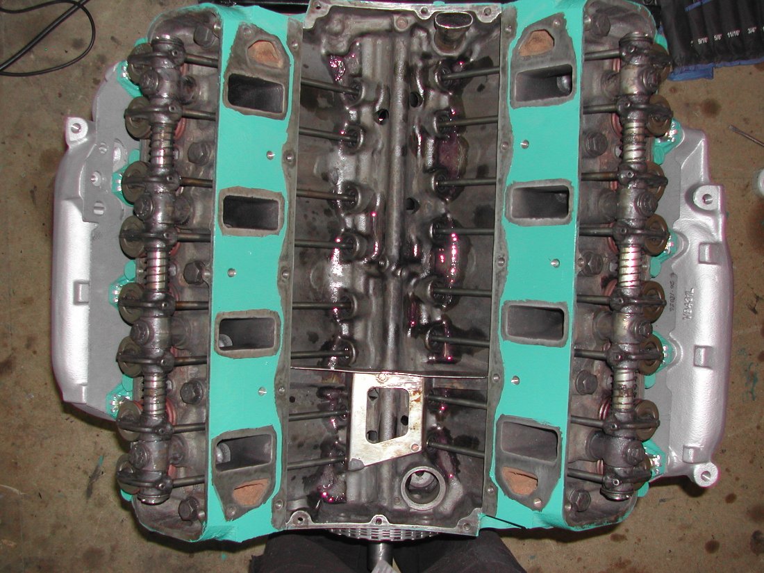

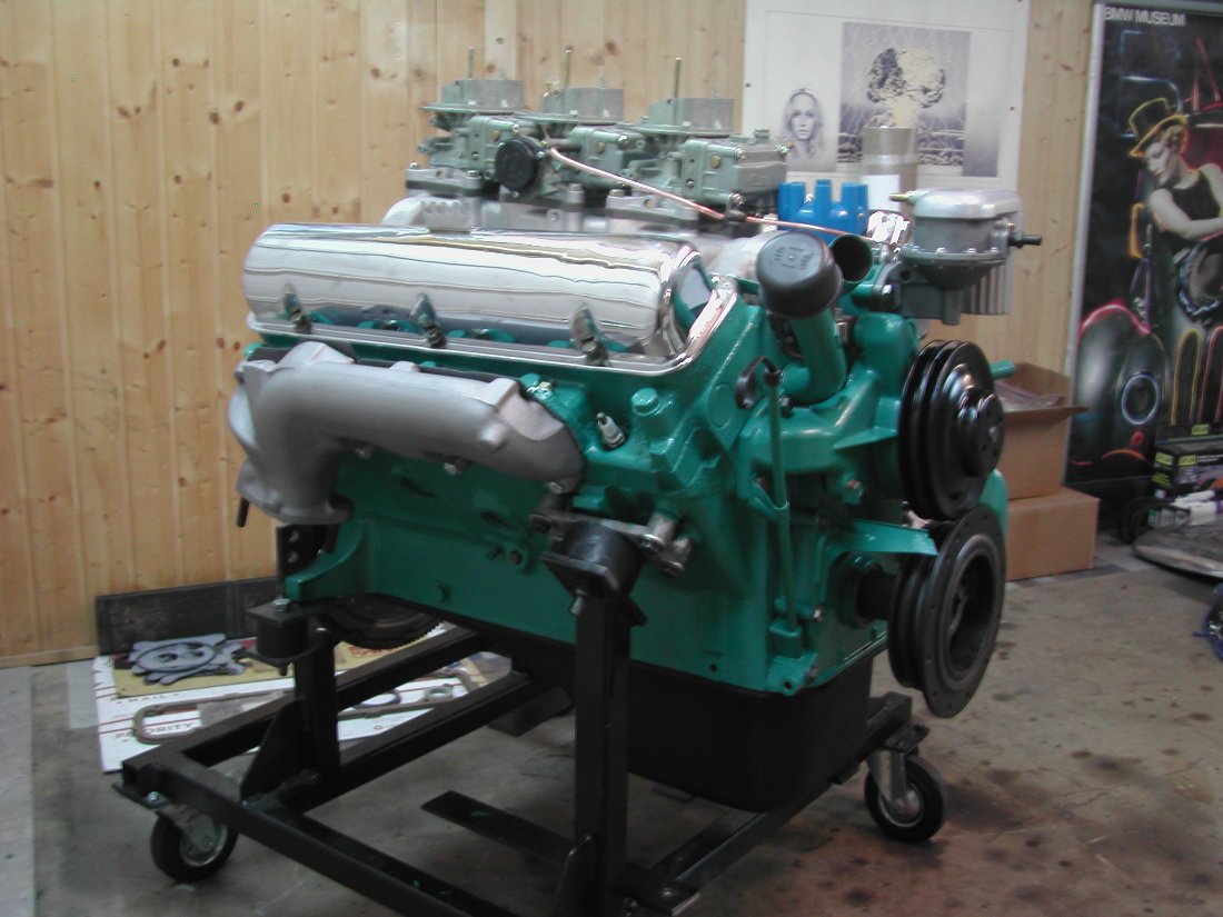

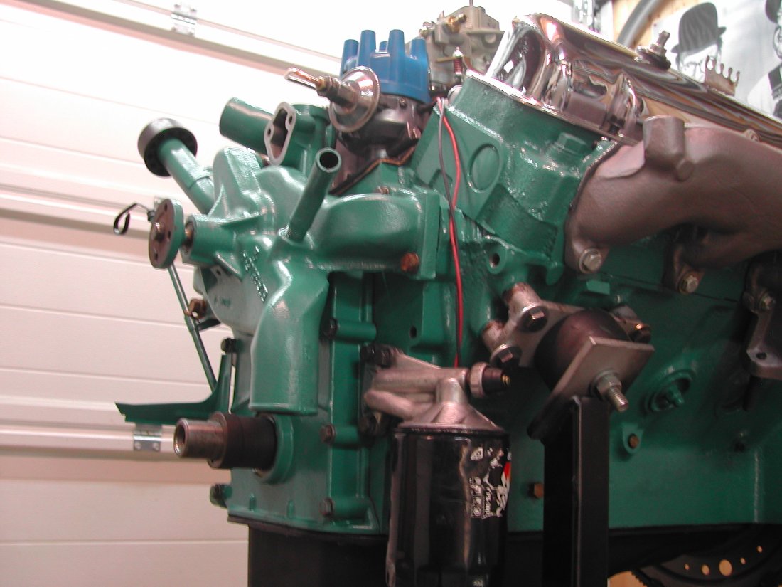

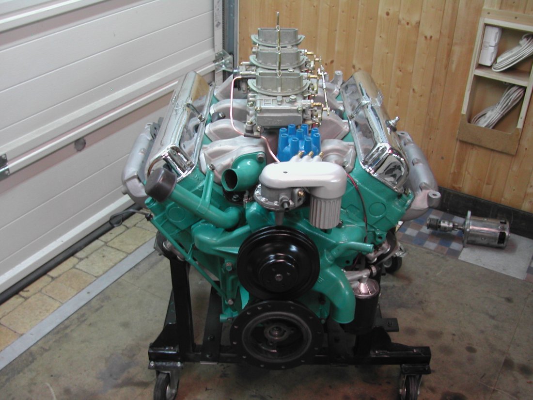

Today I assembled the valley pan, ignition distributor, timing chain cover with fuel pump pushrod, flywheel, valve covers and the Tri Power system. Finally it looks like an engine!

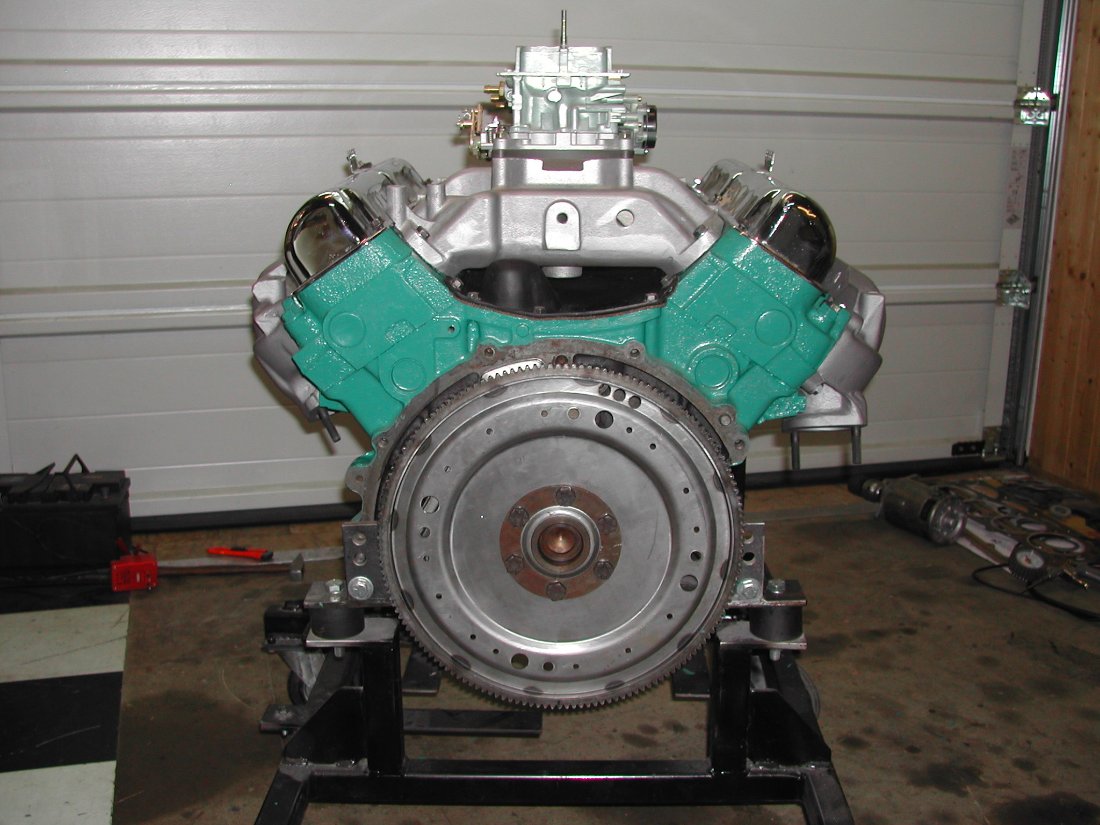

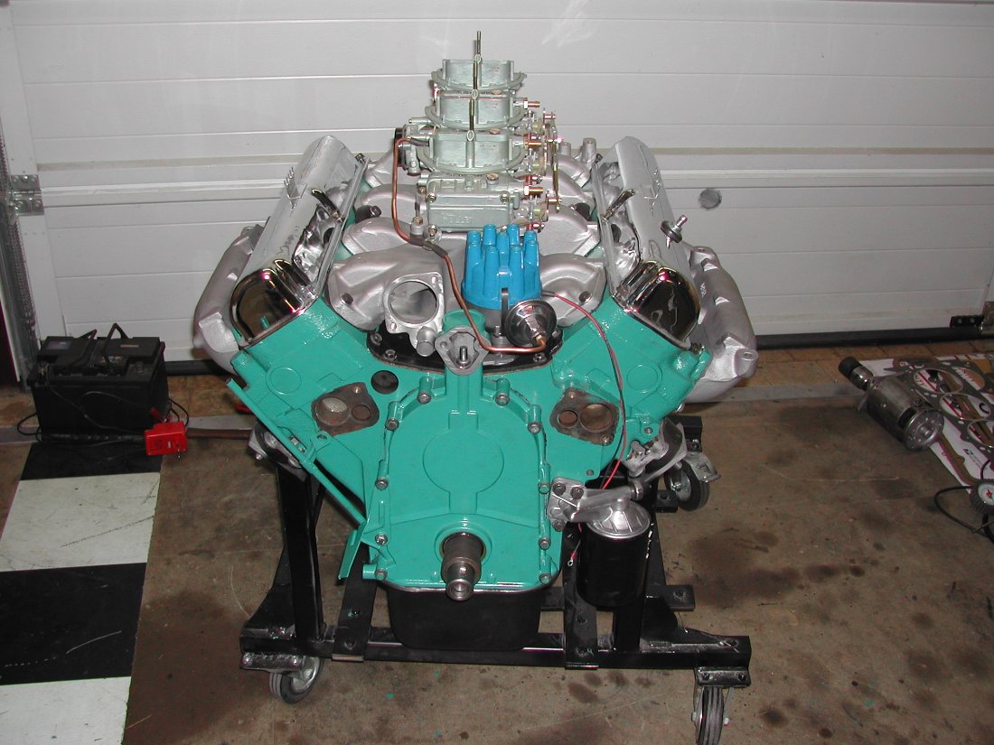

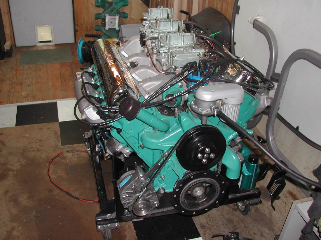

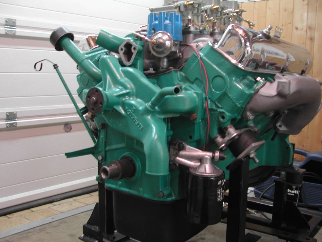

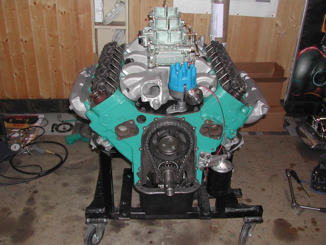

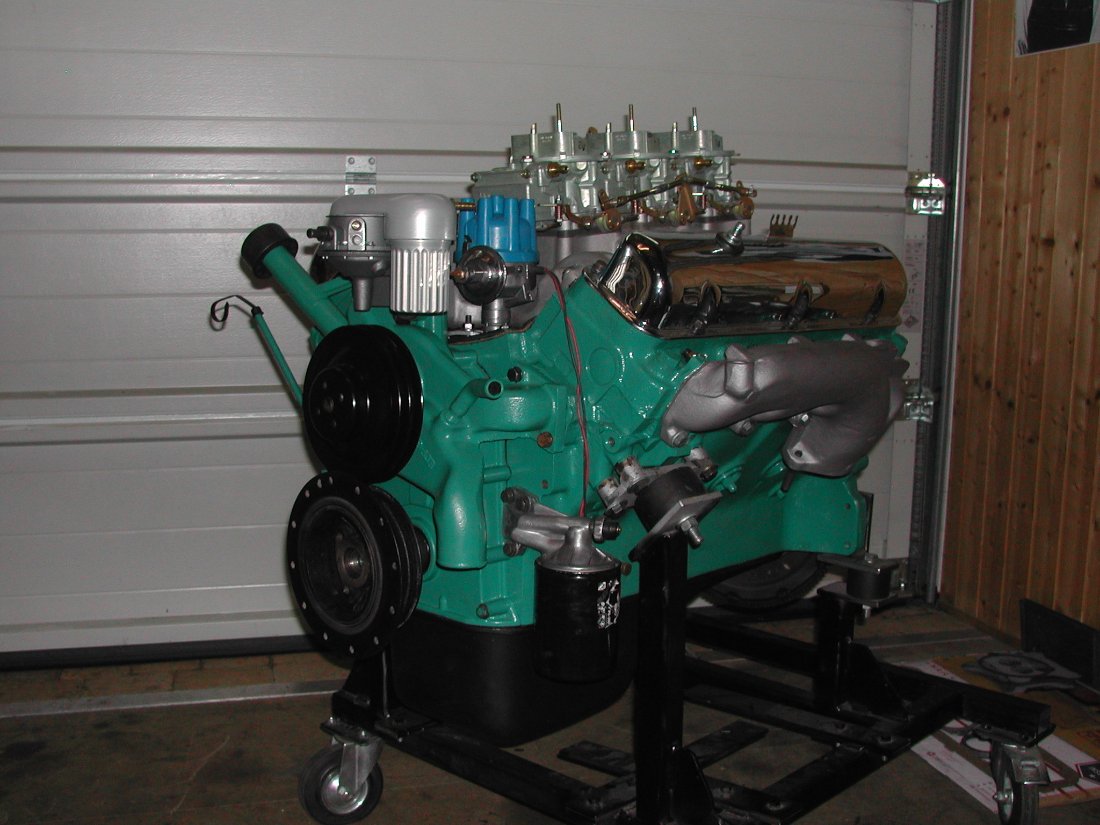

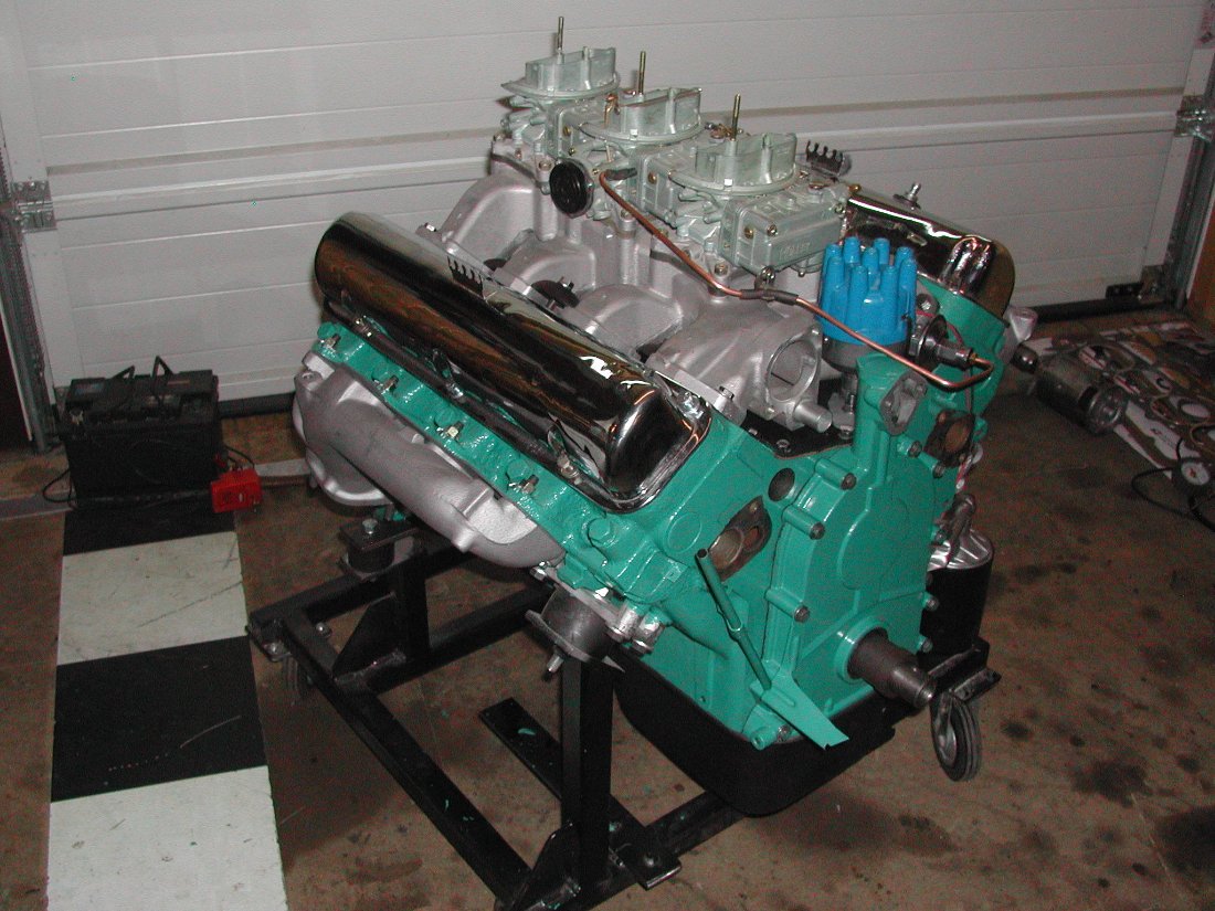

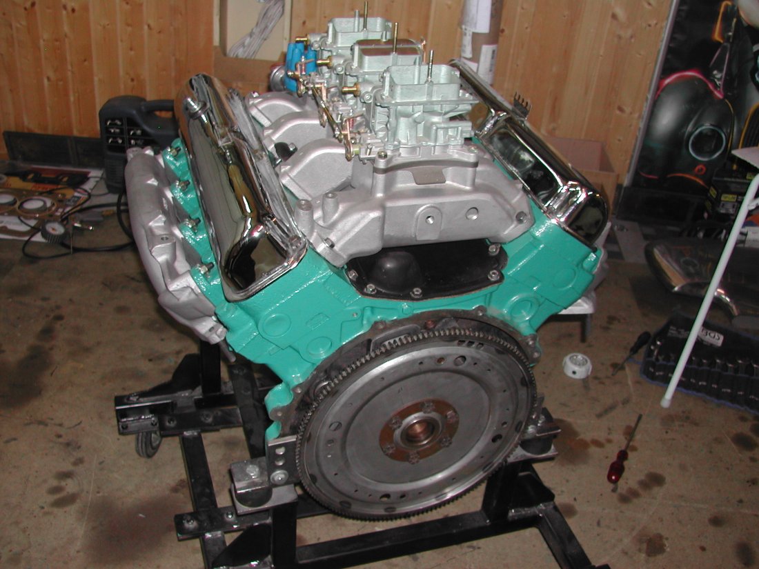

Post by RocketdyneF1 » Sat 24. Mar 2018, 15:08

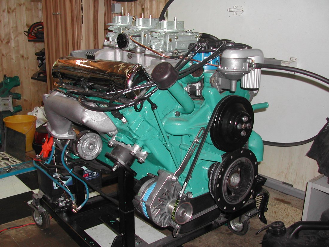

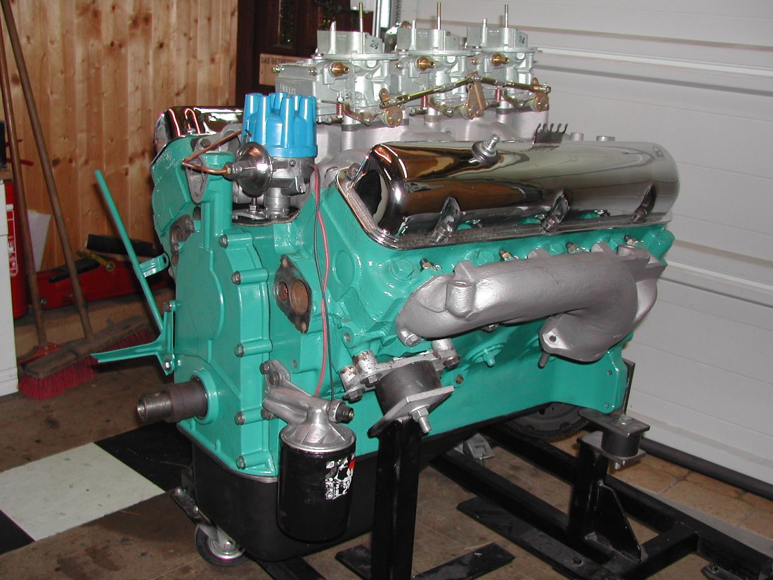

A few more pics of the progress:
I hope I can start it up soon!

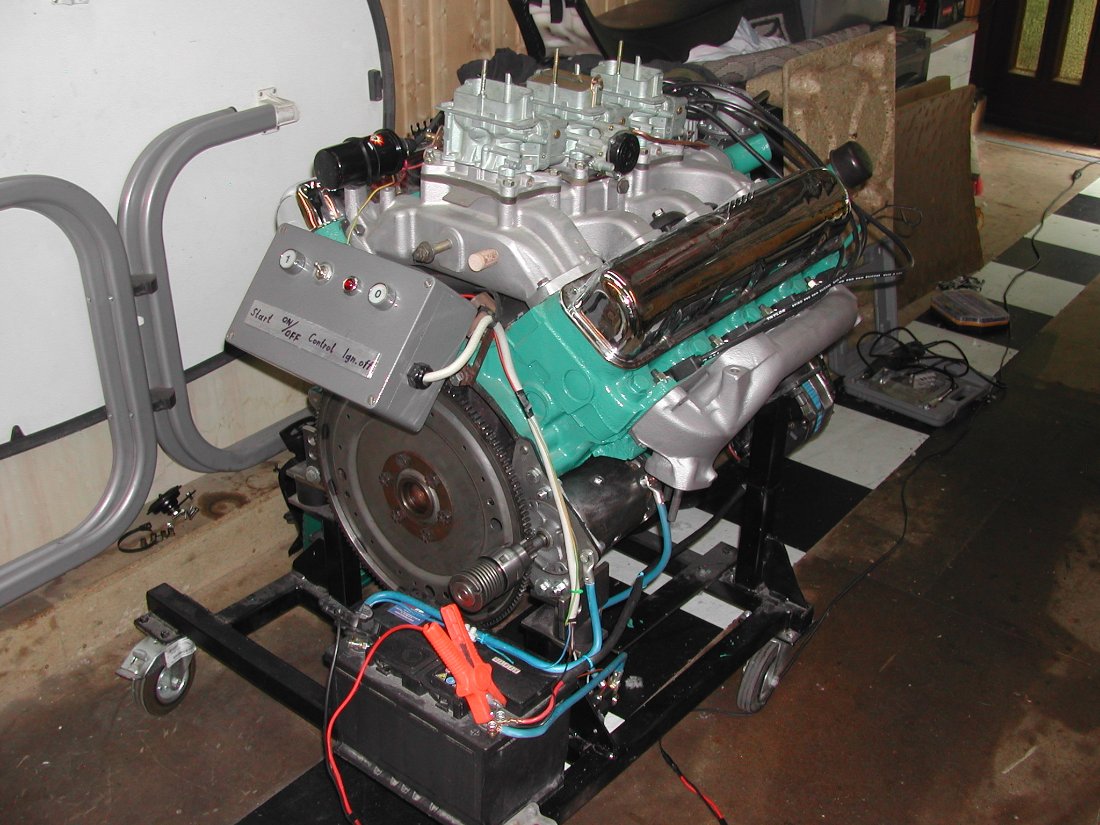

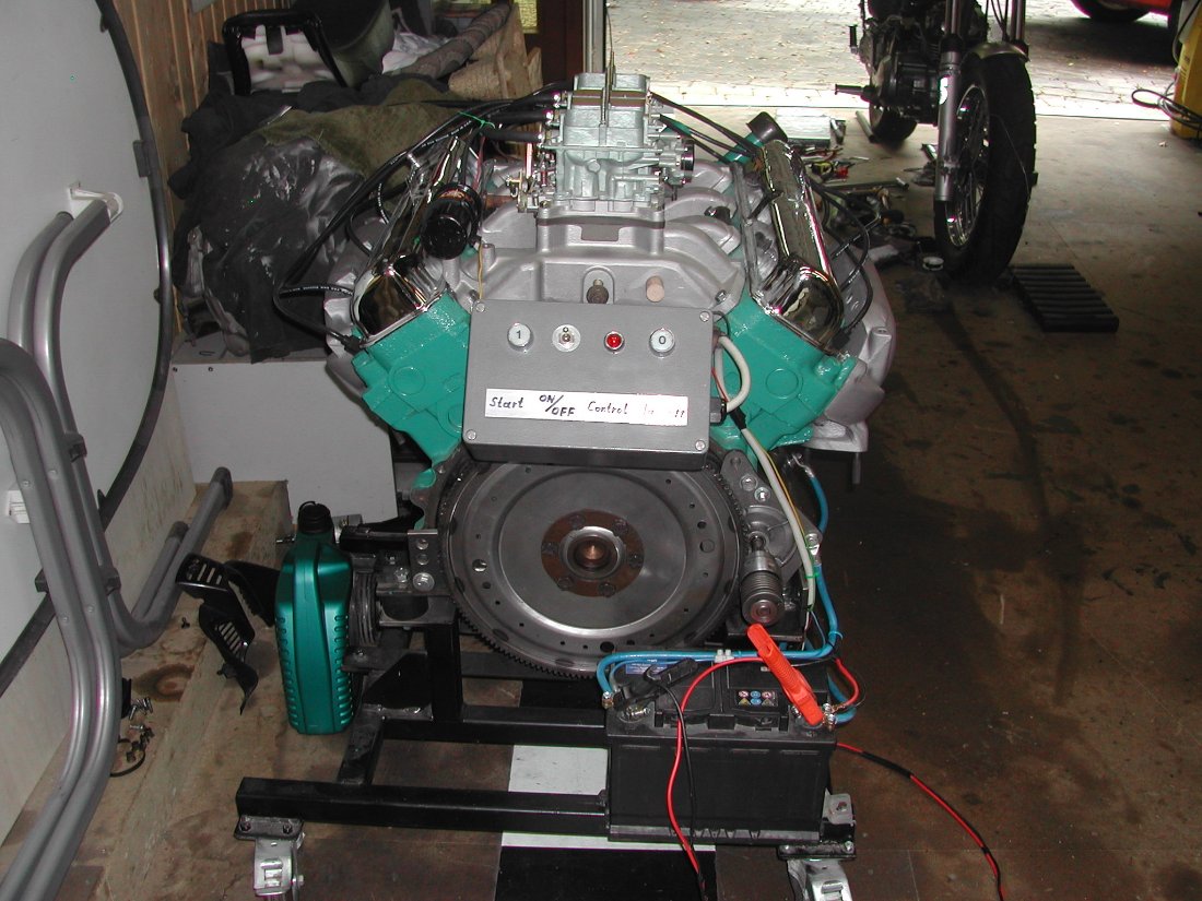

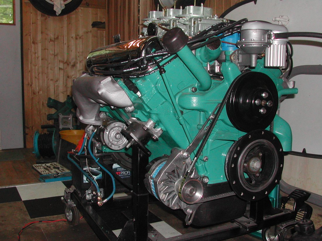

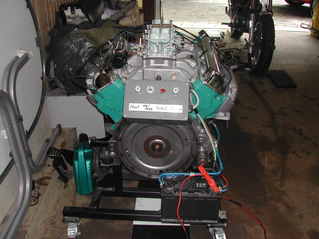

Post by RocketdyneF1 » Thu 17. May 2018, 05:34
Today, I finally started up the engine for the first time in years. It only ran for a few seconds, but damn, it has a really loud and brutal sound! No wonder, it has absolutley no exhaust system on it except for the manifolds. I also havent bought a radiator and cooling fan for it yet, so I cant let it run for longer periods of time. I´ll post a video of it running when I am done tuning the carbs and ignition, and the cooling system is complete.
