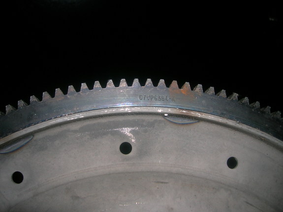

:?: Hi! Need to replace the flex plate on my 66 Lincoln with a 462 eng(worn ring gear) . Would like to know if a 460 flex plate would fit? Or does it have to be specific to a 462? Thanks.

I don't think it will as it's a totally different motor. I found this replacement part for the flywheel flex plate & ring gear assembly on eBay for only $30. It's not the original part but it fits properly.
