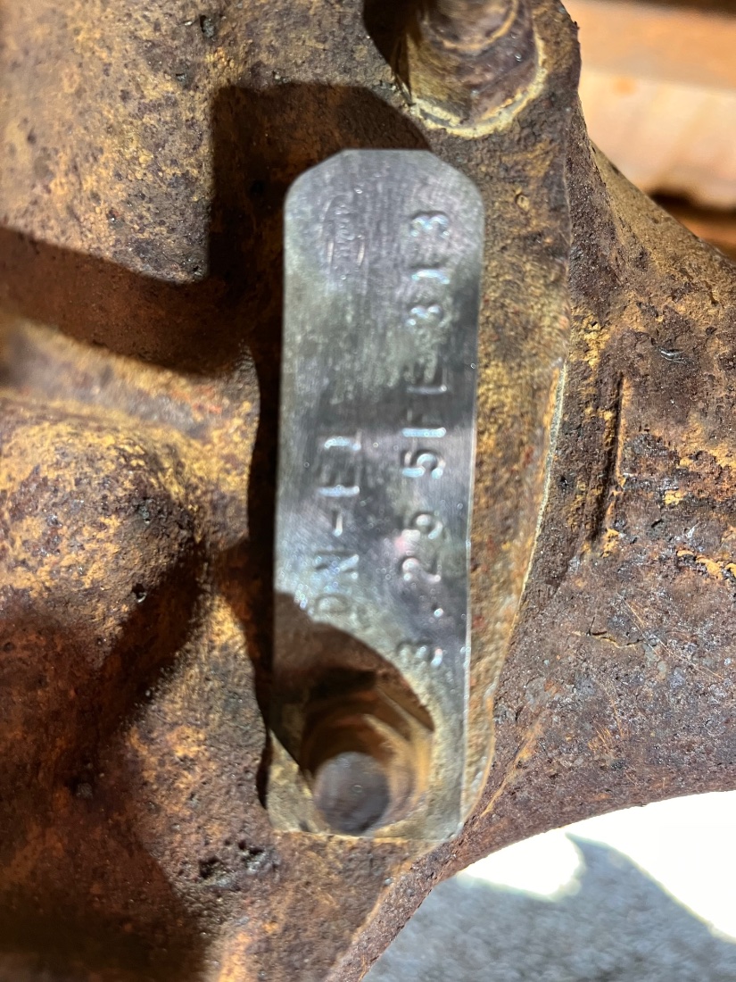

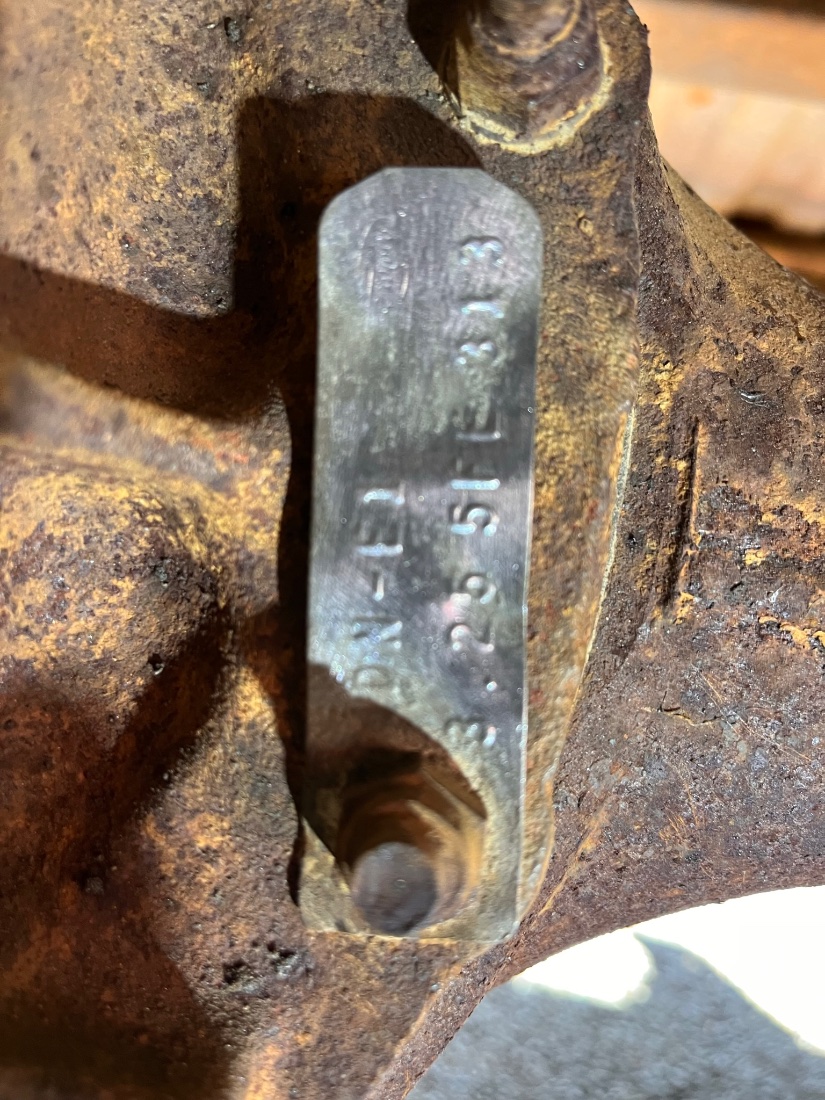

Hi Chris, thanks for the help… I hope to
pull the column soon and see what’s going on… I believe this truck came with a 3.25:1 rear it still has the tag on it… I think it’s the perfect ratio, since the truck cruises around 1600 or 1700 rpm in OD on the highway…. I tried to attach an image of the rear tag…. I hope it’s visible.
MIKE
