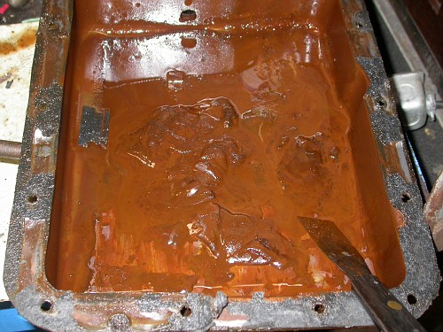

Remove the down tube retaining nut and let the fluid drain.

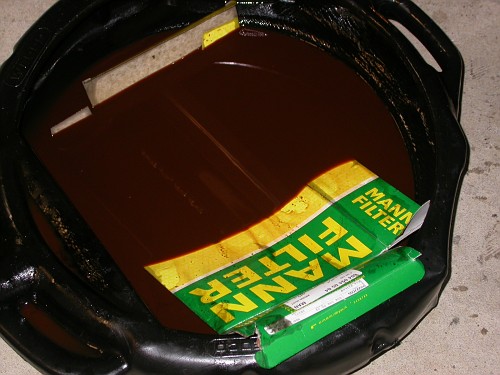

Remove all the bolts except for two opposite the down tube fitting . Position the drain pan below and slowly remove the last two tipping the pan down. You need a 6 quart drain pan.
You can also use an old trash can lid with a hole in the middle place it over a small drain pan.

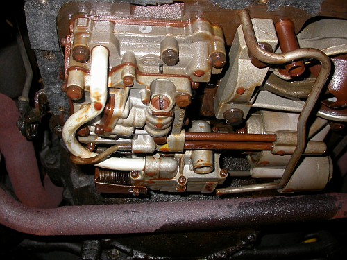

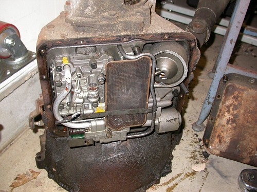

This is the Valve body assembly ..Looks like a little coolant in here as well...

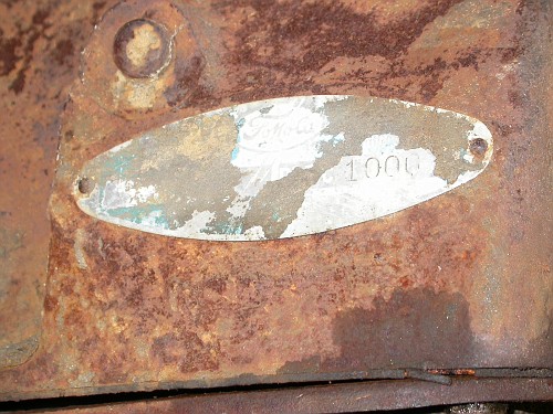

This is the ID tag found on the driver side ...It reads Model PBB This is the large case unit.

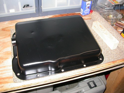

Now you can strighten up the pan and paint it ...I cleaned and reused the filter and made my own gasket.

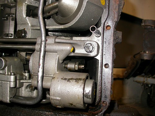

You can make a 1/4 inch spacer to fit between the servo and the adjustment screw shown here. Back off the lock nut back off adjustment screw. Insert the spacer between the piston stem and the adjusting screw. Tighten the screw snug, not tight! Then back off the screw 1 full turn. Then hold the adjusting screw stationary and tighten the lock nut. Remove the gauge block. The front band is now set.

Great post on the fluid/filter change proceedure. The trans with the rust in the pan looks like it is still in the car. Is this a transmission that was running o-k? With the moisture intrusion, it is likely that the valves in the valve body can get stuck from rust build up. Also, the clutch and band material tends to degrade and flake apart when the trans is run with water in it----unless it has brass clutches. I'm curious on how well this trans performs despite the water intrusion.
Hey, one thing I like to do is throw a couple small magnets in the pan to hold down any fine metal debris that would otherwise be circulating around with the fluid. Most modern transmissions have magnets in the pan from the factory.

Actually as nasty as the fluid was, the transmission is working just fine .........As you can see I have several in stock.
I'm not ready to do the trans as yet .... Ill do the engine and trans all at once ....
