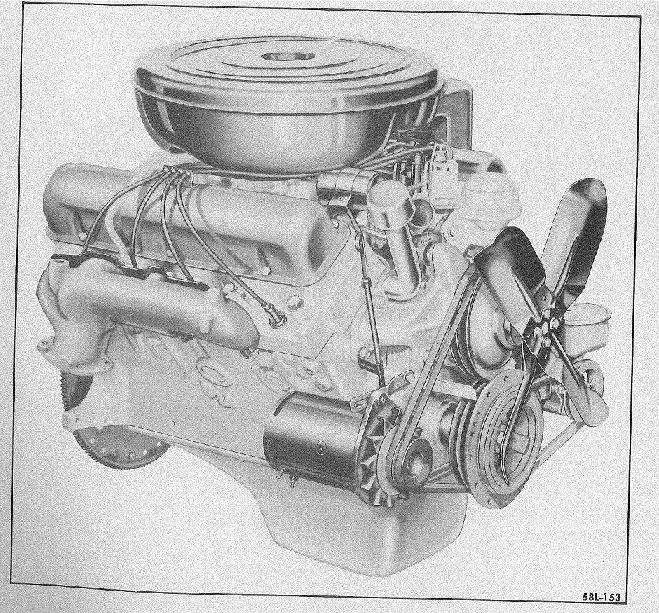

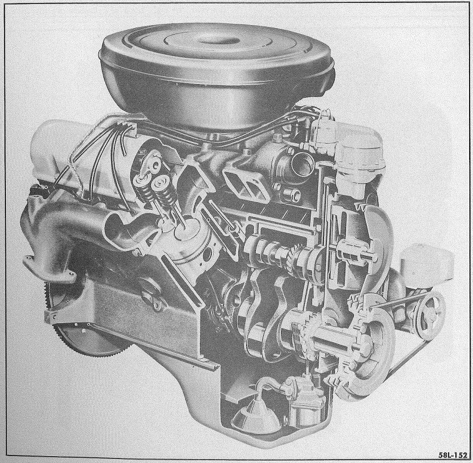

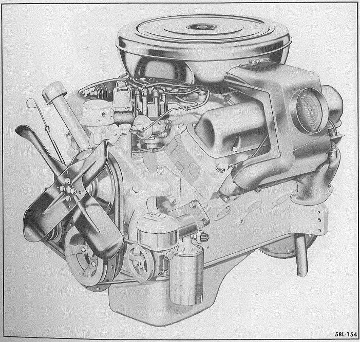

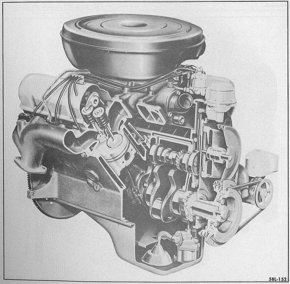

Some early 430 Lincoln images. These came from the Advance Service Manual- Sept. 1957. Will be adding some more interesting items in the near future.
