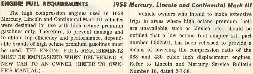

The changes primarily came about from issues regarding fuel detonation and rough idle. The factory service bulletins discuss the issues and stressed the importance of using a high octane fuel and keeping the timing and idle adjusted correctly. There was also an early issue with defective gas tanks causing clogged fuel lines or filters. Some older restorers have also told me their belief that Lincolns were only affordable to the older, wealthier crowd who typically did not drive them hard enough to clean out the engine deposits and other buildup. Bad gas tanks, bad gas, elderly drivers...

#14 1-24-58
#18 2-21-58
#16 2-7-58

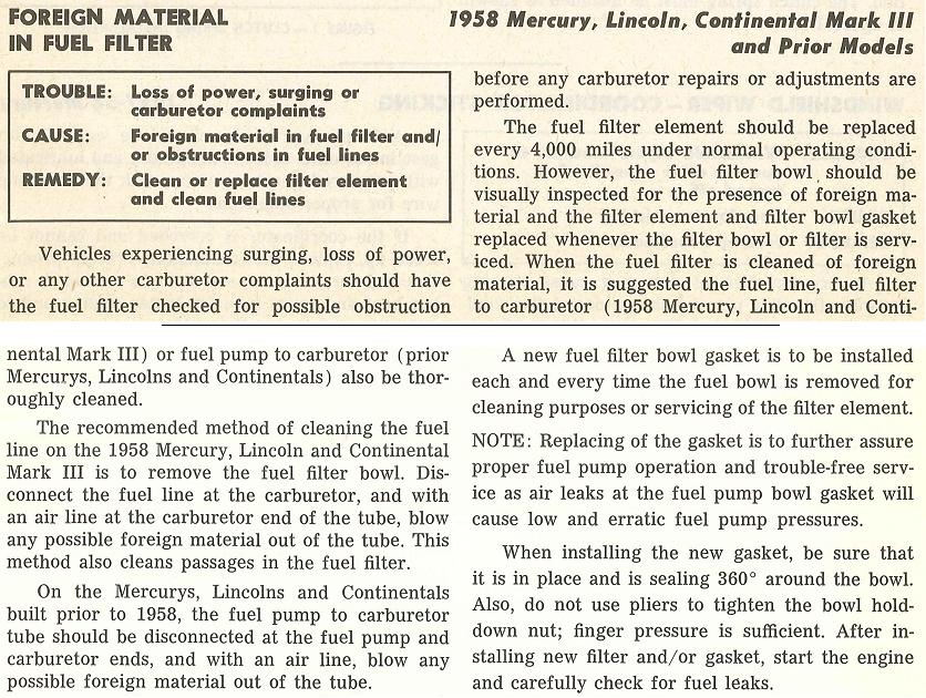

Here's an article that sheds light on the detonation issue- Ford designed the engine with 98 octane in mind, but the petroleum industry was slow to release that. The article also has theory behind the axle ratios found in the 1958 Merc/Linc.
On the topic of fuel pumps and fuel filters...
It would appear, according to the service bulletin below, that Mercury, Lincoln, and Continental built before 1958 were not equipped with a fuel filter between the fuel pump and carburetor. I'm still trying to confirm this and would appreciate input from others on this topic.
#31 5-16-58

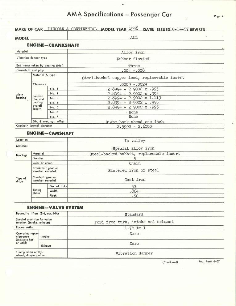

The Sept 1957 advance service manual for Lincoln discusses overhaul of the fuel pump and removal of the fuel filter but oddly shows no pictures of either one except for on a rendition of the assembled engine. Below is a copy of the AMA specs for the 1958 Lincoln (dated 10/14/1957) which references use of a fuel filter, so perhaps it was being placed into production in late Fall of 1957.
10-14-57

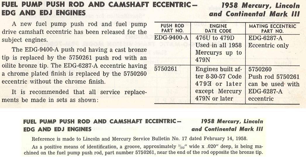

Finally, here's another bulletin documenting changes to the fuel pump push rod. Production changed from a bronze bushing to an oil-lite bushing. The eccentric was also changed.
#17 2-14-58

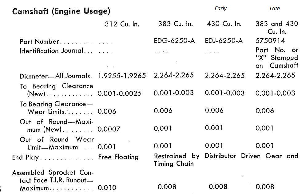

One of the earliest internal changes to the 430, other than the distributor which was re-curved around or just prior to 11-1-57, appears to be the camshaft. The 1958 service manual references the EDJ-6250-A cam as being used from 9-10-57 through 11-10-57.
I have no reference for what, if anything, was used prior to 9-10-57. Based on the old ads at the following link, the cars (Lincoln) were formally introduced to the public on 11-1-1957 http://www.plan59.com/tearsheets/news_index.htm so it would seem that engine production might have only started in September 1957.
1958 Service Manual- early cam
Early valve springs are brown or maroon colored.
Here are the early 1958 cam specs. First, from the Mercury Advance Service Manual for 1958:

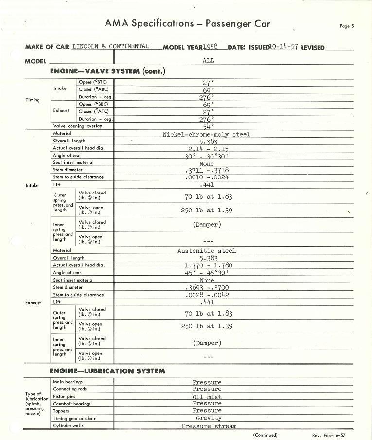

And from the 1958 AMA Specs pages for Lincoln
10-57 AMA (Lincoln)
10-57 AMA (Lincoln)
Intake duration= 276 degrees
Exhaust duration = 276 degrees
Overlap = 54 degrees
Later style cam and valve spring usage from 11-11-57 onward:

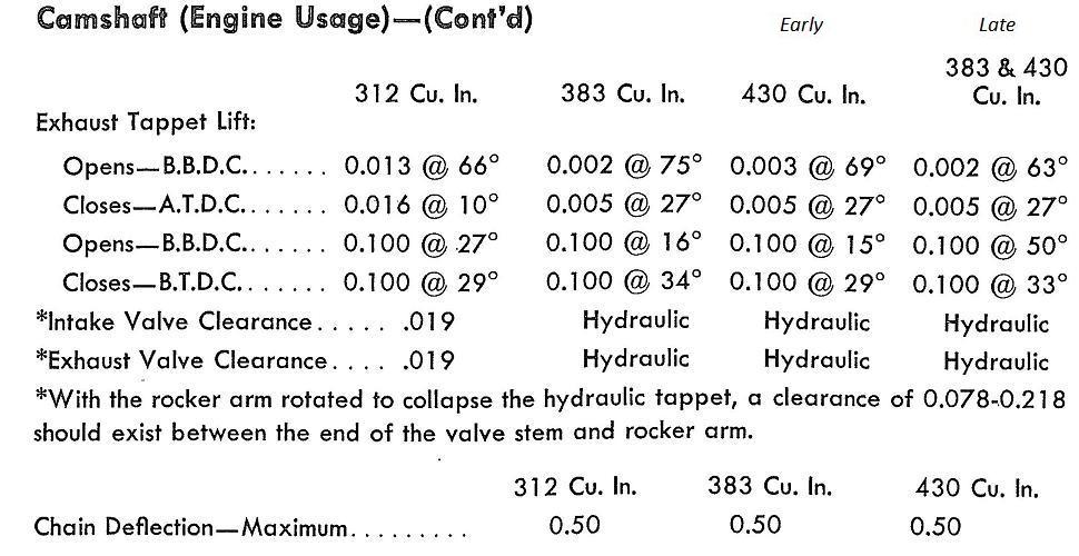

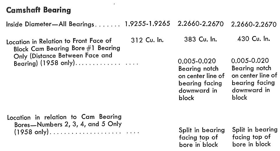

Cam specs for the later style 11-11-57 onward, which changed to:
Intake duration= 270 degrees
Exhaust duration= 270 degrees
Overlap= 49 degrees
1958 RM Service Specs
Note revisions from the 1958 Merc Advance Service Manual which stated the following for the Early 430:
Intake Open BTDC = 0.002 @ 27 degrees... Changed to 0.003
Intake Open ATDC = 0.100 @ 26 degrees... Changed to 27 degrees
Intake Closes ABDC = 0.100 @ 12 degrees... Changed to 13 degrees
Exhaust Closes ATDC = 0.004 @ 27 degrees... Changed to 0.005
Exhaust Open BBDC = 0.100 @ 16 degrees... Changed to 15 degrees
Exhaust Closes BTDC = 0.100 @ 34 degrees... Changed to 29 degrees
1958 Lincoln Service Manual
1958 cam changes final.JPG (55.62 KiB) Viewed 70404 times

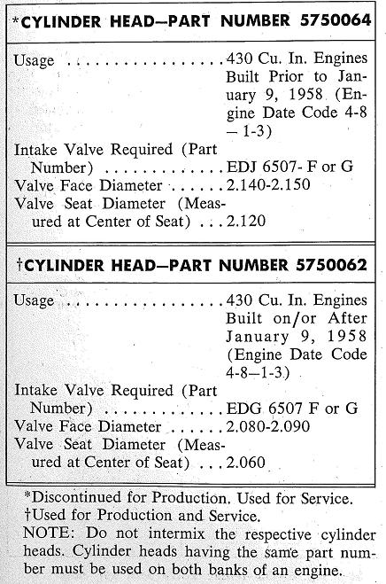

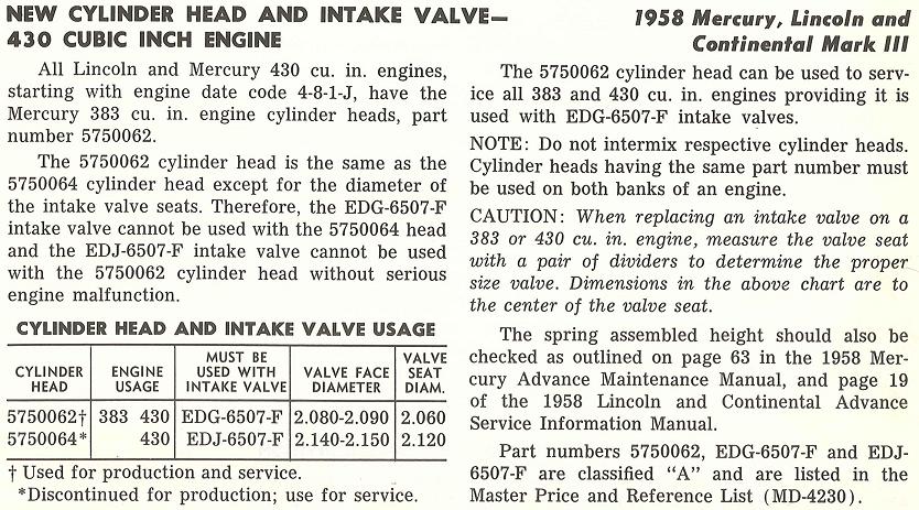

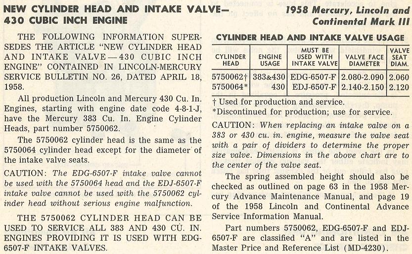

Head change as of 1/9/1958
Continuing with attempts to resolve valvetrain issues, a new head was introduced for 430 production on 1/9/1958 (according to the 1958 Registered Mechanic LMC Specs Handbook, the date of introduction is revised to 1/20/1958). The new head is reported as the Mercury 383 head #5750062 and basically reduced the intake valve diameter from:
intake valve head diameter: 2.140-2.150 .... to 2.080-2.090
intake valve seat diameter: 2.120 .... to 2.060 Seat angle stayed at 30 degrees
The theory I've heard on this is that the larger valves collected more deposits from low quality gas/ customers who did not drive regularly or at particularly higher speeds.
*There were no changes made to the exhaust valves- they were same for 383 and 430.
exhaust valve head diameter 1.770-1.780
Seat angle: 45 degrees and stayed at 45 degrees.
*Note: There were no changes made to the intake valve seat angle at this time, but they were changed to 45 degrees later in 1959 (see 2nd to last article).

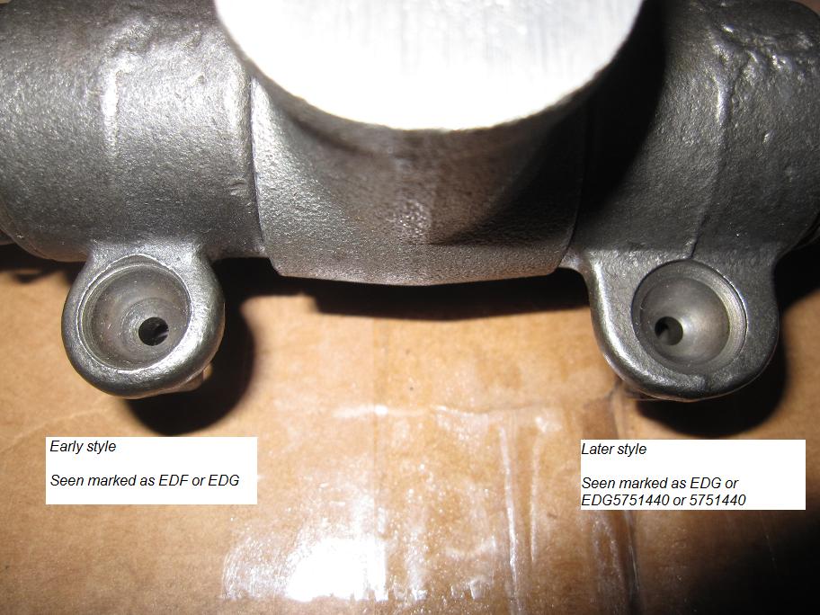

From my limited observation, MEL cylinder head part numbering changed every year from 58-60. I've been trying to make sense of this for some time, especially as it relates to the early MELs and inconsistent numbers.
Early 1958
Literature refers to the early head as part number 5750064, however I have not seen this number on a head. The literature is likely off and meaning to reference 5750065 based on the real life examples I've seen below.
5750065 78D (August 4, 1957)
EDJ-6090-B 78P (August 15, 1957)
EDG-6090-C 78V (August 21, 1957)
The early head casting numbers, including the 5750065, have not been externally visible as they are cast on the top of the head under the rocker shaft assemblies. I believe the EDJ-6090 numbers were the earliest identifiers used, followed by introduction of the 575- numbering convention. 575 part numbers show up on replacement parts in the Service Bulletins throughout 1958.

Literature refers to 5750062 as the replacement head (Merc 383) used on the 430 from 1/9/1958 onward. It had slightly smaller intake valves than the early 1958 heads. Again, I have never seen this number on a head. Every Lincoln I have seen that was built in 1958, including 3 that I own, have a 5750063 casting number that is external and located by the spark plugs on the left hand side of the head.
The Service Bulletin #29 (5-9-58) that describes the Super Marauder option for 1958 has several pictures of the Mercury 430 engine, and in one of them I can read the 5750063 head number. I'll post it if I can get a good scan of it. This head is consistent with what a Mercury Super Marauder engine would have installed because the 3x2 option was reportedly released for production in April 1958 and the head was already in production at that time. What could be found on a Lincoln Super Marauder is another story and I will cover later on as I get to it.

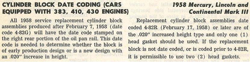

One of the final significant differences between an early 1958 and later 1958 is the compression ratio which was lowered from 10.5 to 10.0 starting on and including 2-17-58. This was accomplished by increasing block height 0.020" as a final effort to prevent detonation issues. Notice the alternative fix for early 430s was to use 2 head gaskets to reduce the compression ratio. The higher compression makes the earlier blocks and engines somewhat more desireable.
So to recap, all of these changes result in 3 variations of the 430:
1-High 10.5:1 compression, large 2.140" intake valves- from mid-1957 to 1/8/1958
2-High 10.5:1 compression, smaller 2.080" intake valves- from 1/9/1958 to 2/16/1958
3-Lower 10.0:1 compression, smaller 2.080" intake valves- from 2/17/1958 onward.
As noted earlier, the Super Marauder option was introduced around April 1958 and would have been equipped on engine variation #3 which was rated at 400HP and approx. 500 ft-lbs. It would be interesting what it would do behind door #1.

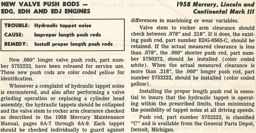

Push rod change to cure noisy lifters

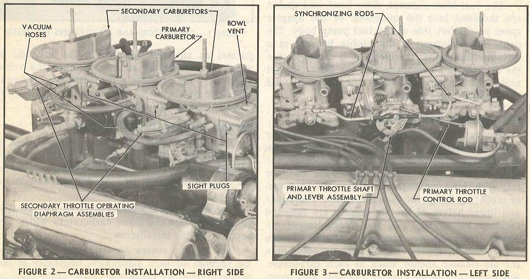

This is a treat to behold- pics of factory installation for the 3x2 Super Marauder, but I direct your attention to the valve covers which are well-illustrated here. Thanks to Mr. Kraft for pointing out the difference between 1958 valve covers from 1959 and onward... 1958 has the "fingers" affixed to the cover to hold the spark plug wires, and note the small grommets on the spark plug wires too. 1959 and on uses a removable clip to secure the wires to the valve cover.
1958 Valve Covers
