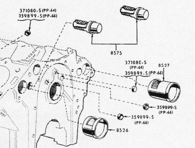

The illustration on lincoln land shows installing them with the opening aiming straight up, this is correct?

This is late but very important. The diverters must be installed as per the manual illustration (there will be an open coolant passage directly above that feeds the head(s)). This ensures constant coolant flow to the cylinder heads and intake manifold. The openings left by the removal of the block thermostats directs coolant flow directly to and around the cylinder barrels, thereby negating the needed flow to the cylinder heads.
This is a very specialized design and must not be compromised.

that's what I figured once I pulled the cylinder heads off and saw the openings. I was guessing the diverters should be angled towards the heads so the water flow is directly aimed at the cylinder head openings. that sound about right? 8-)

Good info as mine need replaced too... try http://www.ebay.com/itm/140708923097?ss ... 1423.l2649 $45 for the pair in aluminum. Here is a photo of mine. I did not remove them yet to see exactly what angle, if any, that the openings are on. I can take a good photo before I remove with the flash on and see. Looks to be straight up in the drawing KULTULZ posted.
