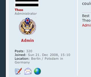

You can write your address into your profile if you wish.
Then people can see that you have a web site the way it displays like the globe in this picture. It can be clicked to go there. Pretty convenient.
