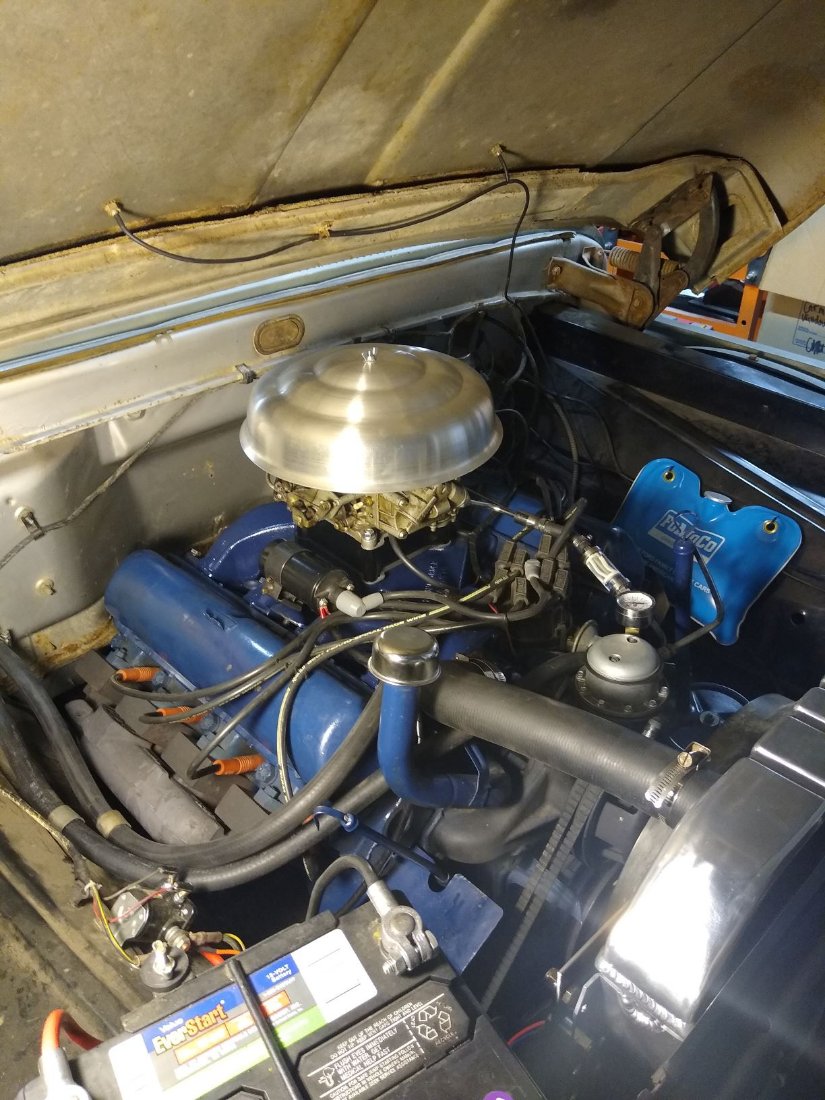

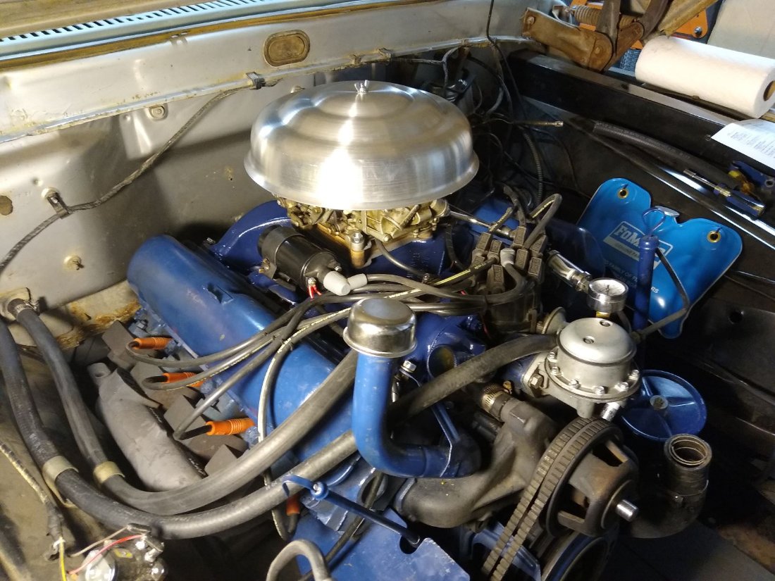

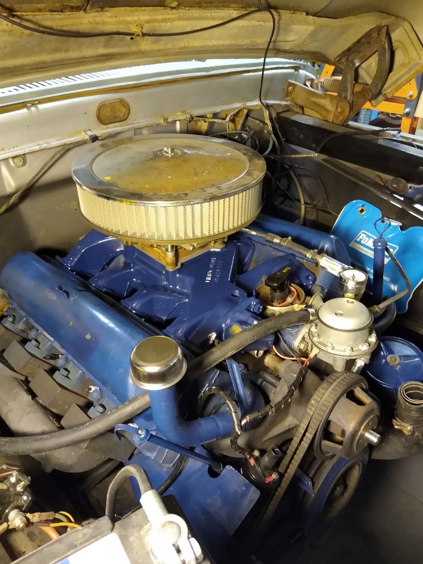

After living with this swap for a couple weeks (had unplanned downtime to replace a clogged radiator), I can say it's worth the effort if you have the hood clearance. Torque and throttle response are noticeably improved all through the rpm range. Here are a couple fitment differences I encountered:
- The heater hose connection moves from the back to the front of the manifold which worked to my advantage because that's how the original FE motor was plumbed.
- The water temp sensor moves from the front to the back of the manifold and is 1/4" NPT instead of 1/8" NPT. Not an issue in my case because the stock wire still fits and it takes the same replacement sensor as the FE.
- Not only does the carburetor mounting pad move up about 1.25", it also moves forward roughly 1". This could cause issues with linkages and the fuel line and in my case I ended up having to make a new throttle cable bracket.
- The manifold spreader thingy's that the bolts pass through to clamp it to the cylinder head are different sizes. I didn't get the ones off the '58 and the '64s are shorter. About three fit well enough to torque to spec, the rest I welded a bead on one end to make them longer. See pic below. Not my favorite solution but functional since I may never come across the correct parts.
Now pics!
First here's the new intake with the 2" spacer that was on the original manifold.
Here it is setup with the 1" open spacer I originally planned on running—still waiting on the new radiator here. The open spacer ended up being all top end power and caused soggy throttle response on the low end. The swanky new air cleaner has a flat base for reference. The crusty old chrome air cleaner was about a 1" drop base.
Here it is with the 2" four-hole spacer back on it. This is a tall setup (the air cleaner is about 3" high) so it's getting close to the underside of the hood now. This setup has instantaneous throttle response at any rpm, great power everywhere, and I can loaf it down to about 10 mph in high gear. With the old intake setup, 15-20 mph was about as slow as you could go in high gear before it fell on its face. Not that that's important, but it is indicative of the improved efficiency of this setup in my opinion. It's a blast to drive now, merging is fun but it's very easy to overspeed. I'm sure I've surprised a few people with how quickly this beat up old truck pulls away from them now.
