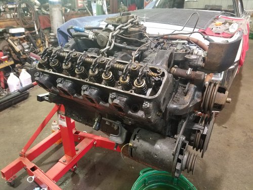

Post by spectramal » Tue 16. Apr 2019, 19:43
Here she is in all her beauty!
Re: New guy here with a 62 430 rebuild!
Post by Chris430 » Tue 16. Apr 2019, 20:46
Hello,
I have seen a set of Egge pistons that came out of a noisy Edsel 410. They had the correct step but no pin offset. Being heavy on one side was causing them to rattle. As far as I know Wiesco is the only one that has the correct $1100 set of custom pistons. I bought a running 65 430 for this reason. The 59 430 still sits waiting the expense for me to do it right. Pretty sure I have an extra 63-65 low profile/large port four barrel intake if your looking for one.
If you find a set of NOS MEL pistons make sure they are specifically for the 58-62 430. The 63-65 430s have a small combustion chamber in the head and the piston step is slightly larger.
