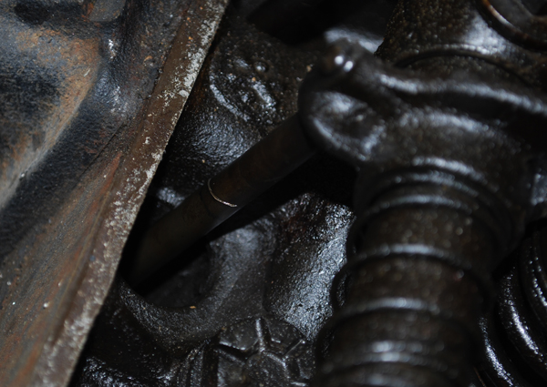

KULTULZ wrote:The MEL has the same basic valvetrain as the FE, so what applies there also applies here.Dan Szwarc wrote:The valve stuck and the cam bent the pushrod. Replace the pushrod (or all of them) and get a valve job.PinkLinc wrote:
That's not bad. I assume I'm going to need a shop crane to get the heads out? What do you suppose caused that pushrod to bend and crack like it did?
Gary, what is your advice on replacing pushrods?

Most no one follows this logic. Whenever any work is done having to remove the heads, one must follow this procedure (more detailed in shop manual) to ascertain proper valve lash. On an engine this old, one should also disassemble the rocker arm assemblies and make sure all parts are good and has a good oil supply.
It may not need a valve job. That is ascertained via a compression and leakdown test(s). The seals can be replaced on the engine. Valve guide wear can be determined on the engine. Weak lifters can be determined on the engine.
It is possible that after a prolonged shutdown, the valve stem may have frozen in the guide and the resultant start-up could have caused the damage. More than likely though, it is this malady that is common to both engine series.

I can't tell from the conversation, is this an intake or exhaust that bent and cracked?
